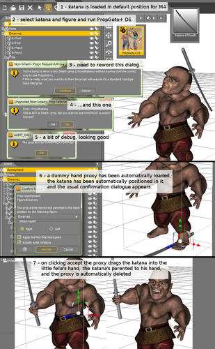

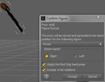

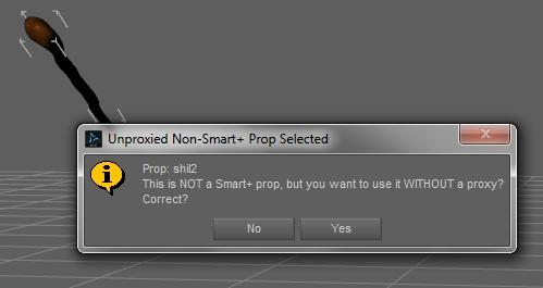

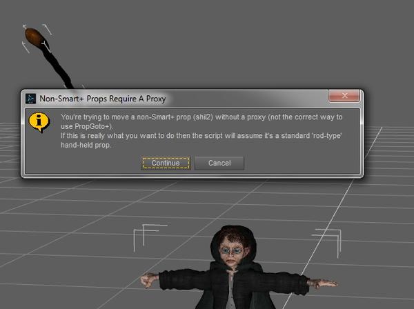

    Errrr... that's not the shilleliegh that I've included data for...

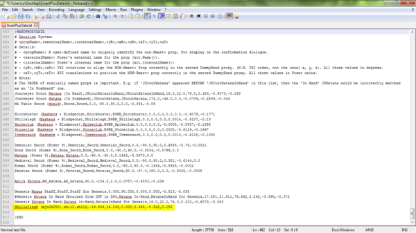

    However, it's a good opportunity to test the updated DAZ Studio helper scripts! I just downloaded the shilleliegh, loaded it into DS4.6 and ran the updated helper scripts. Here's the data I got (the URL was added by hand of course):
    # http://www.sharecg.com/v/80369/browse/21/DAZ-Studio/Shilleliegh
    Shilleliegh (mjc26250),shil2,shil2,-16.804,16.143,0.000,0.345,-0.522,0.150
    I added that to my Smart+ datafile... and here's a little fella holding it, courtesy of PropGoto+...

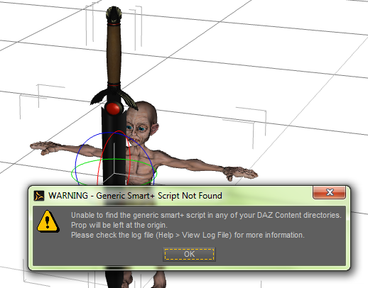

    (also tried adding data for the lightsaber you see, but that doesn't get recognized - need to look into that...)
    891 x 657 - 105K
    Post edited by 3dcheapskate on

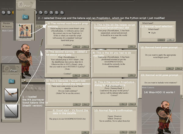

  • 3dcheapskate3dcheapskate Posts: 2,732
    ...then loaded GG3.1, selected her and the shilleliegh, ran PropGoto+, and it's hers now...
    It really is that easy !
    502 x 735 - 97K

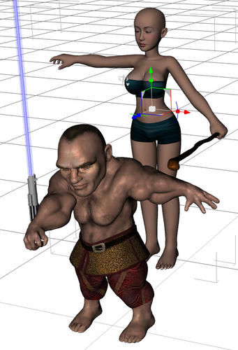

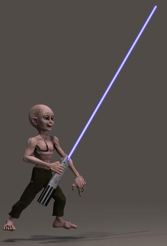

    The lightsaber works fine in the Poser version, so there's only a problem in the DAZ Studio version. Here's the link and data for the freebie lightsaber I used if anybody wants to try it in Poser...
    # http://www.sharecg.com/v/33085/browse/11/Poser/ESB-SKYWALKER-Gunbelt-DL-44-Blaster-Lightsaber
    Lightsaber (fantascopefilms),saberhandle,saberhandle,0.000,90.000,180.000,-0.001,-0.198,0.000
    ...and here's Jedi Master Scrum, again I just selected the prop and figure and ran PropGoto+ to get it gripped in his hand
    517 x 758 - 29K

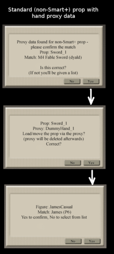

    Helpers For Generic DS Smart+/PropGoto+ Rel3Beta Now Uploaded Too
    ShareCG: Helpers For Generic DS Smart+/PropGoto+ Rel3Beta
    Renderosity: not yet
    These will let you easily get the data you need to add additional props to the Smart+ datafile.
    Remember that it's a beta - there's not much explanation in the readme, but if I've done it right it should be fairly easy to follow...

    Returning to that problem I had with the lightsaber. It works in Poser and DS3, but not in DS4. I thought this might happen (I think I mentioned it in an earlier post?)
    If I simply run the '5-GetProxyData' script from Poser I get this:
    :HANDPROXYDATA
    ,saberhandle_1,saberhandle,81.0,0.0,0.0,0.0,0.1163,0.0
    From DS3 I get this:
    :HANDPROXYDATA
    {propName},saberhandle_1,saberhandle,81.000,0.000,0.000,0.000,0.116,0.000
    But from DS4 I get this:
    :HANDPROXYDATA
    {propName},saberhandle_1,ESB Skywalker Lightsaber_19135,81.000,0.000,0.000,0.000,0.116,0.000
    Iirc - when DS4 imports a Poser prop which has no external geometry (i.e. if the geometry is included in the CR2, and not in an external OBJ), then the internal name it gives the prop is the name of the CR2 with a number tagged onto the end. Poser and DS3 use the internal name that's specified in the CR2.
    Like I said, I was sort-of expecting something like this. I don't think it's a big problem - just needs a bit more thought....

    I gave the DS version 3 beta a very brief test and managed to load the spiked club from Bashers and Bludgeons into g2f's hand quite easily. That's in the latest DS 4.7 release. Didn't try it in the 4.8 public beta yet. It worked :) I was very impressed that even the hand pose was correct.
    The helper scripts look very interesting and hopefully I will have time to try it out soon. I don't use old figures much, almost exclusively Gn 1 or 2 figures, so my interest is mainly in using older (or new!) props that are for gen4 or earlier which don't play well with Genesis 1 or 2. I once spent over an hour getting a katana and sheath into the hands of a g2f character and it was an extremely frustrating experience. It is really a pain to try dragging a prop into a characters hand when it loads rotated and positioned for for another character!

    Just a quick reply to let you know that the Helper and Goto scripts work fine in DS 4.8 beta.

    Currently generating support data for a couple of extra figures - Genesis 2 Male, Dusk done so far and added to the list
    Also noticed a problem with the DS 'GetGotoAndGrip.dsa' script from release 1 and 2 - it doesn't work, always crashes. Need to comment out lines 68-73 to avoid crash. To be fixed for proper release 3.

  • MilosGulanMilosGulan Posts: 1,993
    edited April 2015
    That is good to hear. I have installed Scrum and tried to use Shilleliegh with him.
    First I made folder for this script V2 on my external HD then I installed (unziped) it to the folder then I copied V3 beta files over it. Then I tried to run script as instructed here, but it says - Unable to find the generic smart+ script in any of Your DAZ directories. Prop will be left at origin.
    I am not sure what to do, if I installed it good at first place then how to make it work. I have tried reading a bit of pdfs but now i don't have much time to read it all now as I am in busy period of year.
    It would be great if I could make it work.
    Post edited by MilosGulan on

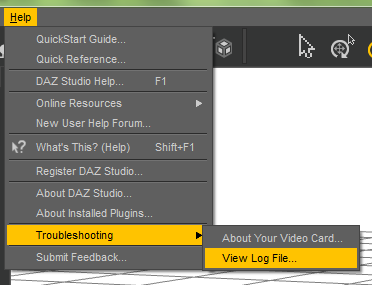

    edited April 2015
    Simple answer - the main script 'GenericPropGotoPlus.dsa' isn't in one of your mapped DAZ Studio Content folders.
    The dialog should also say "Check the log file (Help > View Log File) for more information" as per the first screenshot (In DS4 it's actually Help > Troubleshooting > View Log File, but I did that dialogue when I only had DS3 ! :)
    Open the log file (as per the second screenshot - I'm using DS4.6) and scroll to the bottom (it could be quite big). You should see something like the third screenshot, but your directories will be different, and you'llprobably only have one or two.
    You need to make sure that the 'GenericPropGotoPlus.dsa' file is in one of the locations listed in the log file - those are the only place the script knows to look.
    If you can't work it out and fix it from that, then post the equivalent lines from your log file, plus the full path to the location where you put the script. We'll get it sorted ! :)
    1224 x 246 - 47K
    372 x 285 - 18K
    518 x 406 - 70K
    edited April 2015

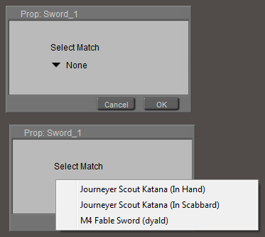

    Thanks for quick answer. I have made new folder scripts/3DCheapskate/SmartPlus/ and copied there all files from SmartPlus folder.
    It started working but here is what happened, I have clicked 1 Continue, 2 Yes (and No), 3 Accept result is in both cases like on Pic 4. I hope we can make it work. I am missing that first screen in this thread instructions 1st picture when it matches prop.
    566 x 483 - 64K
    401 x 316 - 54K
    499 x 265 - 44K
    620 x 463 - 91K
    edited April 2015
    The first message "You're trying to move a non-Smart prop..." indicates that the script failed to match the prop you've selected. It also tells you the internal name of the prop you've selected - in this case it's 'shil2'. If you open the datafile ( /scripts/3DCheapskate/SmartPlus/SmartPlusData.txt ) and scroll down to the bottom (the HANDPROXYDATA section is the last section) you'll find that you haven't added the data for mjc's shilleliegh (the dataline for mjc's shilleliegh is in post 61 - it wasn't included in the release 3 beta datafile).
    The first attached screenshot shows the end of the release 3 beta datafile - no mjc shilleliegh.
    You simply need to copy the dataline from post 61 (no need to include the preceding comment line with the URL - comment lines start with # in the datafile) and paste it somewhere in the HANDPROXYDATA section (i.e. after the ":HANDPROXYDATA" line but before the ":END" line. See the second screenshot - I usually add new props at the end unless there are possible mismatch issues, which doesn't apply in this case.
    Hope that helps. Once again, post back here if you have any more problems. (Note - this is a very useful exercise for me! I'm so familiar with all of this, I forget that it may not be so obvious to other people. It's a good reminder that I need to rethink the documentation. Maybe add a 'Quick Start' guide with a few screenshots - a picture speaks a thousand words! :)

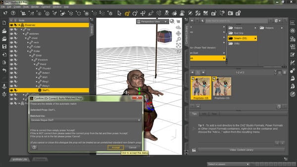

    The Smart+ stuff was originally designed to work specifically with Smart+ props (i.e. props where the geometry and PP2 or DUF have been created in accordance with a few rules - resulting in props that load with their origin at the world origin, positioned at the origin, and aligned with the world axes.
    If a prop is NOT set up like this, then when you use the Smart+ stuff the prop will appear in completely the wrong place (which is what you saw with the mjc shilleliegh).
    The 'DummyHand proxy' procedure in release 1 and 2 was a first attempt to make the Smart+ stuff work* with all those other props. I realized that you could rotate/translate any prop so that it was positioned and oriented in the correct way for a Smart+ prop - but it's origin would then not usually be at the world origin, and its axes would not usually be aligned with the world axes. If I ran PropGoto+ on it the prop ended up in the wrong place. But if I parented it to a DummyHand proxy (which is a proper Smart+ prop), and then ran propGoto+ on the DummyHand proxy - the original prop ended up in the correct place. All I then had to do was parent it to the figure's hand and delete the proxy, which had served its purpose.
    Release 3 beta is because I suddenly realized how easy it was to automate the DummyHand proxy procedure...
    (*There were one or two ordinary props, can't recall what they were though, that were just by chance set up like Smart+ props. These worked fine with PropGoto+, even without a proxy. That's the reason why it's still possible to run propGoto+ on a non-Smart+ prop without a proxy. I think I should probably modify those dialogues a bit? )
