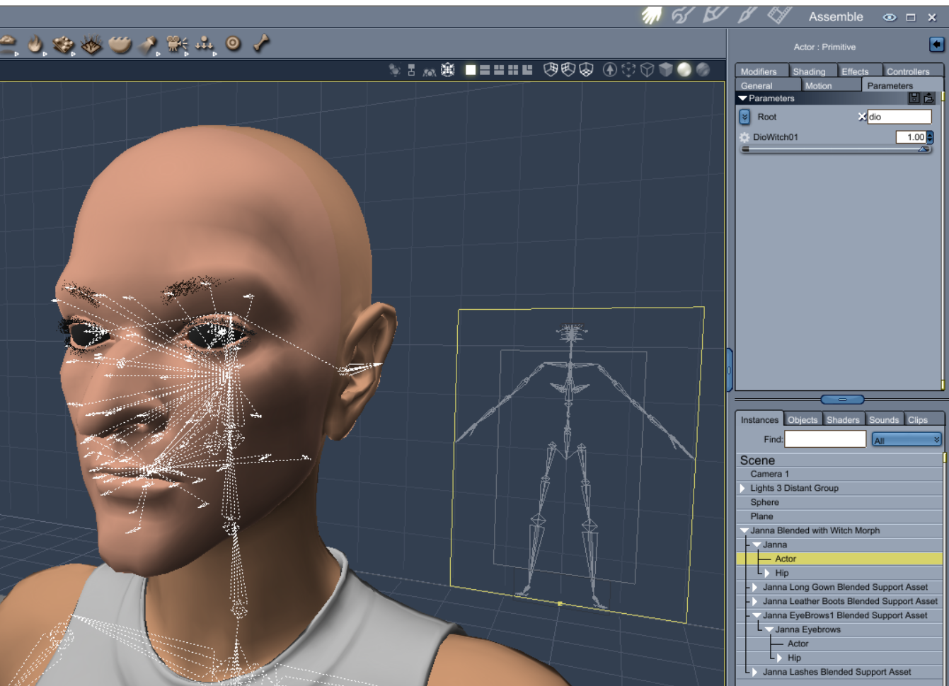

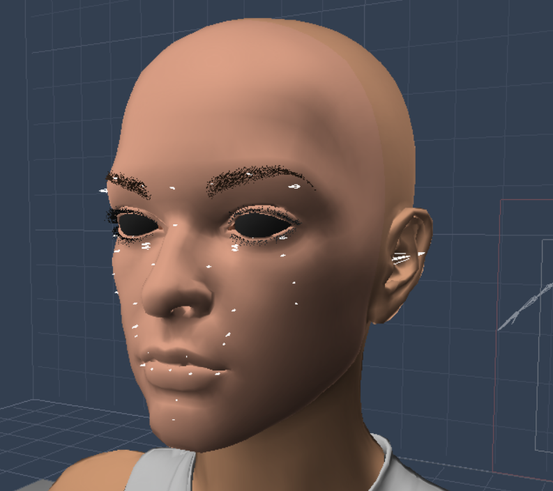

Having problems with workflow to get Janna's brows to follow a custom morph for Janna's face.
1) Converted Janna to blended and saved as support asset
2) Converted brows to blended and saved as support asset
3) Used modeler to make a morph for blended Janna  (saved morph as asset and then saved morphed figure as support asset)
4) Loaded blended Janna with face morph in Carrara but morph dialed to 0
5) Loaded blended brows for Janna.  Used FIT TO on brows for Janna blended
6) Dialed Janna blended face morph to 1.  Brows did not follow a projected morph
Janna blended and brows blended default shape and fit to
Janna blended with custom face morph dialed to 1.  See outside halves of brows disappear.

    In order for your new morph to work with brows you can do the following steps.
    Fit the brows in DS, dial up your morph with brows on.
    Turn of Janna's visibility in scene pane.
    Export the brows to obj in base resolution.
    Load the new brows in empty scene, load your obj as a morph.
    Save your brow morph to the brows folder.
    Then you would be able to apply your morph to fit Janns's new form after fitting them in Carrara.
    BTW, nice witchy morph.

    Veronika - thanks.  I wonder if the morph I created wasn't saved to the correct data location by morph loader.  In any case, should be able to address.  And thanks for the kind comment about the witch face.  I should note that the brow follows my facial morph in Studio, but not Carrara.  Maybe I needed to save the blended fiber mesh brows as a wearable preset instead of new support asset?
    Misty - yes, Janna has some facial bones, including for the brows.  Have to fix my morph load before I can test the facial bones, though.
  • VyusurVyusur Posts: 2,235
    Ted, of course, the brows have to be blended version with morphs. It's up to you to save morph separately or the whole figure with morph. Honestly I use scene subset save option pretty rare. Usually I save the figure as support asset.
