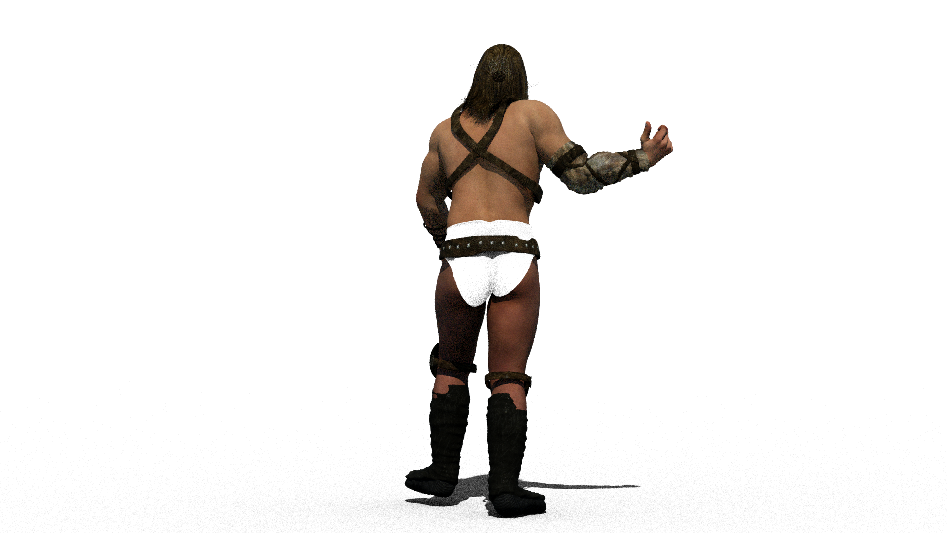

    I tested on the scene I am rendering in Carrara with the Octane plugin
    no help to you I know but shows the principle involved
    he is wearing briefs and nothing is hidden under his briefs but applying my matte shader I have also on the infinite plane below indeed makes his underwear an alpha
