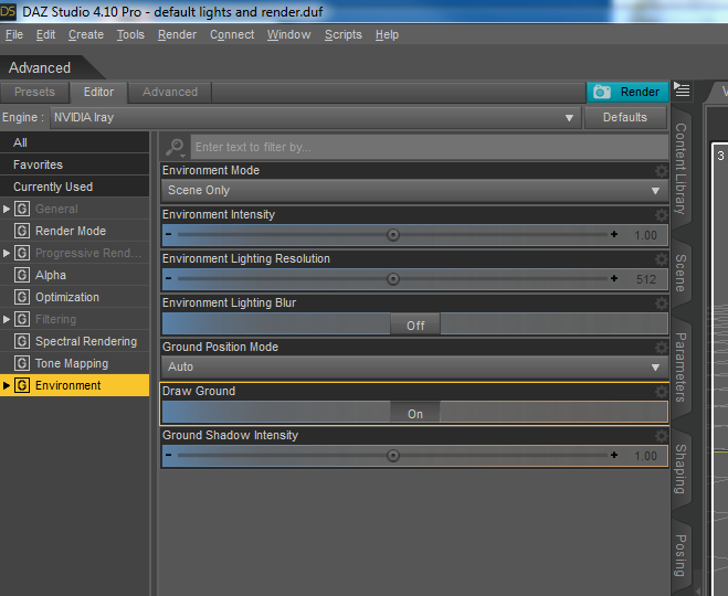

    @cheznous2029_28ab1adedc "Before you say, "Turn on ground shadows in Render settings...", I am not rendering with a dome! I have a background image and my Character in the foreground, No Dome!"
    You can still Draw Ground in Scene Only Environment mode. You also don't need to go through all of your steps to get shadows in Iray, just Draw Ground, or use a primitive plane, or use an HDRI. You can use an HDRI for lighting and still use a background image by turning off Draw Dome. You are making this much harder than necessary.
    Second image has Dome and Scene, Draw Dome: Off, Draw Ground: On, one spotlight.
    659 x 540 - 67K
    750 x 500 - 176K
    Post edited by fastbike1 on
