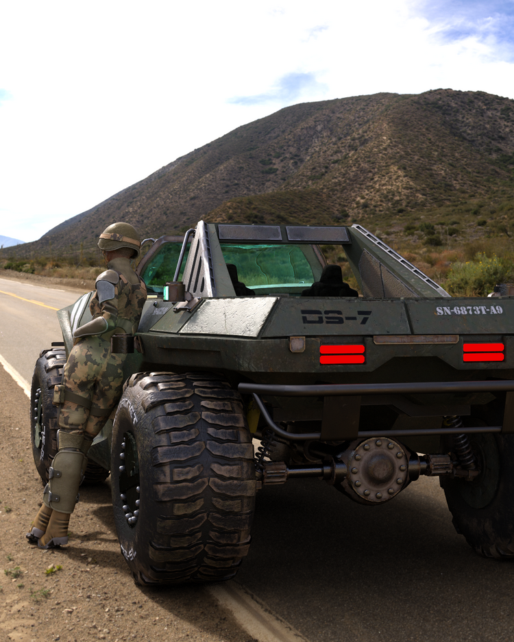

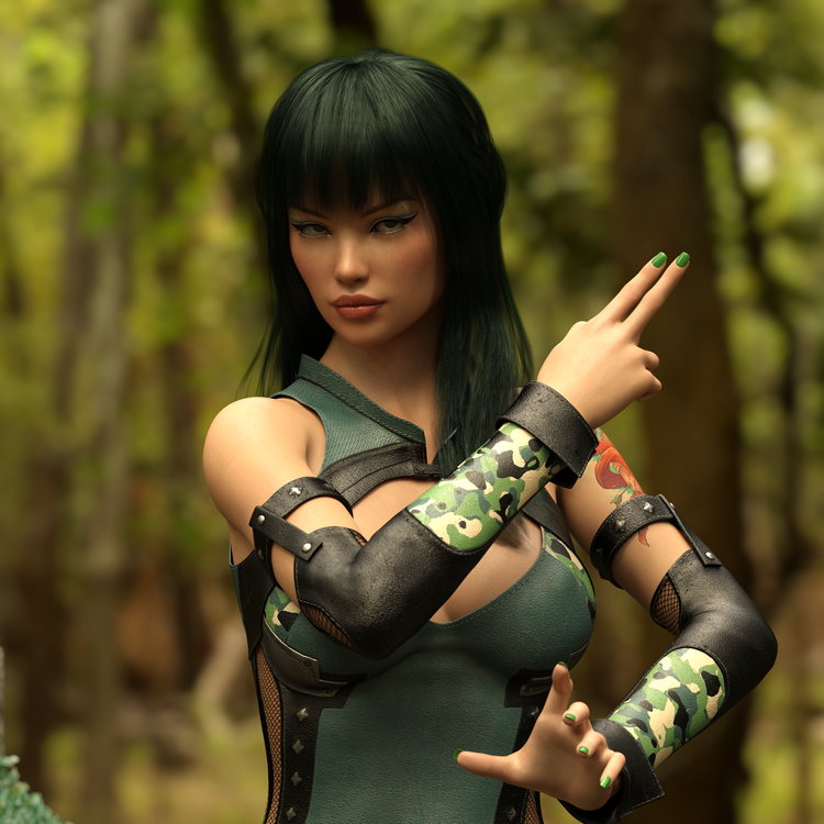

    Render quality 30 is way too high. That's not your problem. Proper lighting with render quality 1 will give great results.
    Attached all with render quality 1
    750 x 938 - 1M
    750 x 750 - 1M

  • Thanks everyone for your input - am trying your suggestions and looking good so far, have dropped quality down adjusted tone mapping, firefly filter was already on. Have changed maximum samples, and have been playing around with the tone mapping. Still can't get the quality that fastbike1 gets - not sharp, very grainy. Will post result when done later today. Shadow areas very grainy.
