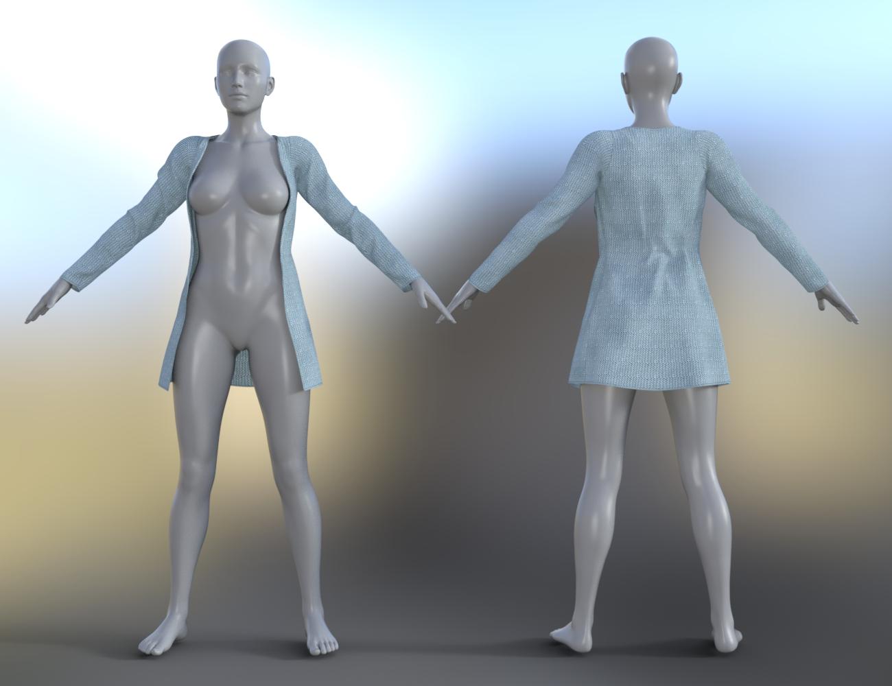

    Hello, I can't find a thread on the Mirror Geometry for G8F, so I'll ask for help here.
    Mirror Geometry doesn't seem to play well with the clothing converter for G3F to G8F.  When I try to mirror a converted item, it goes through all the steps, but the resulting item isn't really mirrored. This is an esha clothing item, so since the Mirror Geometry has her name on it, maybe she can help.
    I used Casual Tourist for Genesis 3 Female(s). I converted the individual wardrobe and accessory assets with Clothing Converter from Genesis 3 Female to Genesis 8 Female. It worked great!. Then I mirrored the Jacket with Mirror Geometry. When it finished, I loaded the mirrored jacket on G8F, but it was not mirrored. Instead, the hips were flared out.
    Here is the converted jacket on G8F
    Here is the mirrored converted jacket on G8F
    1300 x 1000 - 399K
    1300 x 1000 - 402K

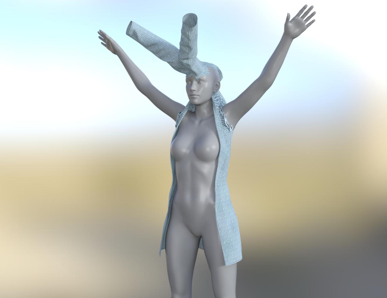

    Oh dear, it gets even worse if I pose Genesis 8. Here I used pose control Arms Up on G8F. This is what happened to the mirrored jacket.
    1300 x 1000 - 319K
    Post edited by barbult on
    I will ask esha and get back to you.
    Thanks, I'm curious about whether you can reproduce the same result. I tried a couple other converted items and had similar unexpected results. I am using DS 4.12.1 76 Public Beta, in case that matters.
  • eshaesha Posts: 3,261
    Hello barbult!
    This is weird and I don't know why it is happening, but for some reason it doesn't mirror converted items well. But it works fine if you mirror the item for G3 first and convert the mirrored item to G8 afterwards. So it seems to be a matter of doing things in a specific order.

    @esha @RiverSoftArt I overcame the problems with Mirror Geometry after using the G3 to G8 converter by performing Transfer Rigging (Figure Space) on the mirrored item and resaving it. I tried this successfully with the Casual Tourist Jacket and an asymmetrical I13 shirt. (The final item still has the issue of the shoulder and arms not fitting perfectly, especially when raised, but that is a conversion issue, not a mirror issue, I believe. The non-mirrored conversion has the same shoulder/arm problem. Autofit has the same shoulder/arm problem.)
    1300 x 1000 - 323K
    Yes, the shoulder/arm problem is a conversion problem. G8 has her arms in A pose, not in T pose like G3, so the fabric gets crunched up in the armpits and the weight transfer doesn't work as it should.
