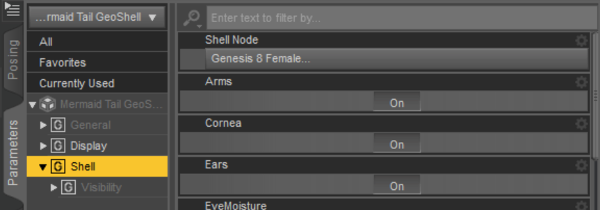

    11. Finally select the tail geoshell, parent it to G8F and check that the `Shell Node` is set to G8F, which will then also cover the tail like the G3F version.

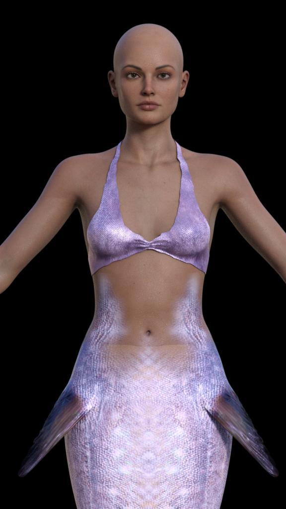

    At this point you can select G8F and add a default h.material preset from the G3F material options, before saving the tail as a wearable preset to a folder of your choice. Here's my version on BlueJaunte's Amira:
    1800 x 1796 - 3M

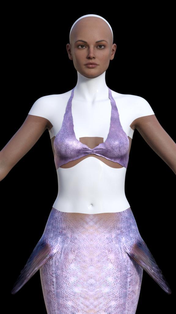

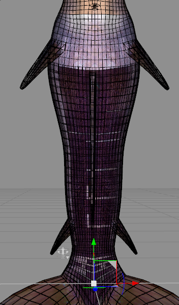

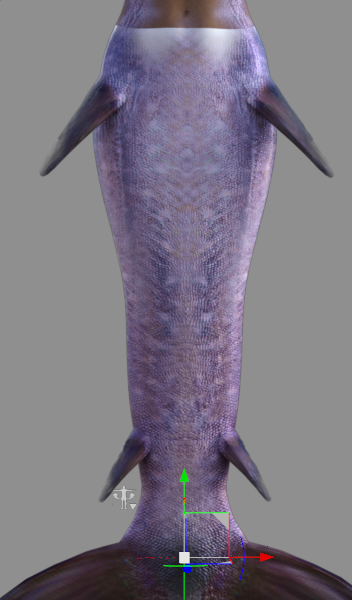

    I started looking at this, out of interest, and ... got screwed on step 1 (despite having the products in question!0 as, so far as I can see, there is no tail, just a geoshell - help!

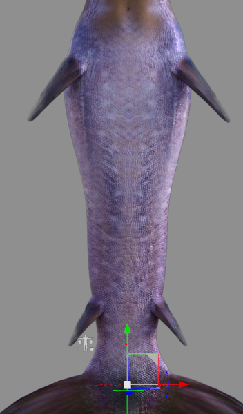

    I think changing the view to wired will let you see it.
  • Silas3DSilas3D Posts: 835
    The thing to bear in mind with the tail is that most of its opacity is set to 0 which is why you can't see it in textured mode, because its only a small part of the abdomen that is used that your figure's torso texture is copied to. The tail texture is all on the geoshell.

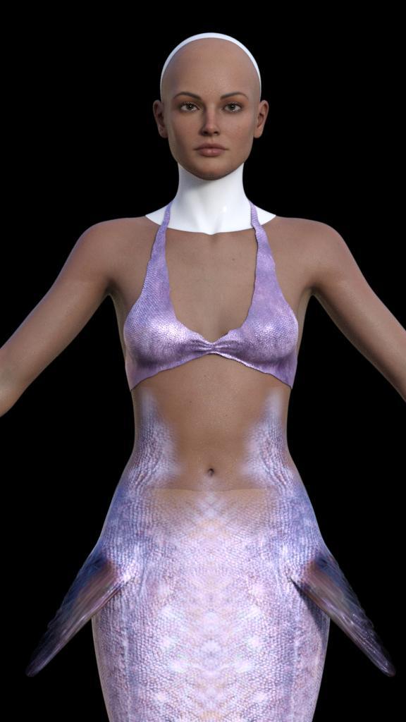

    In the geoshell I had to turn off a bunch of things, ie eyes arms etc or the human part was white.
    Also dont forget to go back to high resolution or if you do a iray render preview in daz the whole character will be white.
