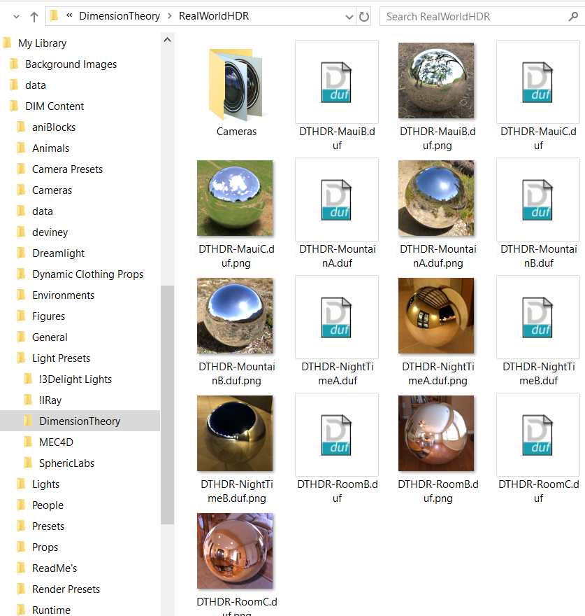

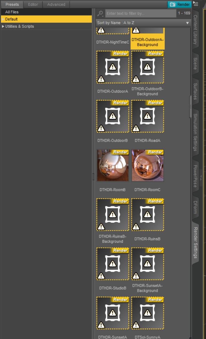

    I've noticed recently (with both 4.11 and 4.12 Beta) that my previously saved presets are not recognised correctly in the Render tab. I've had this beofre where DAZ Studio, for some reason, can't find the icons for these presets but I can't remember how to fix it.  I don't believe that the icons have moved from their original location in the Content folder.

  • It's not just the icons that are missing (central !), the files themselves are missing (! at lower left). Either the fles have been moved or their content directory s no longer selected as a current content directory. What s the path to the actual files on disc, and what are your content directories?

    They are still in the folders where DIM installed them. The odd thing is that a couple of them are recognised but the rest aren't (in this example). The screenshots are not big enough to show all my presets but there are many more where it shows a couple but not the rest of the files in the folder.

  • And that My Library folder is still set as a content directory?
  • marblemarble Posts: 7,501
    Yes - all other content works just fine. As I said, I had a similar problem, specificaly with Render Presets, previously and somehow fixed it but I can't remember how.
