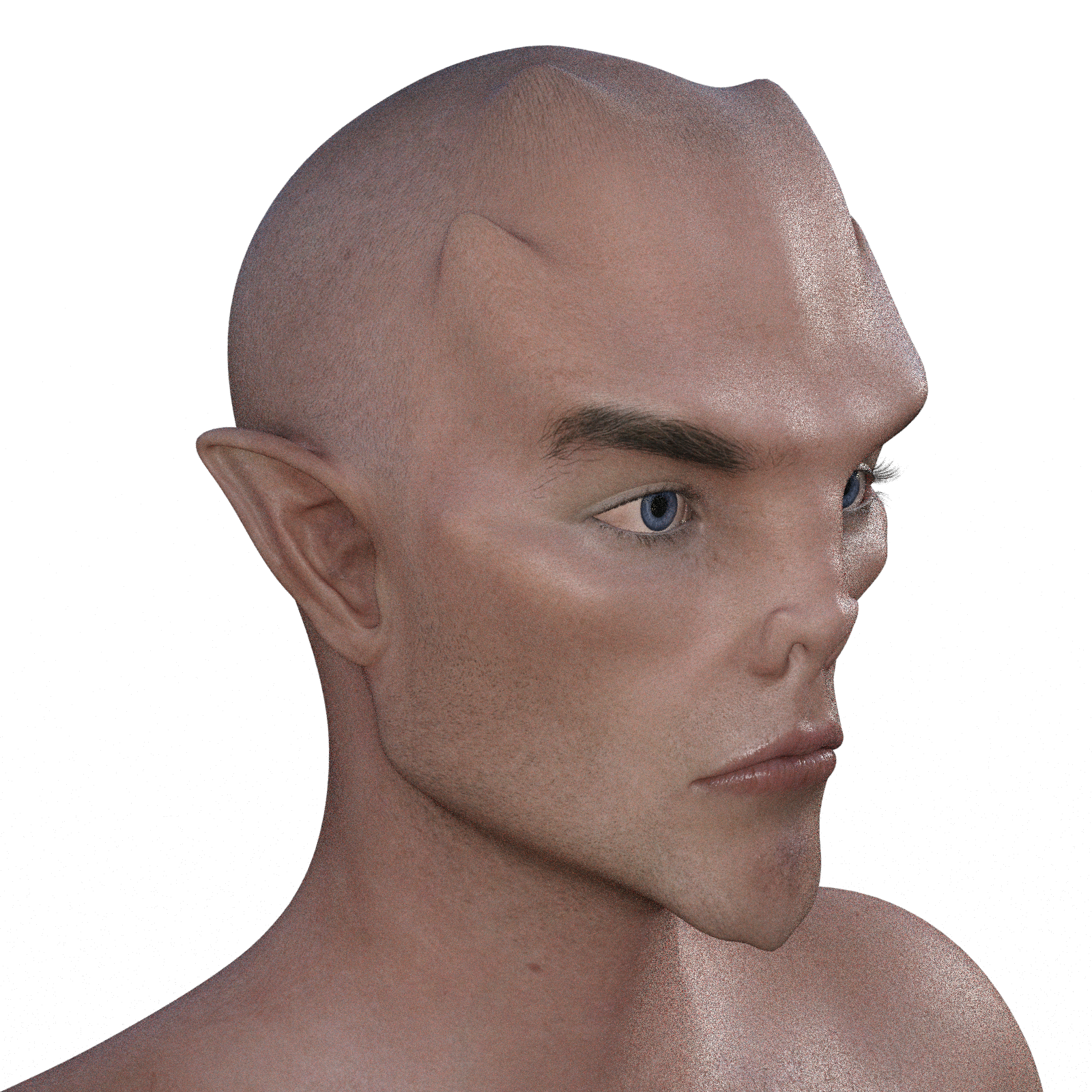

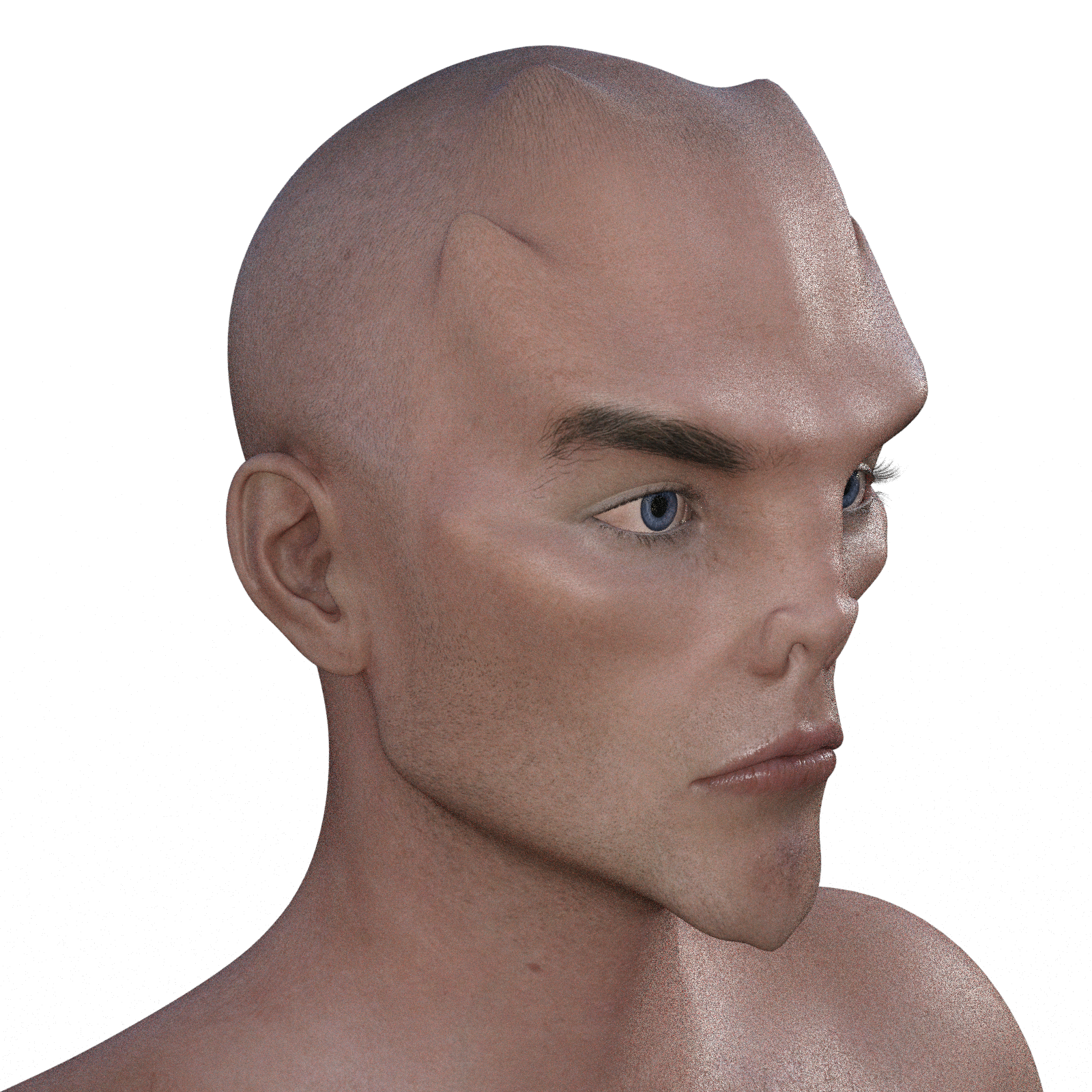

    Never mind, I solved it. First, you apply the split deformers included with Shape Splitter, then you run the actual Shape Splitter script. Go to the Weight Map subtab under the Divide tab, select the two ear DFormers, then change Preview/Save from Selected to Remaining. This will apply the morph to everything BUT the ears. This will only work for the specific morphs you want to run this process on, so if you only need this for a couple of morphs, it's fairly painless. There's probably a way to do this more generally with DFormers, but I don't know it.
    Here are the results of applying this method to the HFS Demon head morph:
    Before
    After
