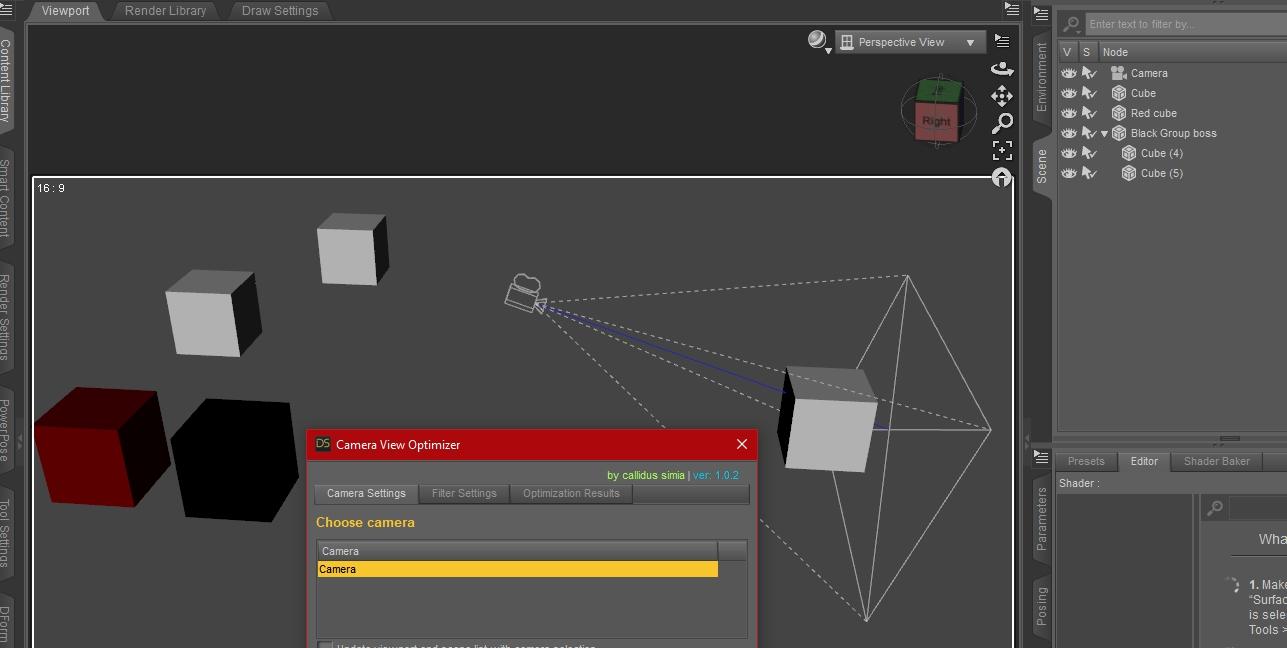

    I still wanna try the tool, but... it say nope ;(
    See attachment, I wanna make a Scene from the House entrance, but the tool doesnt want to hide all the stuff in the background.
    The fences, the stairs inside, the walls and doors in the house, that all should be hidden.
    Do I use it wrong?
    I made it now all by hand, see image 2. I don't understand why the script not does it ;(
    1878 x 876 - 1M
    1340 x 756 - 847K
    Post edited by Loony on

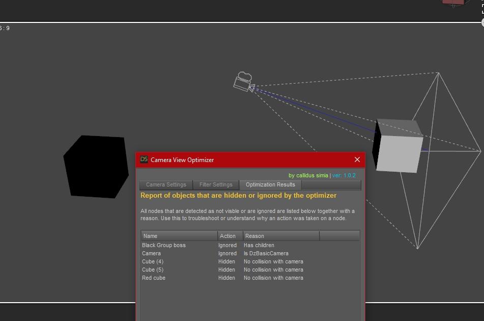

  • What you want hidden, is actually visible in the viewport. The script will (attempt) to hide items not visible in the viewport.
  • LoonyLoony Posts: 1,817
    edited February 2020
    that is what I want...
    but it does not hide anything.
    I found now the problem, "bones" objects and Parents of a group dont get hidden by the script, thats sad...
    The black cube get not hidden, because its the parent.
    And here it does not get hidden, because its "bones" of a object.
    Thats... weird, so i have to hide it all by hand.
    1287 x 648 - 176K
    951 x 630 - 125K
  • fastbike1fastbike1 Posts: 4,085
    edited April 2020
    You still don't seem to understand. If part of a prop extends into the viewport, the portion outside of the viewport can't be hidden / eliminated. The script can't modify individual props.
    Post edited by fastbike1 on
