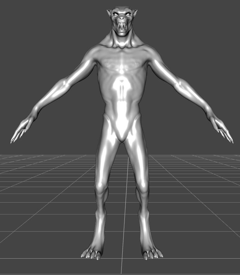

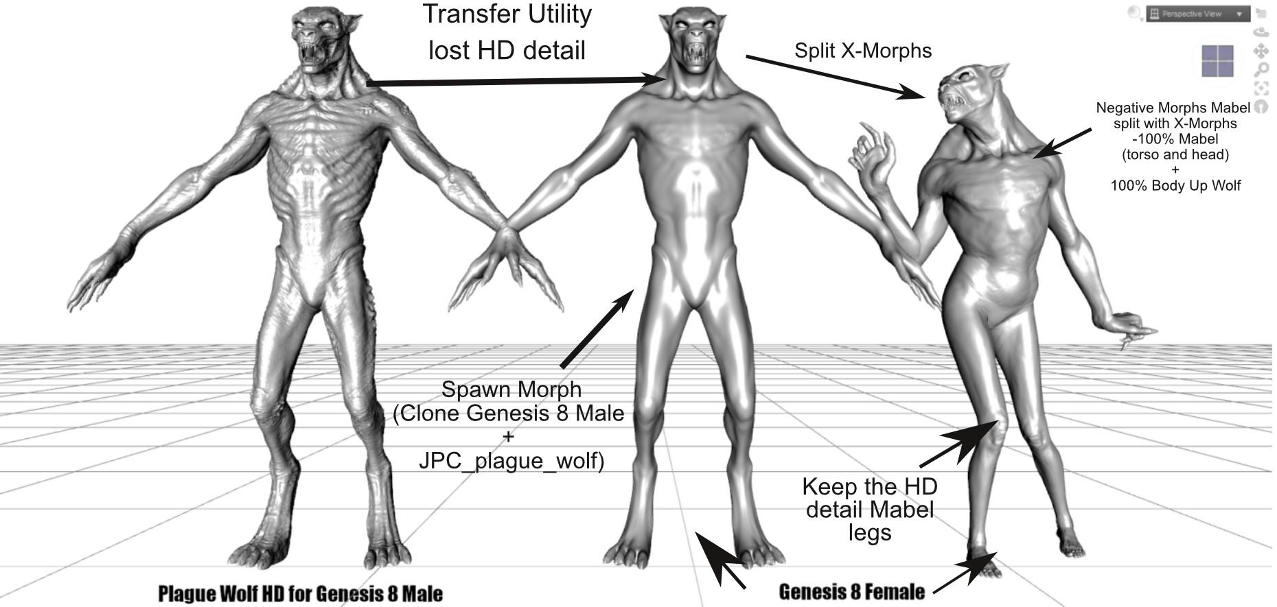

    Here I include a morph of a werewolf, which by means of the transfer utility, a morph was created in Genesis Female 8 (JPC_plague_wolf).

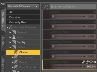

    Then I set 100% of the CloneGenesis8Male clone(hidden), so that it is identical to the Genesis Male8 morph.

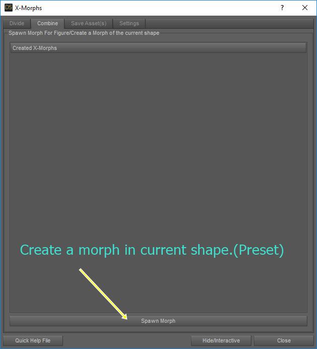

    I run Shape Splitter/X-Morphs and create a new morph of the current figure using SpawnMorph.(save as Wolfman8Male)

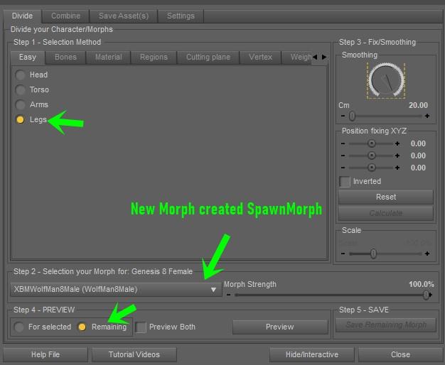

    Now to divide the morphs.
    For the top of the WolfMan (WolfMan8Male-Legs-Remaining), save it as WolfManBodyUP
    As I will use negative morphs to preserve the detail of Mabel use (Mabel 8 Body-Legs-Remaining) save it as MabelBodyUP
    And finally apply the morphs, WolfManBodyUP (100%) and MabelBodyUP (-100%), Mabel 8 Body (100%), Mabel 8 Body HD Details (100%), Mabel 8 Head (0%)
    The upper part corresponds to the male part of the werewolf of Genesis Male 8 and the legs correspond to the female figure of Mabel.
    Note: And it can also be done in reverse, transfer the morph of a female figure to Genesis Male, and thus preserve the HD detail of the werewolf in male character.
