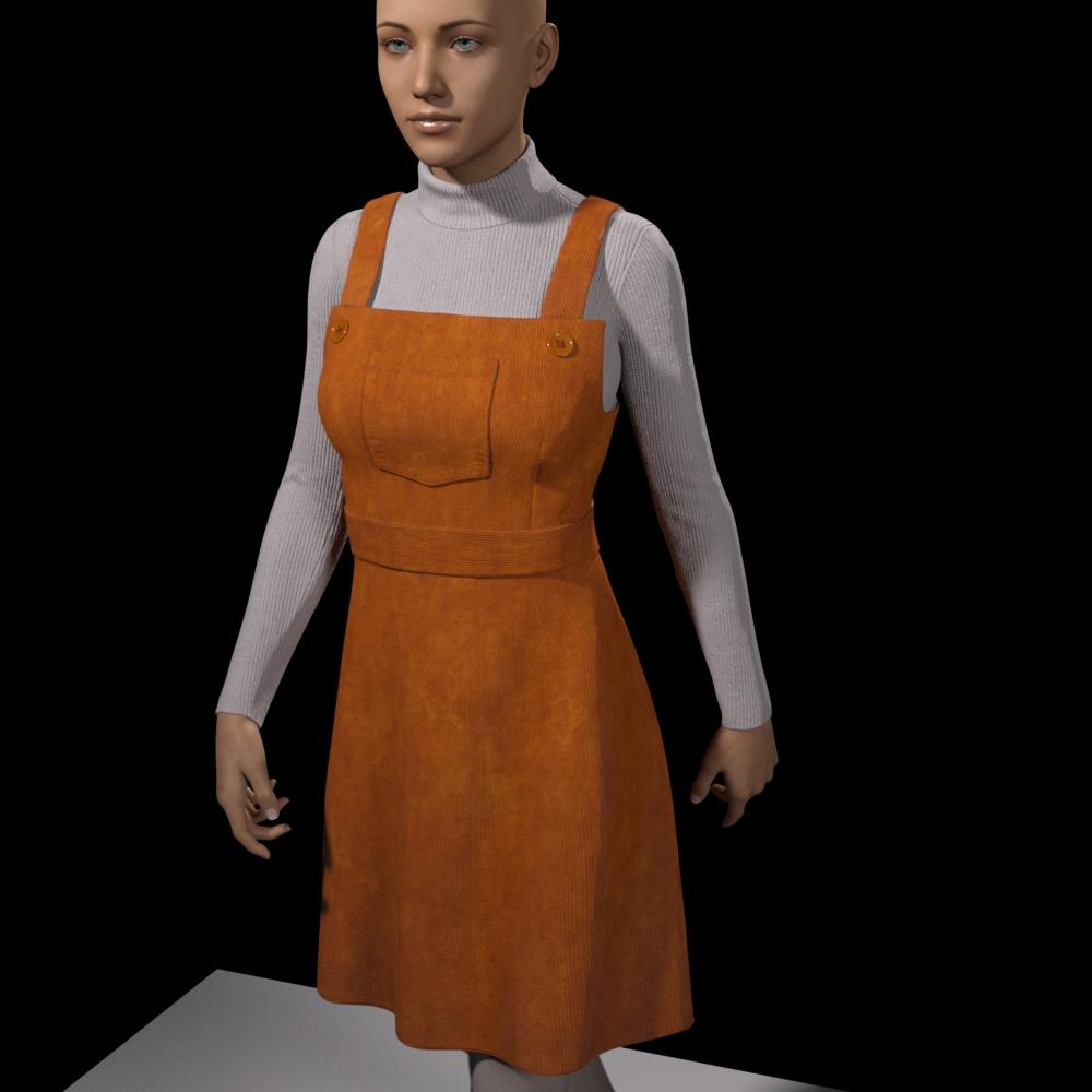

    I do have the set, now I've sntalled it only the skirt is dynamic (though the buttons on the top are set as Rigid Follow Nodes). However, the straps are sitting down OK for me - check that you don't have one of the adjusemnts for loosening them applied. I'll do some test renders of the materials, then try extending the active area.
  • Richard HaseltineRichard Haseltine Posts: 111,217
    edited January 2020
    Well, the area where the straps join the front goes a bit wobbly and the straps are a little irregular - I applied a smoothin modifier here - but with the collision settings set to Best it does drape without going boom (in this pose).
    1. Select the dress
    2. Create>New dForce Weight Access Node
    3. Select the Node Weightmap Brush tool
    4. Open the Tool Settings pane
    5. Click on Influence Weghts (actually, they should already be highlighted)
    6. Right-click in the Viewport>Geometry Selection>Select All
    7. Right-click in the Viewport>Weight Editing>Fill Selected
    8. Set the value to 100%
    9. Click Accept
    10. Switch back to your usual tool and see how it simulates.
    1000 x 1000 - 564K
