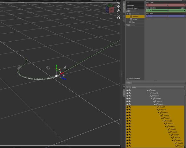

    In DAZ Studio you can also simply multi-select the bones (easiest in the Scene pane - right-click on the hose and use the Expand menu to expand from selected, click the first bone you wish to adjust, shift-click the last and use the Parameters or Posing pane sliders to set the rotations).

    This is a silly example since the item has controls, but I selected the first few bones and bent them one way then, as shown, selected another batch in the Scene pane and bent them the other way - that S bend took about six clicks and two drags on a slider to achieve.
    1340 x 1064 - 129K

    nice thank you. I know it has controls but they still don't get you exactly what you want.
