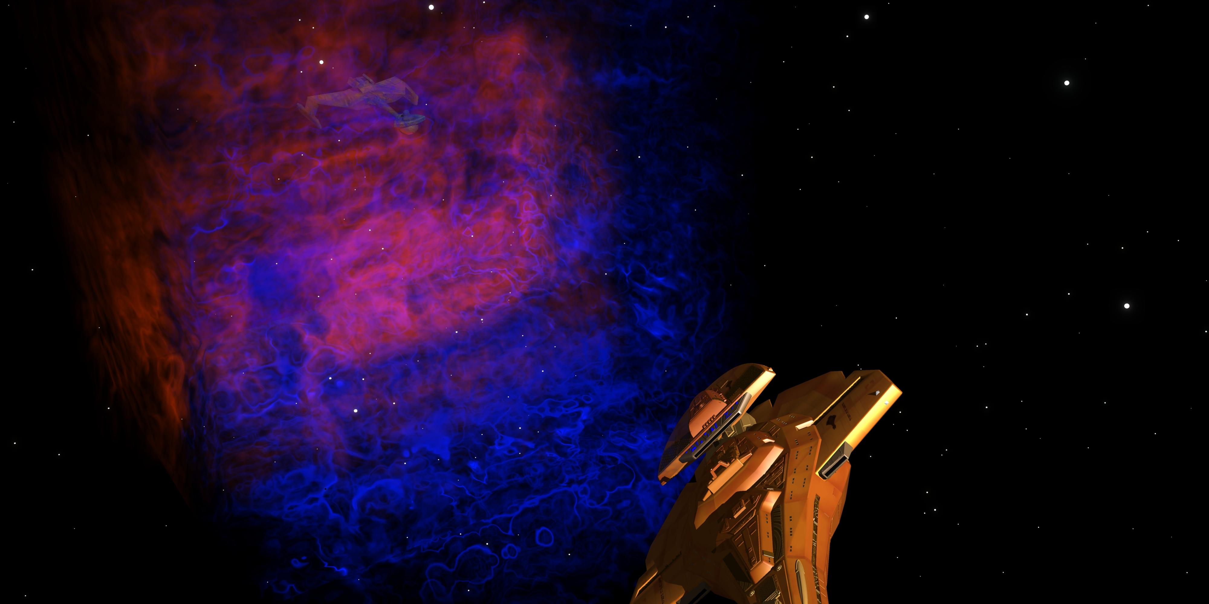

  • chickenmanchickenman Posts: 1,202
    Carrara challenge 19 had lots of suggestions to help me come up with similar idea's
    https://www.daz3d.com/forums/discussion/60434/carrara-challenge-19-above-and-beyond-wip-thread/p1
    This link has some set up info.
    https://www.daz3d.com/forums/discussion/comment/887363/#Comment_887363
    that 1st one very nice ~  colors.  and can see the stars thru it.

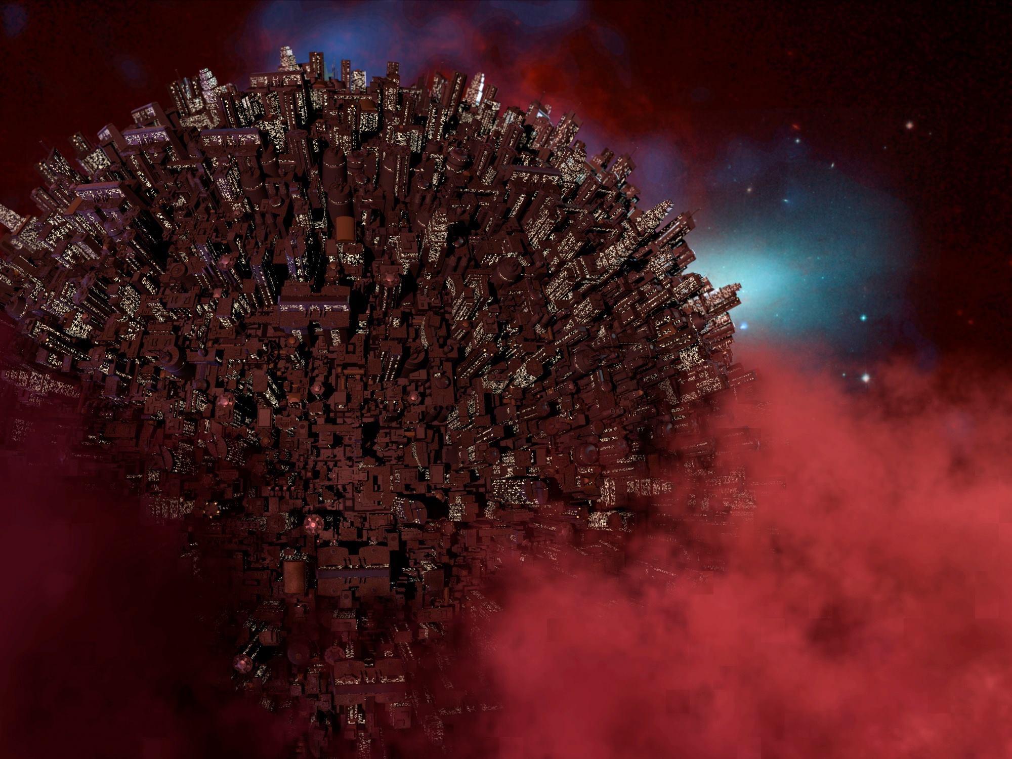

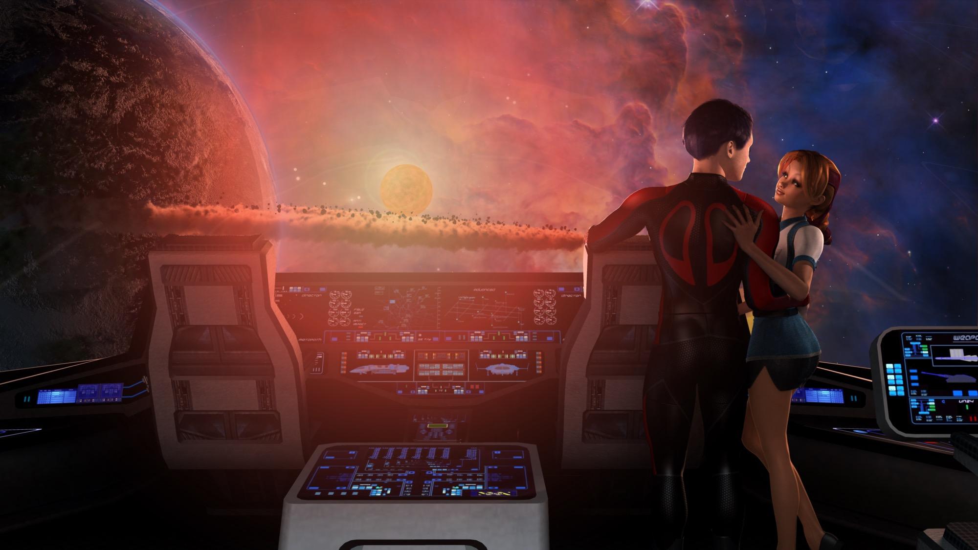

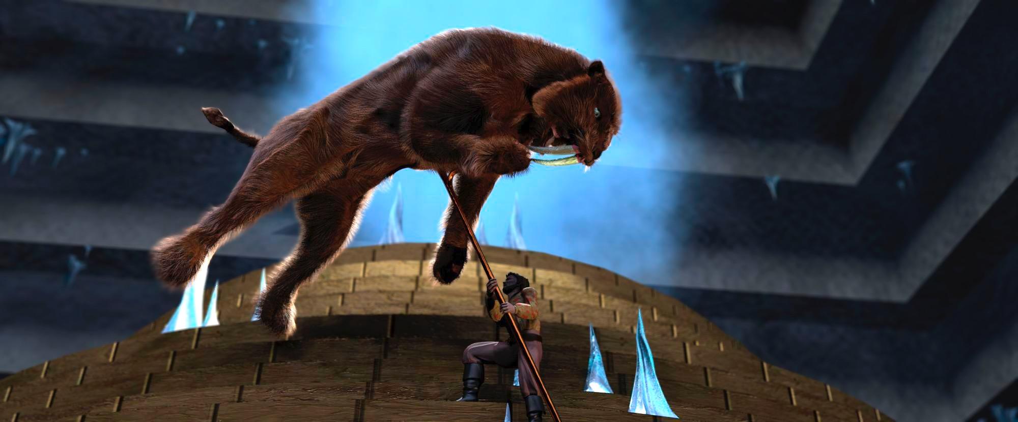

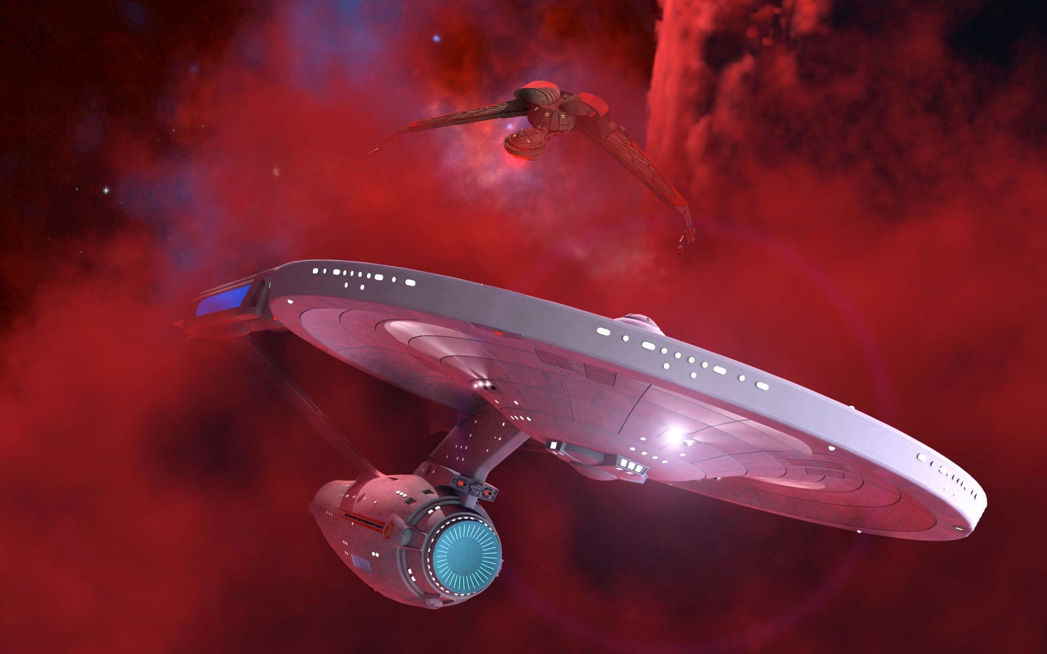

    As Dart said, combining different cloud colors works. The lights are also key to getting looking right. Even a white cloud can look blue and red with light placed withing them or aiming at them. Using freely available NASA images of nebulas as a background can also help fill in details and sell the effect.
