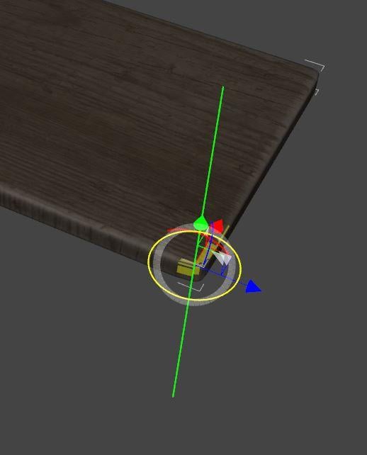

    Also, I'm finding that with some items, the mesh grabber tool isn't appearing next to the item selected, but rather it appears high above it, so far up that I thought it wasn't appearing at all in the default view.  Thus far, this seems to happen mostly with clothing items that are from other stores.  Needless to say, though, it pretty much makes manipulating those items imposssible when the Geo Too is effectively 15 feet away, loating over the subjects head...

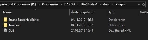

  • MartialMartial Posts: 431
    Allo
    I  bought today Mesh grabber
    I don't see the plugin in DIM I have updated DIM and try 2-3 time different maners and never see mesh grabber
    I have finallt installed manually in D:\DAZStudio4 64 bits
    I am iusing version DAZStudio  4,12
    When i open DAZStudio i see Mesh grabber in Tools menu but no mesh grabber in the panes list
    So i cannot use it for now
    If someone can indicate to me where the files are supposed to be installed , i would tried to find and install each one manually inside D:\DAZStudio4 64 bits
  • RGcincyRGcincy Posts: 2,864
    You access it from the Tools menu, it does not show in the panes list. Choose it as your tool and you will see a pane with various settings. To use, click on a mesh in your scene (or select a mesh in the scene pane). When you click on the mesh, you'll select polygons. For most objects, there will appear a set of 3 axis and a white sphere (there's a bug for some objects where these might appear at a different location). Garb a handle on the axis and pull/push.
    Thanks
    I finally found a gizmo for mesh grabber but see no settings dispalayed
    Here are some screen capture showing where the files are installed and an example ( just a sphere primitive) inside DAZStudio
    1038 x 699 - 327K
    1920 x 1200 - 266K

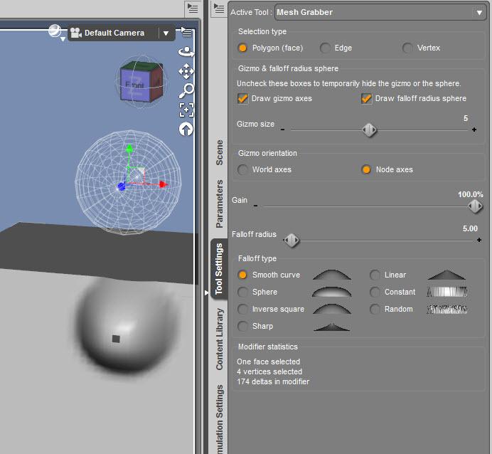

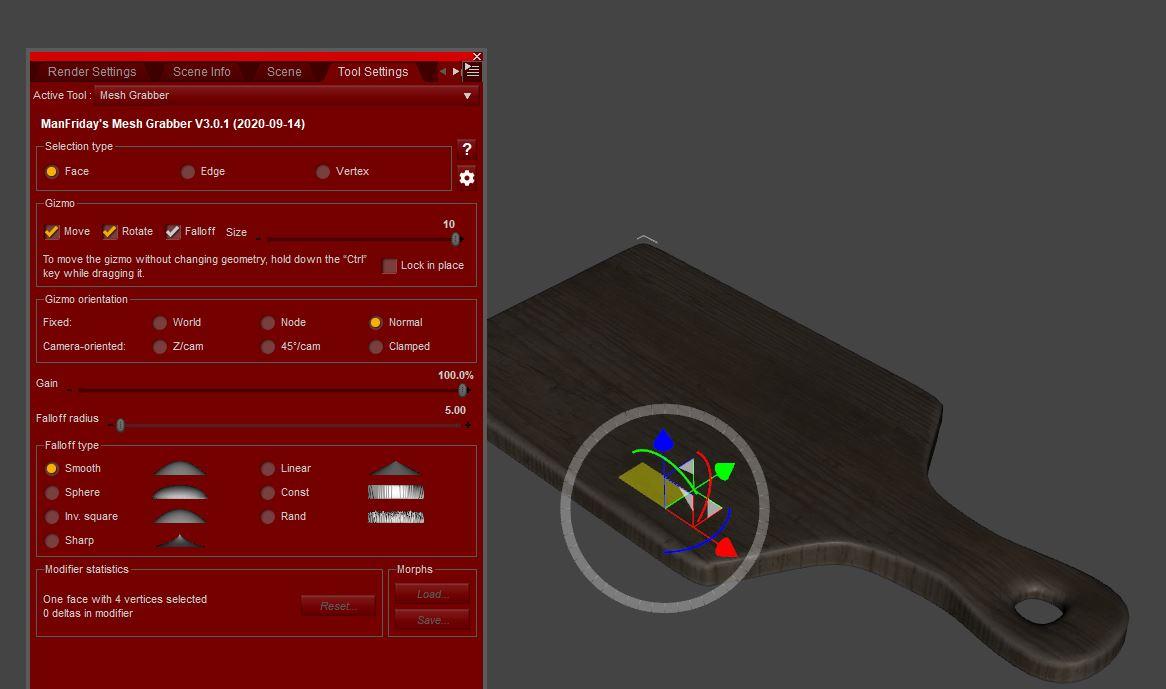

    I don't see your Tool Settings pane in your screen capture (they may be lower down). If you don't have that pane open, go to main DS menu and choose Window/Panes (Tabs)/Tool Settings to open it. You can then dock it next to one of your other panes. If that's not the case, I'm out of ideas.
  • barbultbarbult Posts: 27,607
    edited December 2019
    It worked great to fix some clothing poke through, but why does the Mesh Grabber tool remain highlighted in the tool bar even after another too has been selected?
    500 x 69 - 9K
    Post edited by barbult on
  • RGcincy said:
    "I don't see your Tool Settings pane in your screen capture (they may be lower down). If you don't have that pane open, go to main DS menu and choose Window/Panes (Tabs)/Tool Settings to open it. You can then dock it next to one of your other panes. If that's not the case, I'm out of ideas."
    As per attached screenshot, then in the Tools List dropdownin the too lsettings pane, choose Mesh Grabber to see it's controls.
        Good Luck
    599 x 1022 - 110K

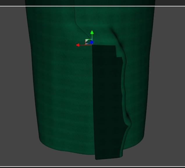

    I am having trouble with the gizmo appearing in some place no where near the selected polygons. Is there a way to get it closer to what I select? I haven't read all the pages of this thread though but I will later to see if there's an answer for the problem...
    Hi all, cool tool!
    It has been acknowledged as a bug. No fix yet. It only happens on certain items, not universally. It hasn't happened to me yet.
