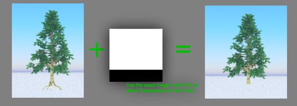

    Well, Rashad! QED! Boolean operations are not possible with Bryce Trees. Export-import - it is not our method. To get a good quality, you need millions of polygons, and this is not acceptable.
    I immediately did not upload this picture. I wanted recognition from Rashad that the Boolean operations can not be performed. But I prepared it. This root pruning with a mask in the channel transparency. Right there is a bad result of Boolean operations. In the center and the left is the results of work in the Edit Texture and DTE. However, in the root I still remained some artifacts. I found a way to fix them. In Mat Lab refractive index must be set to 0.

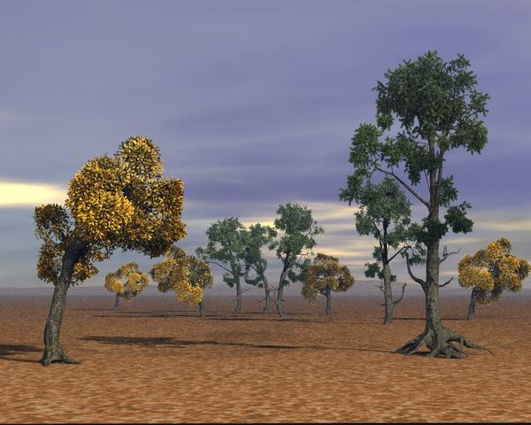

    Here two exotic trees with removed roots in Mat Lab. The lower part of a trunk is executed in Sсulptris. On the left tree the krone consists of several Bryce Trees.

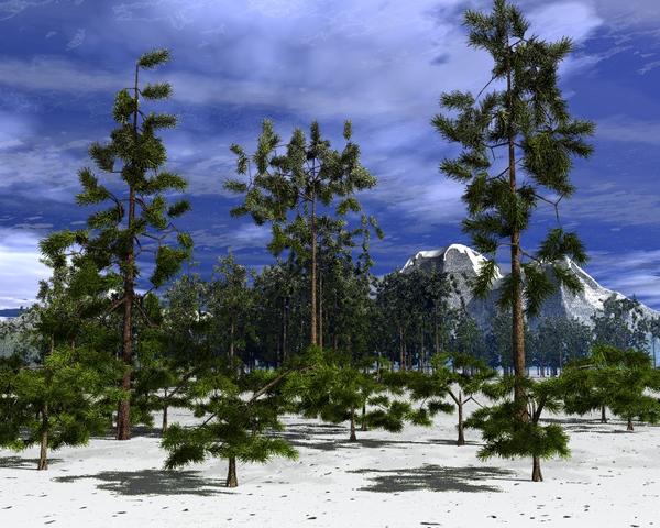

    Not my nicest tree and certainly not very natural in this frozen ground even though it is rendered with natural light. I used Rashad's idea with the tapered cone and Alexey's idea with the height sensitive transparency. Thank you both, very helpful advice, indeed.

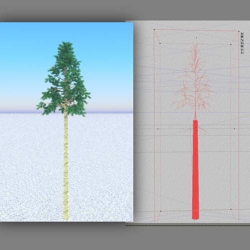

    If I were attempting a tree like the examples shown above I would use Boolean Operations to accomplish it.
    Step 1: Create a pine tree in the tree lab that resembles the top part of your desired tree. In the Attributes, enable this tree as a Positive. Save the material you used as the trunk in your Library.
    Step 2. Create a Cube. Enable this Cube as a Negative. Place this cube at the base of your tree so that it can hide the roots. Group the tree with the cube and it should create a cut off such that the roots are no longer visible in the render.
    Step 3: Now we need to create the look of the extended limbless trunk. One could use a column of metaballs, which can then be grouped and then be collapsed so that it becomes a true single mesh object . I'd export then re-import this model as an obj. Just line up the top of your metaball column with the new apparent base of your pine tree. Apply the same material to the extended trunk as you did the trunk of the pine tree, and the result should look quite decent.
    Perhaps an even easier trunk could be made by using one of the tapered cylinders in the Additional Primitives. Either way, this tree can be done.
    There could potentially be some slight inconsistency at the point where the original tree becomes joined with the faux trunk, but these are relatively minor considerations. I think one could make it less noticeable by cutting off the trunk of the original tree a little higher up well above where the roots are. By cutting away more of the original trunk you can hide the "seam" within the branches so that the extended trunk remains smooth looking all the remainder of the way down.

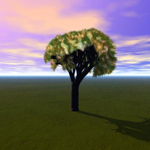

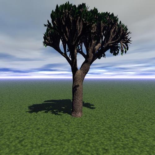

    Not a very successful attempt to make the dragon-tree from Bryce tree.
    File "dragon-tree.obp" can be downloaded here:
    http://www.4shared.com/file/xCC_WoVxce/dragon-tree.html
    In the foliage is used property of transparency.
    You can see the work with this tree here:
    http://www.daz3d.com/gallery/#images/71723

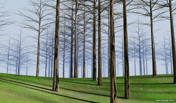

    Realism is over rated. Bryce can also do this.
    1434 x 695 - 134K
