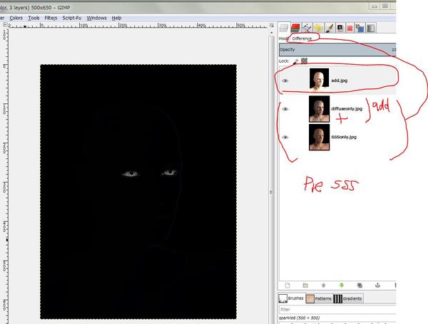

Pre SubSurface setting (Edit2)
R,G,B = (Fsub (???)) * SuBcol * SuBstr) (Linea dodge?) ( Dtex * Dcol * Dstr)
Post SubSurface setting
R,G,B = (Fsub(Dstr * (255,255,255)) * SuBcol * SuBstr ) * (Dtex * Dcol)

I believed about Pre SSS mode, it is simply "add" subsurface and Diffuse,
Now I check again Video,, it is not simple "add" ^^;
then,, How (Linea dodge) are calculatede? I do not have Photo shop,,
IN gimp which layer mode means?
    Dodge (and it's opposite 'burn') are terms from photography. When creating prints of images, one would 'dodge' an area of an image if the negative was too bright in that area or burn it if it were too dark. So while I don't have the precise way that the Linear Dodge is used in this sense of the word, I could extend the photography meaning to this as well. So it is probably changing the brightness of the surface at that location.
    I'm not sure in GIMP if you would be looking at the "Dodge" option or the "Lighten Only" option from the Layers window to correlate to Photoshop's "Linear Dodge".

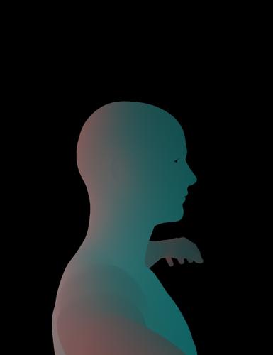

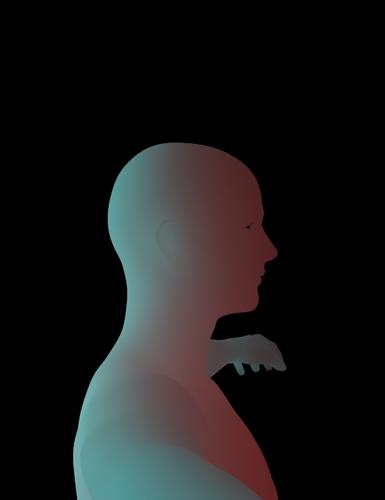

    I've just posted an article on my blog about the physics of subsurface scattering to try to help people understand what it is that an SSS enabled shader is trying to simulate.
    Light and SSS Surfaces
    So in addition to the blog post I linked above, kitakoredaz and I had an additional bit of conversation in my JonnyRay's Tutorials thread about the general operation of SSS enabled shaders. Since the convo is back now to how Will's shader specifically works, this thread makes more sense for that.
    Quoting Kitakore's last questions here to continue the discussion...
    Hi,, thank you,,, I may close to understand 70 % ^^;
    As I understand it, the RGB value on Scatter is intended to . This can be different than the underlying subsurface color. Think of it as “If the subsurface color is orange, but the scattering color is red, then the yellow part of the light gets filtered out”.
    Yes,, I can understand it. I think they are intended to change subsurface effect from same subsurface color.
    can be option, to change Subsurface effect, from same subsurface color (or map),
    and can change them.
    But,,, If the each value of RGB simply represent , what part of color,
    we may need simple Color picker style parameter, as same as diffuse or subsurface color, I think^^;
    or simply represent about each R,G,B value, with parameter limits, R 0 to 255, or 0 to 1.00 ,,(100%)
    about these case, I can tweak and decide the Scattered lay color easy,,, ^^;
    about absorb color, limits is min 0 to max 1,
    about scatter color , limits is min 0 to max 10.
    So that I am little confuse,, if there is clear meaning , and these are not same units.
    or it is same, about 0 to 100% ? (though we can not apply 0, as we checked already)
    Then,, now I hope to know,,the correct reasonable way to adjust this shader^^;
    that means, we may start better from subsurface color = white?
    or we may start from subsurface color = black?
    how we decide them? I know they should change with scatter, and absorb color already,
    but eg, If I change shader about skin material which used by daz default shader,
    to SSS, and hope to make sss translucency effect,
    basically, at start point, we may set subsurface color with white,
    then adjust each value?
    Strictly speaking, if it is desigend , to apply sbusurface color map to get real subsurface effect for each human skin?
    at start point? after that adjust Scatter R,G,B and absorb R,G,B ?
    I think,, about Scatter R,G,B and absorb R,G,B,, it should be decided proximately for each material,,
    as same as Reflaction index, so that there is preset eg SkinA and SkinB?

  • kitakoredazkitakoredaz Posts: 3,526
    edited February 2014
    Yeah,, thank you AoA and all,,
    I finally understand,, (but not accurate mathmatics,,^^;)
    each SSS prameter how work and make effect,,
    it seems better when test SSS, only set subsurface color, (255,255,255)
    it simply mutliple, with subsurface strength, and scattered absorbed calculated color
    on each point.
    when I set another color, it simply effect all points on surface as multiple.
    the subsurface effect simply be decided, by scatter and absorb value.
    I finally understand,, why we need two different parameter.(scatter, and absorb) ^^;
    my mistake was,, when I test this shader, I try to use with 3 ight setting
    as same as AoA tutoriall video. and micheal 5 skin .
    ofcourse it need to get human like skin,
    but it cause me difficult,,how subsurface translucency work with light ^^;
    and may better set subsurface scale, eg 20 or 30 to see scatter and absorb effect clear.
    then I set one direction light only. and check ,,now
    scatter and absorb effect clear ,,, I feel I get some clear progress
    when I use this shader^^;

  • Age of ArmourAge of Armour Posts: 437
    Hi Kitakoredaz,
    Sorry for taking so long to reply. The last test you did using the single light was a great one! It does show a lot of how the colors are absorbed and scattered.
    As you can see, the light can change colors depending on the absorption and scattering values as it passes through the object. So the presets in the drop down menu automatically adjust the settings to match some settings that were measured in the research paper I linked earlier. I can not take credit for figuring them out myself hehe :)
    The reasoning behind the different limits was simply that, at an absorption of 1, the effect becomes so faint that it hard to see. I figured that it would be unlikely that anyone would want to use any settings above 1.
    While testing, I noticed that I could tell a difference when the scattering values were higher than 1. As you illustrated in your renders, you can see noticeable changes even above 10 but I made an arbitrary decision to set the limit at 10.
    The thinking behind the limits were intended to give the user an idea of what ranges of values might be common. The limits can certainly be increased or disabled though.
    When I first started using DS and Poser, I found it difficult to adjust any shader which did not have limits because I never knew what general range the shader designer intended the settings to be. Because of this I try to include limits which give a "Ball Park" idea of the most useful range of settings.
    As far as how Linear Dodge works... I have Photoshop CS5.5. When I create a solid color of R100, G100, B100 then create another layer above it using the color R0, G0, B125 and set the mode to Linear Dodge (Add) It yields a combined color of R100,G100,B225. Do you get a different color when you try it? If so, is there an adjustment layer above it or maybe a gamma setting someplace?
    Hi,, thank you AoA, I may need more test to make good setting what I hope,
    about absorption and scattering value combination ^^;
    but now I can understand basic design roughly.
    then I test with linea dodge, (actually it is calculated when I render)
    I render use only diffuse, and subsurface, as same as you guide in your video,,)
    I send two image to GImp,
    Layer 1 (diffuse calculation only) (add option)
    Layer 2 (subsurface calclulation only)
    I expected Layer1 + layer2 = final rendered R,G,B , at first time, (in my first formula^^;)
    but somewaht different when I checked them in gimp with "add" type
    each parameter again,but if there were some missing I think.
    And,,, the Gamma Correction is really important for me,,
    I hoped to ask you when I use gamma correction with your shader.
    About many case, I need to weaken light strength, and adjust specular etc, when I use Gamma correction,
    but it show me clear colors, and natural shadow effect.
    then I usually set Gamma Correction On. (2.20 for my windows PC) in render setting tab.
    when I set Gamma Correction for textures with your SSS shader,
    Actually it make me more confused, to adjust material preset (made with other shader) for your SSS ^^;
    I know in your VIdeo, you do not check it on, so that I hesitated to ask you about gamma correction,,
    but I have used Gamma Correction setting for many Mat presets with ds or UberSurface shader,,
    so that I hope to use it with your SSS shader too,,^^;
    If you have some advice which I need to adjust values, when use gamma correction setting , with SSS shader,
    and daz skin textures,, (eg V6) I really hope to know these how to ^^; you are so popular vendor, that I do not hurry,
    but if you know good way,, advice please here , when you have some time ^^; I must wait. )
    Then I do not know about gimp setting much ^^; if I need to set Gamma Correction in GImp too?
    If Rinea dodge = just add each R,G,B! I really feel good,, :)
    because now I can get simple formula which show how your shader work .
    (though about how SSS calculaed as formula, it seems still black box for me ,)
    Post edited by kitakoredaz on
    If you are rendering at a different gamma then that might be why the results don't quite add up when using linear dodge in Gimp. I was using a gamma of 1.0 for the tutorial since that is the default setting of DS which most people will be familiar with. Not to worry though, that was just an example and not necessary to use the shader.
    As far as subsurface compatibility with gamma, I do use the SSS shader with higher gamma often so I know it will work and look good. But, whether it is giving physically correct results, I don't know at this time. I'm a bit embarrassed to admit that I am not sure in what ways gamma affects the renderer. I do know how the basic math behind gamma and the look it achieves, but there may be a lot more going on between gamma, the shaders and the renderer than I notice at first glance. It is something I do intend to read up on and test more in the future though.
    With all that said, you should still be able to use a higher gamma with the SSS shader though you may need some adjustments of the settings. While initially learning about the SSS shader or following the tutorial, I would recommend using a gamma of 1 until you are familiar with what each important setting does. Once you do feel confident about the main functions of the shader then use any gamma you prefer and make adjustments to the shader settings as you think look good.
    Thank you to confirm. Finally I could see same effect in My Gimp too.
    the eye around are not used AoA subsurface shader,
    about right face edge,, I do not know,, a little bit difference,, when compare,, different layer mord.
    (some scatter color flow?)
    Gimp add = photo shop Linead dodge, I believe. then SSS pre setting work, as it was said in your Video with GImp test too.
    it is really simple fact,, but as for me it was very helpful .I can concentrate only SSS effect to make final render,
    from other diffuse textures.
    And thank you advice. I undersatnd,, I should do more render with SSS shader, without gamma correction setting
    to know each setting clear.
