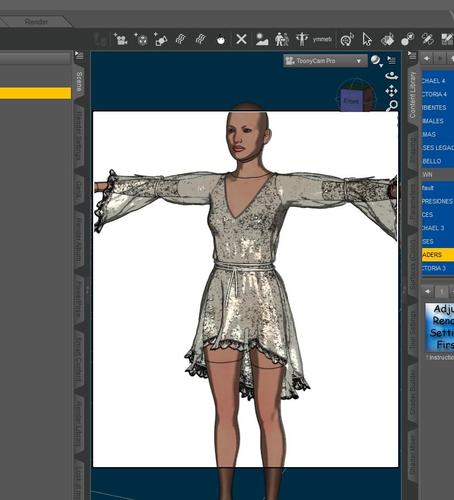

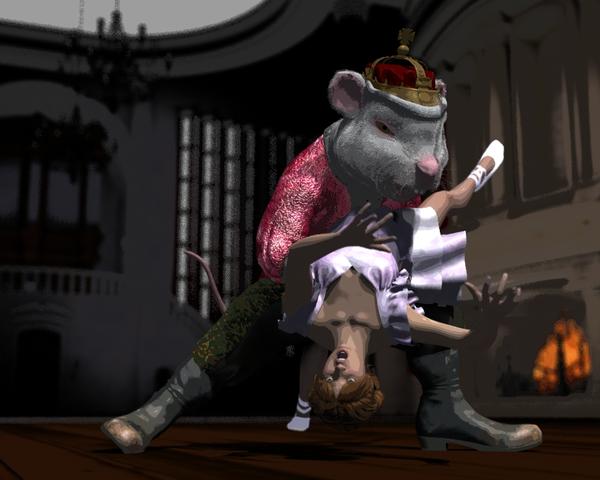

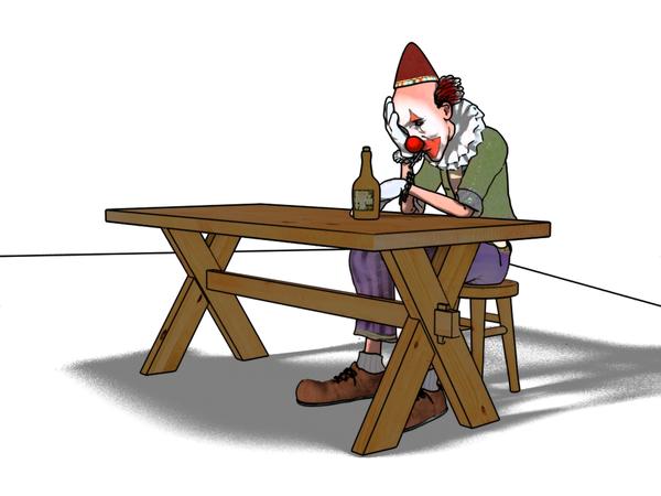

    wsterdan said:
    A couple more quick tests (time is at a premium these days).
    The only problem I encountered was with outlines around the special effects; I rendered once with effects and once without, then merged just the effect. Ideally I'd be able to turn off the outline for just the cube and plane when rendering.
    Thanks again for such a great plug-in.
    -- Walt Sterdan
    Did you try turning off Outline Depth for the special effect surfaces? No guarantees, as it's an undocumented feature, but it might be worth a try. :)

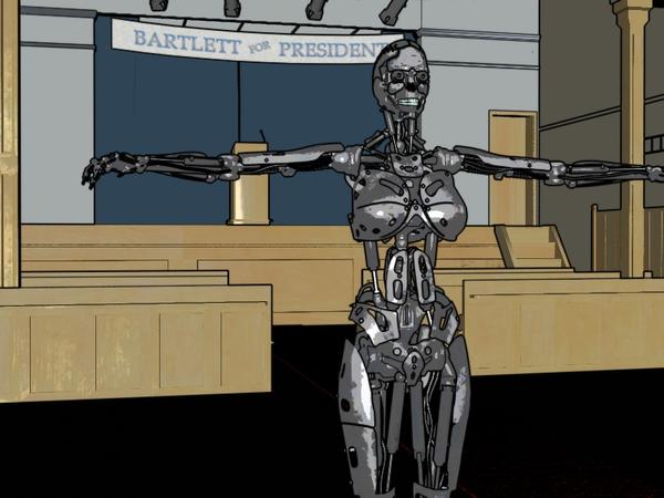

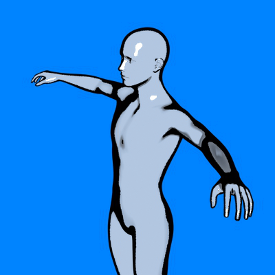

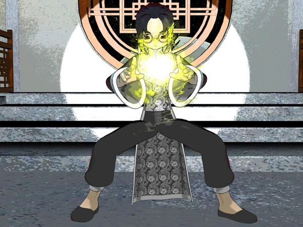

  • wsterdanwsterdan Posts: 3,578
    zigraphix said:
    -- Walt Sterdan
    I'll give it a shot tonight... Would I select the item instead of the camera, then apply?
    -- Walt Sterdan

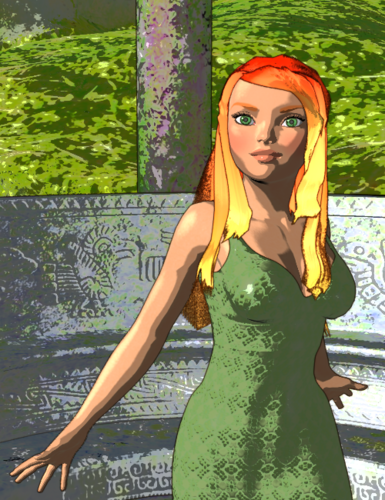

  • RAMWolffRAMWolff Posts: 10,382

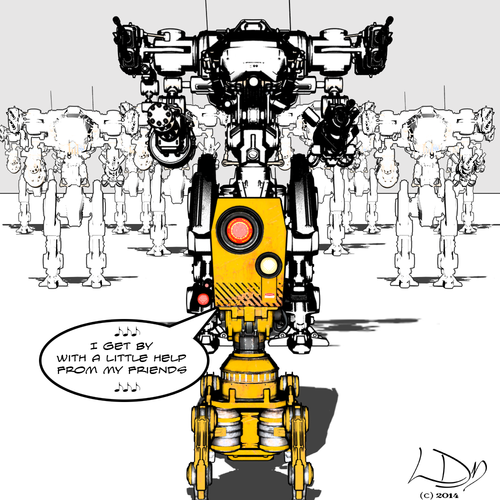

    eldil said:
    No Anime Shaders here either, so I tried a simple diffuse color on each surface.
    I used Outline ID and Depth on the figure (Didn't realize they would work together until someone mentioned it in this thread). I love how it brings some of the wrinkle details.
    Outline ID on the background, then layered them in Photoshop....
    I like this the best so far. Nice line width and gradated colors. Can this be achieved without going into Photoshop?

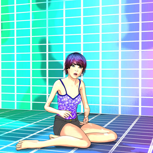

  • Testing6790Testing6790 Posts: 1,091
    LOVING the cell-shaded look. Did you really just use solid diffuse colors on the objects? What about the skin? *prepares notepad and waits eagerly*

  • zigraphixzigraphix Posts: 2,787
    wsterdan said:
    zigraphix said:
    -- Walt Sterdan
    -- Walt Sterdan
    Go into the Surfaces tab, select the surface of the effect object, scroll to the bottom of the surfaces tab, and you should see "Outline Depth" with an off/on switch. Turn it off just for that surface.

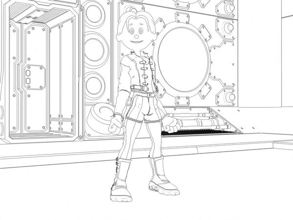

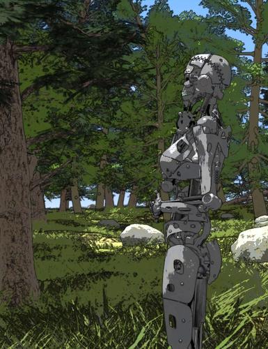

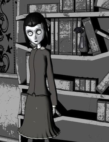

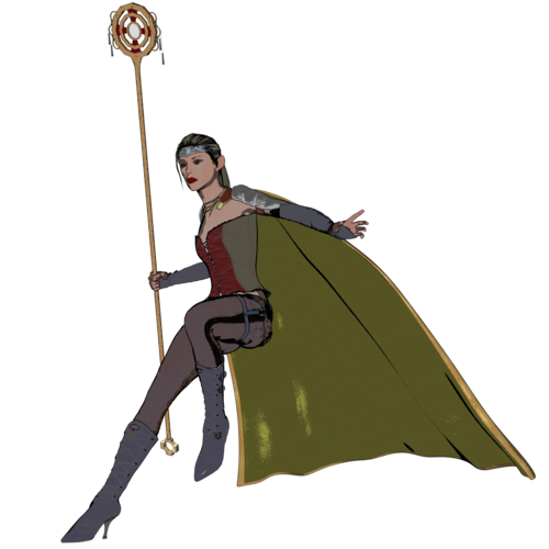

  • eldileldil Posts: 14
    RAMWolff said:
    You can use Outline ID and Depth together without Photoshop. But when I applies both to the whole scene, it blacked out a lot of the background.

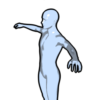

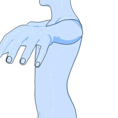

    Outline ID looks good by itself, but I wanted to use Depth to pull out some details, like her chin, and some of the fabric wrinkles.
    I decided to render the background and foreground separately, then composite them.
    I used the preset line thickness 3. My original render was 1987x3075. I mention this because when I rendered at lower resolutions (like my test renders at 500x774) the lines were super thick.
    The first is the image I already posted.
    The Second is and earlier draft that had Outline ID and Depth turned on for the entire scene...
    The third is the foreground figure with Outline ID only... no Depth...
    1292 x 2000 - 843K
    1292 x 2000 - 2M
    1292 x 2000 - 3M

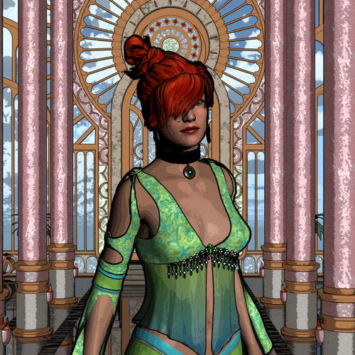

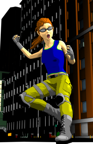

    edited March 2014
    Here's the Method I used... I'm a relative Noob, so I'm sure somebody else has a better way...
    I started by selecting every surface in the scene.
    Next I applied the "! Reset Surface" shader that came with Genesis Supersuit. (I would suggest leaving the eyelashes out of this)
    Then I applied the "!SimpleSurface Base" (I think that one comes with Daz...
    At this point, Everything (Including Genesis) is a blank slate with a very simple surface.
    Do all of this before running the script that adds Outline IDs.
    I then went through the surfaces one by one and colored them like a coloring book. It was a little bit tedious at times... but also kinda fun to watch it take shape.
    I also edited the Outline IDs by hand.
    I also left the sky dome, one sign and the graffiti with their original surfaces. I thought the graffiti added a little flavor, and I didn't think I could improve on the sky dome for this render.
    * Edit*
    Forgot to mention: One "!UberEnvironment3 Base" light at her feet (Occlusion samples: 128 - Learned the hard way...)
    And one Distant light.
    Shading Blend: manually set to 1.0 in parameters
    Shading Levels - 10 (also set manually)
    Shading rate .050
    Post edited by eldil on

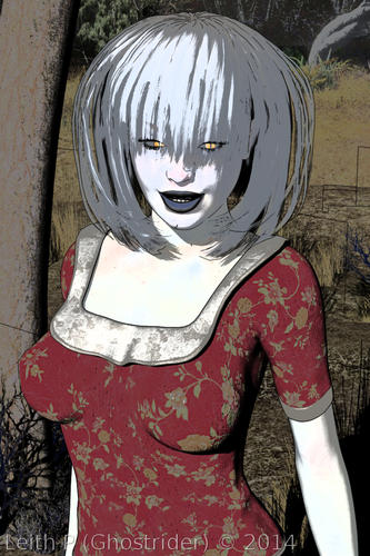

    eldil said:
    * Edit*
    Shading Blend - 50
    Shading Levels - 5
    Shading rate .050
    I'm going to have to try this but with skin textures. You can control-click a shader when you have a surface selected and change "replace" to "ignore" which will apply the shader to the texture. Most of the time it's a bad idea, sometimes it works out really well. Hopefully I'll remember to try this / post results tonight!

    The Normals outline method should pick up most of the figure details, but not black out the background.

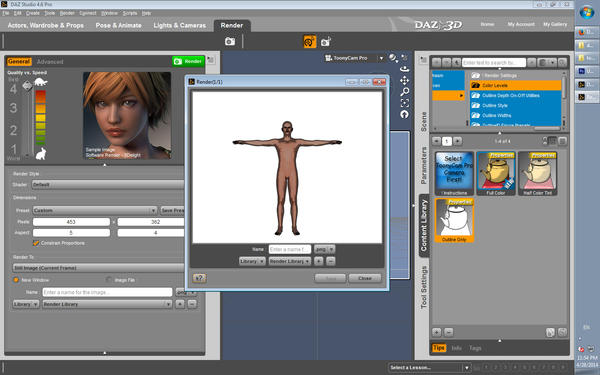

    Worked perfectly, many, many thanks!
    -- Walt Sterdan
    1024 x 768 - 185K

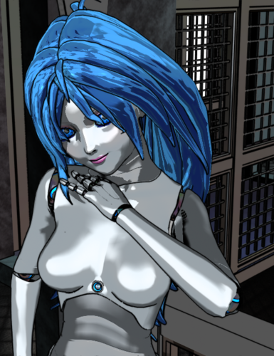

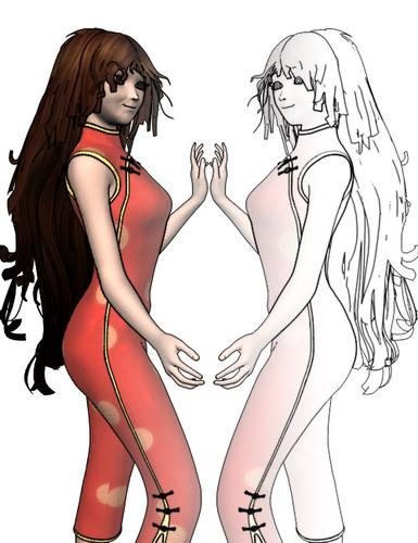

    I'm totally in love with this camera. Add the Manga Style Shaders, you have a comics factory!
    Here's my first render using them both. Thanks for bringing us something different, photorealism is soooo last year ;)
    (click to view bigger cos its fuzzy all shrunk down)
    887 x 800 - 102K
    Post edited by al_iguana_23_683c4ec9aa on
  • bad4ubad4u Posts: 684
    Very nice usage of ToonyCam and the shaders indeed. Love the style.
  • Alessandro MastronardiAlessandro Mastronardi Posts: 2,659
    Great product Zigraphix, congratulations for it!
  • nDelphinDelphi Posts: 1,975
    Very, very nice!
  • edited December 1969
    thanks :) you have no idea of the hoops I used to go through trying to get that effect on a conventional render using filters and curves and gah.... quicker to draw it with a sharpie lol. Still have no idea how the ID zones work and stuff yet (or how to actually set skirt-handles so they don't render), but I'm a very happy customer :)

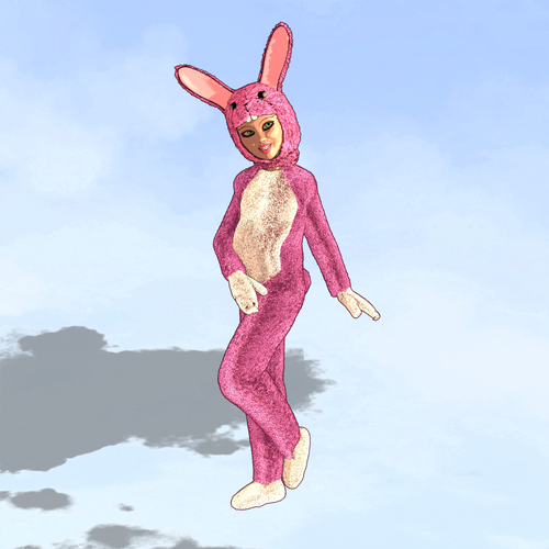

    Another furify experiment
    1500 x 1500 - 2M

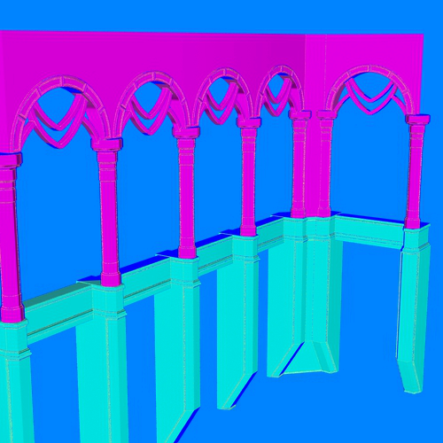

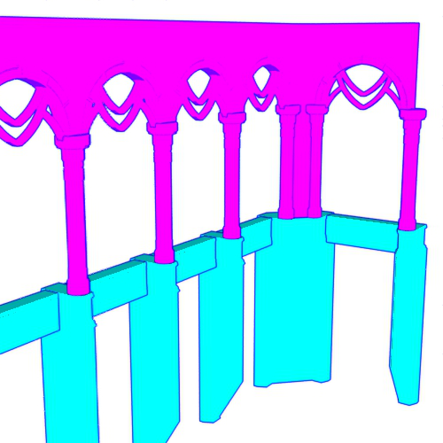

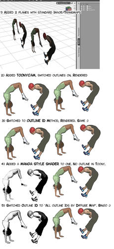

  • edited March 2014

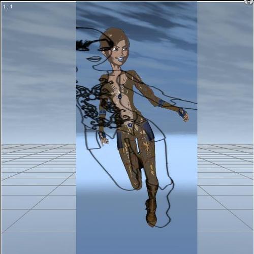

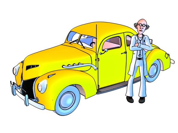

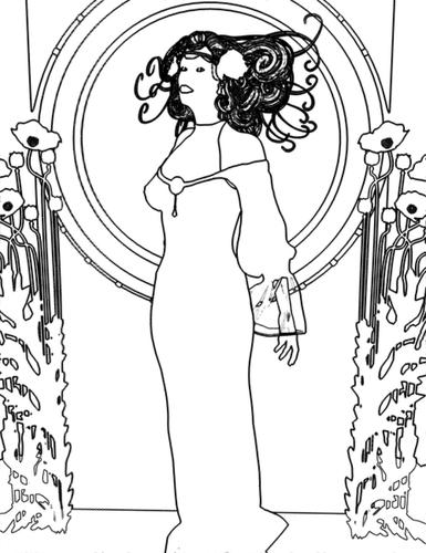

    hmm had to try this out :)
    IMAGE 1: I put 2 flat planes into Studio, and put a standard Image/transmap on them.
    IMAGE 2: added Toonycam, switched outlines on, rendered. no problem
    IMAGE 3: Changed to Outline ID, rendered, again no problem :)
    IMAGE 4: Added a Manga Style Shader to one of the planes. Aha... Toony drew a box around the plane with shaders (doesn't show in render though). I set the planes to overlap slightly, which is why the second plane loses its outline on the left of Aiko, the first plane is overwriting it with a box (that you can't see lol)
    IMAGE 5: changed OUTLINE ID method to "All outline IDs by diffuse map". Bingo :)
    So yeah, Toony Works fine with transmaps if you set it right :)
    You could render a soldier, paste that render into a flat plane, duplicate 100 times, instant army (with your main figure striding heroically in front). I would try it, but I just woke up and need MOAR COFFEE lol
    918 x 2000 - 623K
