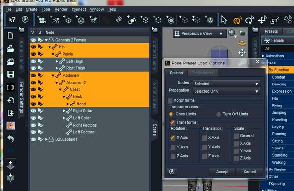

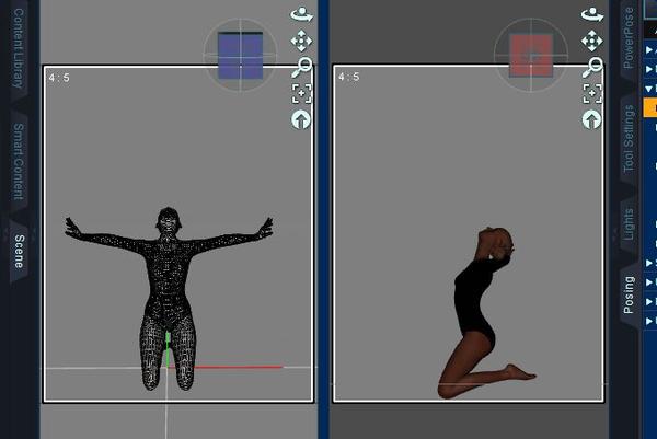

you can use "symmetry" (swap) pozing , and apply poze presets with ctrl key.
there are several way, you may find more easy way to mix these two options.
example
1 select pozing actor,r-click poze tab, then poze>symmetly
there are several option, I set trunk nodes to zero.
you can choose RtoL or LtoR to set under plevis.
you may need to adjust both Thigh to side ( they stick or too open, adjust as you like)
next adjust trunk nodes bending.
I select hip, plevis abdomen, abdomen2, neck, head, (trunk nodes only)
with ctrl key in scean tab.
then apply poze13.duf with ctrl key.
option window open,
check on only x-rotation to keep the symmetly but bend as same as poze 13. see my pic.
then finish.
