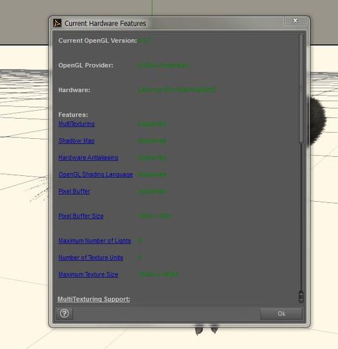

    The product page mentions minimum Windows specs of an openGL 2.0 capable graphics card
    does this mean that with a lower speced card LAMH will just not work at all or just that its performance will be slower or something?

  • gabugabu Posts: 303
    Difficult to predict what may happen with a lower spec card. Which one do you have? Maybe we tested it and I could give you some information.
    I had been worried because the installation is a bit complicated - I am running Studio on Win 7 in a Virtualbox machine on a Linux host.
    Studio reports the openGL version as: 2.1 Chromium 1.9
    Am I OK? Presumably the 2.1 is the crucial number, I don't know what the 1.9 means.

    I haven't tested LAMH in VirtualBox environment in a while. I don't see why there would be a problem though. I'll load up a VBox session a little later and try it myself just to make sure.

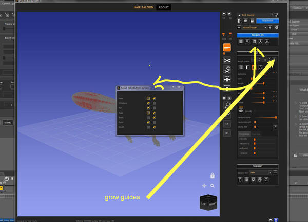

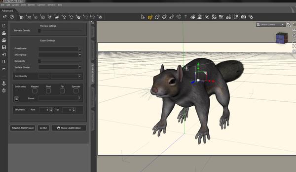

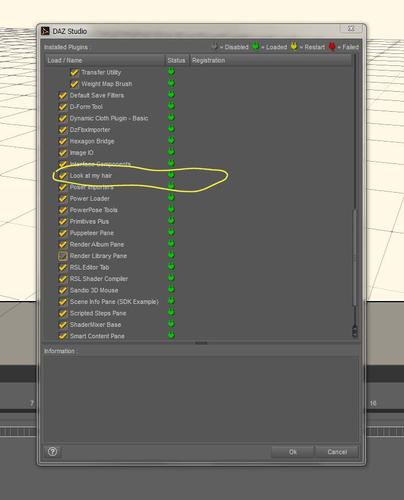

    Image 1- daz recognize my LAMH plugin automatically with out asking for my Serial Number, is that suppose to do that?

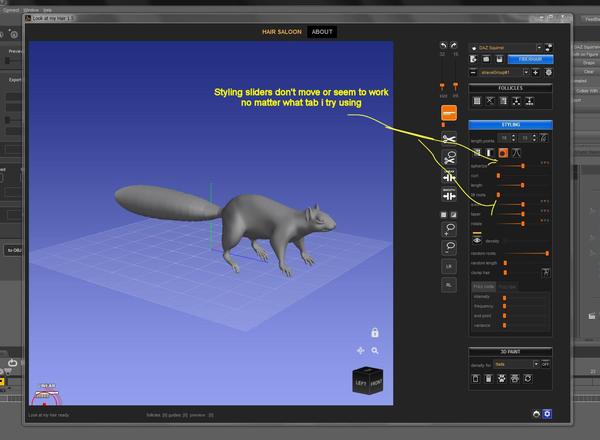

    Image 2 I had to manually load look at my hair from my program folder. it did not load a start menu on my desk top or my start menu as I had set during install
    I also had to save my project before i could get it to load into the LAMH program - Is that suppose to do that?
    Image 3- The follicles box does not not look the same as the way you have it in the pdf instructions . it does not list the tabs as on or off.
    Image 4 The Grow hair sliders does not work or seem to be frozen in place, when I try to move them but they just return back to the original setting and the hair follicles don;t react to the sliders. I folowed thwe PDF instuctions but this does not seemt o resolve the issues.
    Other than that I can't tell you any more because it appears at least for me that I can not get this to work in Daz Studio Pro4.6 64 byte version, and that is as far as I can get with this plugin
    Is LAMH supported in Dazpro4.6? I have followed every instruction you had in the provided PDF and I still seem to have a frozen version of LAMH
    Also none of the Desk Top Icons or start up menu icons or the Uninstaller - installed even with default settings checked
    Any Ideas on how I can fix these issues . I hate to return this product, I had it in my wish list a long time and used my bonus commission money to buy it. so any help would be great... or is it not supported in Daz4.6?
    I should add my computer more than well fits into your system requirements I added a snap of my graphic card gpu :)
    Thanks ~Ivy

    Hello Ivy, the 1.5 documentation is still being worked: we hope to have it released this week.
    However, the reason why you can't use any slider is that you actually didn't grow any guides. See attached image showing the button to be pressed for growing hairs.
    Thank you very much for the quick reply
    and thank you for resolveling my hair growing issue. i knew I was doing something wrong somewhere.
    I look forward to a update in documentation, because that will be most helpful for a blond like me fer-sure
