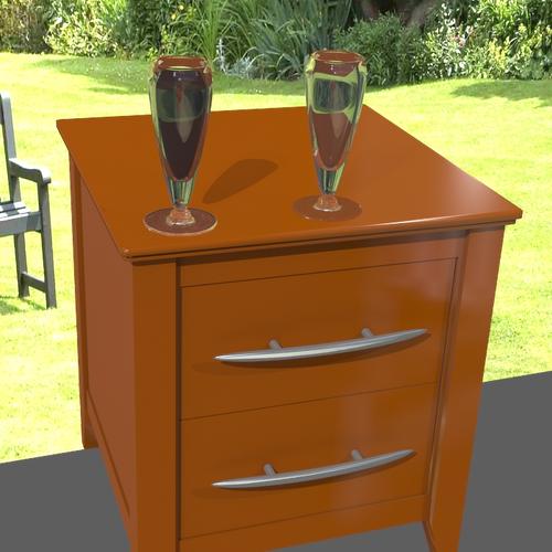

    I've just tried these setting for the Daz default shader in DS4.6, but it doesn't look much like glass.. what am I doing wrong?

  • frank0314frank0314 Posts: 15,098
    WHat do your render setting look like? With glass and mirrors the render settings are just as important.
  • SzarkSzark Posts: 10,634
    edited August 2014
    As Frank said render settings make a difference. I would guess that your Max raytrace depth is too low. As it looks from your image these glasses have a thickness to each side so you would need at least 4 Ray Traces for the light to penetrate the four sides of the glass so the light passes all the way through. And no you don't need an extra one for Ray Traced Shadows as you can get Ray Traced shadows with Max Ray Trace Depth at 0. :)
    they are using the AMR "very high quality" render settings preset (which includes a max raytrace depth of 4)
    Should have taken a better look as you have shadows...doh!
    Ok can you show the surfaces please and what lights are you using?
    oh and I noticed Neli's settings on page 1 has Specular Through opacity = on If no transmaps are used then turn it OFF.
    I am using these lights (recommended as a standard test set for materials) elsewhere in this forum (wancow's thread)
    http://www.sharecg.com/v/69039/view/21/DAZ-Studio/WC-3Delight-Baseline-Test-Lighting
    I did think the problem was that the excessive grey look of the glass was just the background. So I have added a more interesting background , but they still look very grey. And they seem to be refracting way too much.
    also, fyi, the left hand glass has "coke" in it
    700 x 700 - 306K
    Ok the lights will do fine.
    Personally I lower Diffuse colour to about 20 -30% and opacity down to 5% and I don't use Ambient at all. The colours you choose aslo makes a difference to

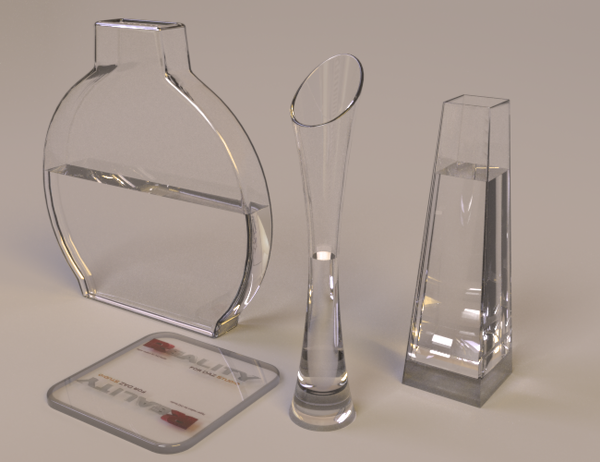

  • pcicconepciccone Posts: 661
    Not to push my own product but there is no better glass that what LuxRender does. All images were made using Reality for Studio.
    Cheers.

  • FirstBastionFirstBastion Posts: 8,074
    Cheers.
    great images Paolo, is there a reality plugin for DAZStudio 4.6 ? Since I moved from DS 3.1A I've missed having Reality as a render option.
    Absolutely. I released Reality 2.5 a while ago. It works great in Studio 4.6.
    Cheers.

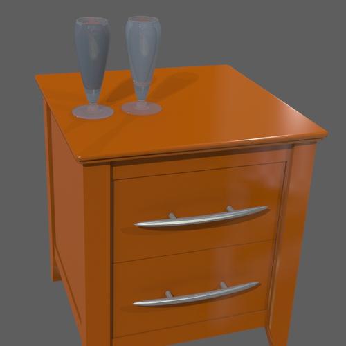

    I have lowered diffuse to 25% and ambient to 0%. but it also occurred to me that the refractive index might be too high (as most glass is actually more like 1.5, not 2.0). This may be what is giving the "over refracted" look
    Also, the problem with dialling opacity down to 5% is that the glasses don't cast shadows... Not sure what to do about that.
    Here is my latest attempt. Still not looking very natural... is the glass too thick?
    700 x 700 - 307K

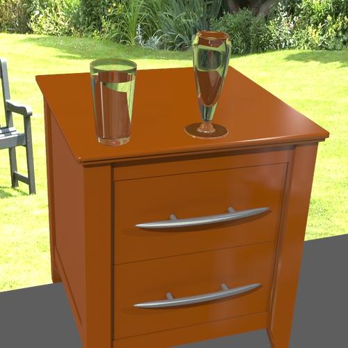

    Ok, I think the problem was the model, not the surfaces.
    I have applied the same surface settings to a different glass and it looks fine now
    (this is diffuse=0% by the way)
    Thanks for the help!
