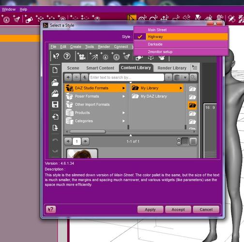

  • WendyLuvsCatzWendyLuvsCatz Posts: 41,798
    edited January 2014

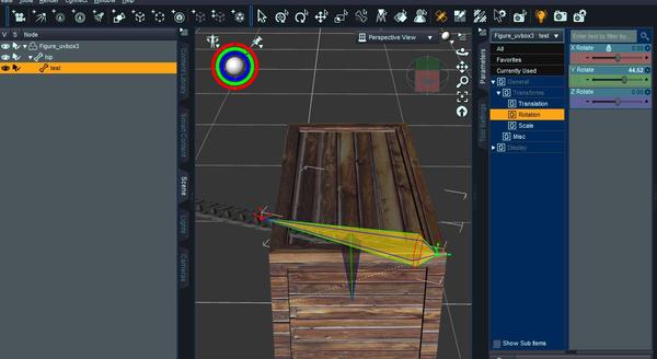

    are you using advanced style User Interface?
    458 x 302 - 43K
    712 x 707 - 140K
    1913 x 1035 - 485K

    About the interface, It IS set, it's the tabs it's showing.
    and I did saved it and I did almost everything I save as a Scene, scene subset & as figure/props, and nothing happened. I had to use the videos
    http://www.youtube.com/watch?v=8cV3VaC7eIs
    http://www.youtube.com/watch?v=rIIM1oAan7o
    There were ALREADY polygroups in there so I skipped step 2
    and the weight maps are absolute to 100%
    Post edited by mikey186 on

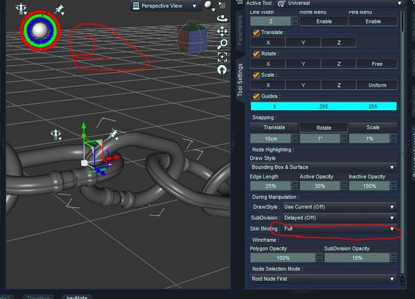

  • kitakoredazkitakoredaz Posts: 3,526
    I now retrun home from wrok ^^;
    then checked again your step in you tube. I do not feel any missing step , about your work.
    but I feel you use the 3d manipulation tool to rotate door rigs.
    and you have not locked the door bone x, or z ,rotation which have no weight,
    so that only node can easy move. then axis change.
    to avoid this problem, I may need to set parameter Locked about x and z rotation.
    and set them as hide property, and use limits Max 0, min .
    so that the bone never rotate to X and Z axis, how you tweak them..
    then,,DaremoK3 suggesiton is reasonable. I sometimes feel strange when move rigs,
    the defomation in 3d view.
    then need to change tool setting. see pic2.
    the skin binding property often cause problem as for me.
    But I do not remember which is right setting, but when change them, usually work well.
    878 x 632 - 95K
    1134 x 693 - 120K
    Then,, my suggestion is,, when check node and weight, with rotation,,
    you may better to change display setting .
    from parameter> Display>scene view. then change bone display.
    without it, at least I can not check rig start point, and ending point,
    and which direction node face at current^^;
    the weight mapped door rotate with rig local axis , and pivot point is the rig start point.
    to check them, I need to see bone status, at curernt.
    And one more possibility is simple gimbal lock problem.
    DS use Eular rotation, as you know, it sometimes cause this problem. ( rotaiton can not work as expected
    when I tweak rotation parameter, randomly again and again.)
    but I am not clever man, so that I can not tell you all. ^^;

    then I felt in your you tube,, if your door node direction, not follow the mesh direction
    after you color weight?
    Can you check your node positon , like my pic?
    I think it seems better to follow door mesh direction as same as node direction.
    when I see the boundary box of node(which I can see) it seems rotate 90 already,,
    1197 x 655 - 100K
