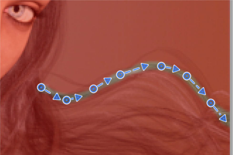

    The first tip I'll give you- if you want to animate hair, understand that if it overlays on top of an arm, you're going to have to be really nit-picky and mask out the arm so it doesn't flow off too. And, that's not hard!  The mask is just a click to select it, then you can do + and - to fine tune. Very, very easy. So I am tackling a more complicated one just to show you how it's done.

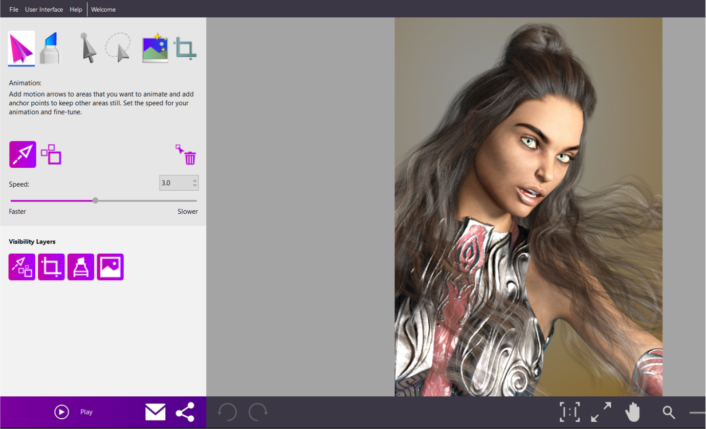

    I'm not going toreally re-invent the wheel as Corel's video shows you what the tools are, but that purple arrow is on by default and that's your animation tool "on." The purple square with the arrow inside it (directly below the huge purple arrow) is what you click to start drawing your lines. You draw in the direction you want the flow to go. TIP: Smaller arrows are more precise. Definitely use that where hair curves.

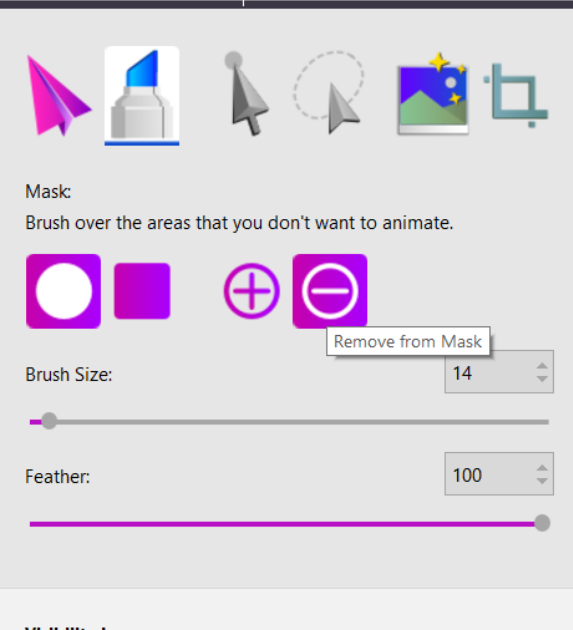

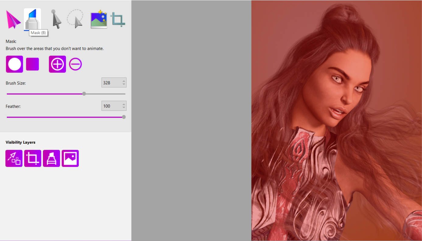

    I've tried several approaches, I like to select the mask tool (the marker, next to the purple arrow) and mask the entire image. You can make the brush size huge and it takes about two seconds to mask. Note the + and - directly above the brush size? We'll be using the - mask later to remove the mask from the hair strands you want to animate. Easy!

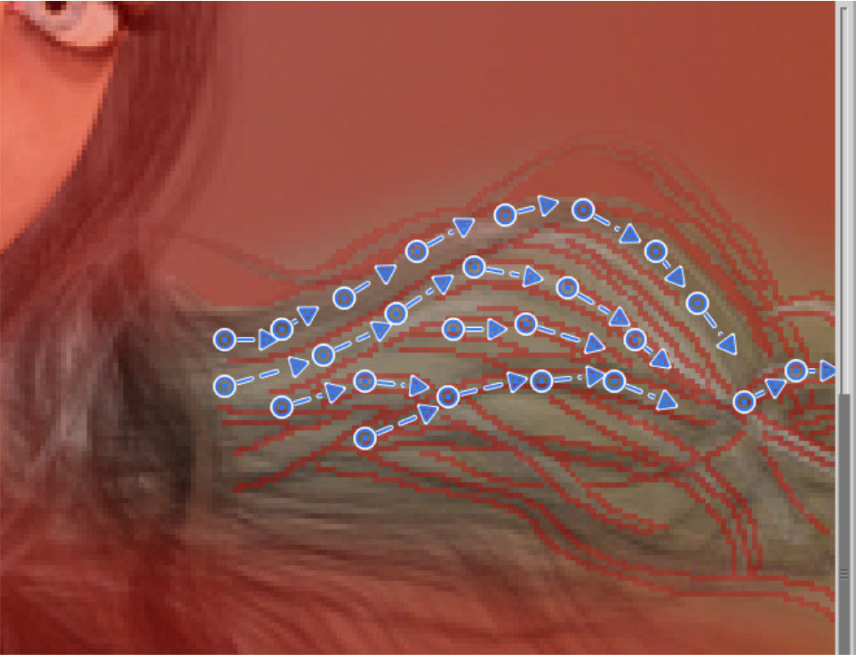

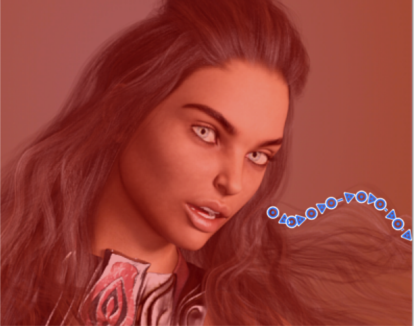

    Click on the purple arrow to leave masking, and you'll be in the Animation tool again. Draw lines in the direction you want the flow of motion. So mine start by her head and go out. I'm doing one strand to show you a technique I like. (First mask, then do animation lines. Yes, it's still masked.)
    Next, click on that marker (the mask tool, by the purple animation tool arrow) and reduce your brush size to about 14. We're going to use the - for the mask, and remove the mask that is directly on top of your animation lines. This makes for precise selection of the hair. See how easy this is? Mask everything, put in your animation lines, choose mask and the -, and remove the mask from the hair strand.
    If you remove too much of the mask, simply click the + (while still in the mask tool) and add the mask back in. You don't want the background moving!

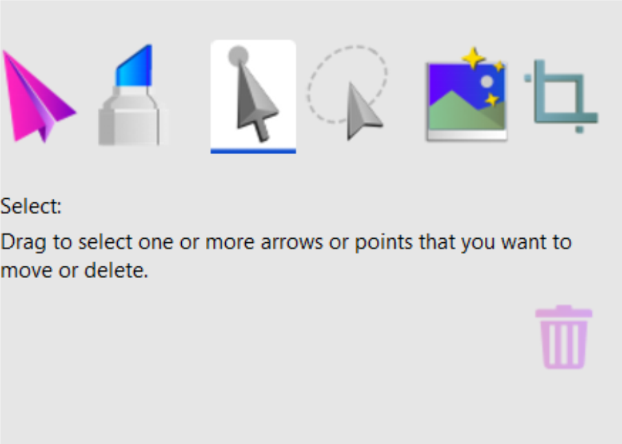

    TIP: Avoid crossing other strands going the opposite direction- aka horizontal instead of vertical, or you'll get a blob. I'm going to remove that very last animation line (closest to the bottom right corner.) See how that crosses other hair waving across horizontally? It's a mess when I animate it. So you select the Select Tool (K is the shortcut, will be handy to learn that one!)  which is the arrow with the dot at the tip,  and by clicking on the animation line on the render, and Delete, poof, away it goes.
    You can also mouse over the square that will appear over the line when you select it, and rotate the animation line. (Curved arrows appear at the corners.)
    You can also move the line when you see the plus sign, and pull a corner to enlarge the line,  like in other graphics programs.
    Then you rinse, repeat with other strands. You can click the PLAY button down at the bottom to check your animation at any time, Stop, and make changes. Have fun!
    As Corel videos show, you can also use anchor points to securely lodge an area so it doesn't move. If you are still having areas which are masked but they move, try adding an anchor point also. The anchor point is visible when you are in Animation (click the purple arrow) and it is on the second row, next to the purple box with the arrow in it. It's the box with two little boxes in the upper left corner. (Look at the next image which shows the anchor points, in red.)
