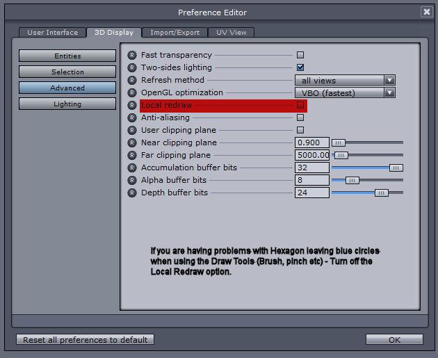

    Let's start with the typical "Turn Local Redraw Off" answer we give whenever there seems to be display issues in Hexagon.

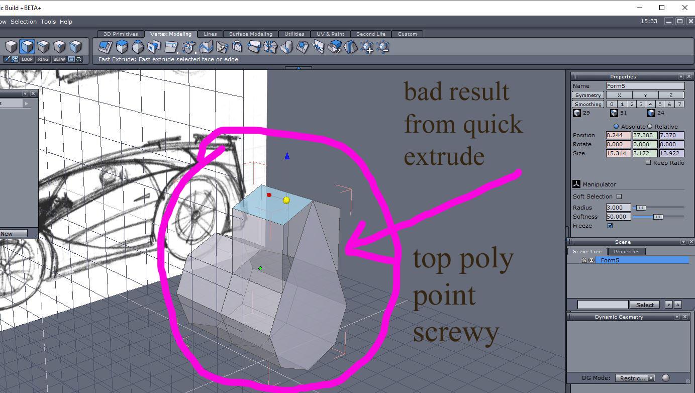

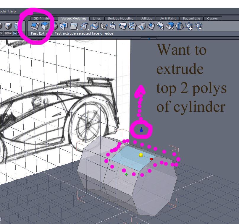

    New Problem - Quick Extrude Undesired Results
    I am having trouble extruding the top polygons of a cylinder.  I inserted a cylinder primitive, turned it sideways, selected the top two polygons, clicked quick extrude, and translated the top arrow upwards.  Unfortunately, the extrude didnt work the way I expected.  The top middle vertex remained welded.
    Thoughts?

    That is strange. I just tried several ways to force it to do that and I couldn't get it to make the same shape. It always kept the cap on the end and added faces. I tried all the different extrude options. I'm really not sure what's going on there.
  • de3ande3an Posts: 915
    I can't reproduce this either. However, there are a couple of peculiarities in the screen captures that you posted.
    1 - In the first image the red handle of the extrude widget is pointing toward the camera, and in the second image it is pointing away from the camera.
    2 - In the second image, the Scene Tree shows that your object is called "Form5". However, when I create a cylinder it gets labeled "Shape" instead of "Form".
    Perhaps a step by step description of how you are creating the initial cylinder to end up with it being labeled "Form" would be revealing.

    Mystery Problem with Unknown Solution - But Solved!
    No idea why it happened, or why it stopped happening.
    Thank you, JonnyRay and de3an for trying.  I guess sometimes you just have to close the program, turn off your computer, and go to sleep.  The next day, the probem will be gone.  Today, the tool works as expected.  Yay!
    Just in case this comes up again for someone else, I was following some Hexagon tutorials by Dreamlight.  Nothing to do with them except it explains why I was up to "form 5."  The first primitive I put in my scene is labeled "Shape."  The second I put in is labeled "Form."  I didn't close Hexagon between following the Genesis Cloth tutorial and the Concept Car tutorial, so my cylinder was not the first object I put in my scene.

  • AscaniaAscania Posts: 1,856
    Thoughts?
    The cap of the cylinder is not poperly welded to the sides. Weld it or remove it.

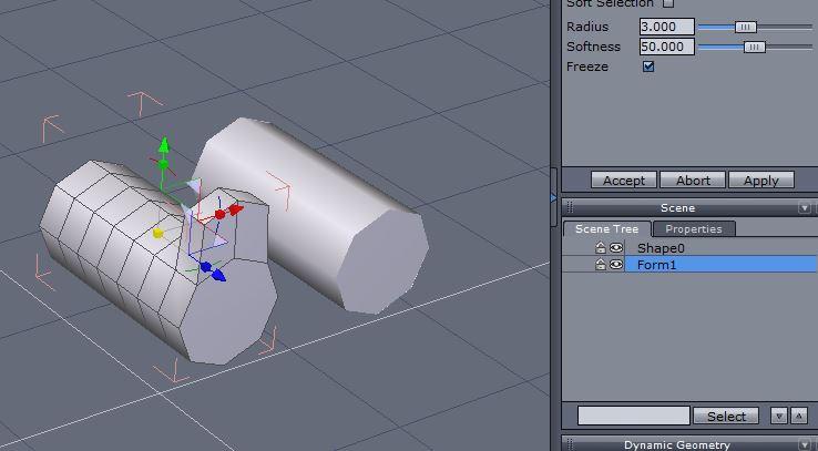

    edited October 2019
    Well, I'm glad it's working for you now. But it still doesn't explain how you managed to get a cylinder labeled as a "Form".
    No matter how many times I try, cylinders and cones are always labeled "Shape". All of the other primitives are labeled "Form".
    I still think that this is a clue to why your extrusion wasn't working as expected.
    2194 x 1368 - 325K
    Post edited by de3an on
    de3an said:
    Create a circle. Extrude it. You now have a cylinder named "Form".
  • StezzaStezza Posts: 9,212
    I just tried... my cylinder is named Form..
    the name changed from Shape to Form after the extrusion. cool
    How bizarre.  frown
    As you can see, mine retained the "Shape" designation after the extrusion.
    Difference between Mac and Windows versions?
    2958 x 2738 - 1M
    edited October 2019
    de3an said:
    How bizarre.  frown
    possibly... that's the only difference, I'm on windows
    738 x 407 - 42K
    Post edited by Stezza on
    If I use the "Fast Extrude" tool, the cylinder remains labeled as a "Shape".
    If I use the "Extrude Surface" tool, the cylinder changes to "Form".
    Go figure...

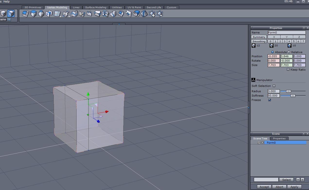

    Cursor Became Camera Control - Can't Manipulate Selections
    Don't know how I did this.  My mouse cursor adopted the shape of the selected camera controller at the bottom of the interface.  The arrows for the translate appear on my selection, but when I try to use the mouse to pull the arrows, the camera changes instead.
    1595 x 860 - 191K
    Post edited by Diomede on
    Just like the weird extrude problem, this issue was fixed by exiting Hexagon and then restarting, but I really don't want to have to do that so often.  angry
    Any idea of what caused it or how it can be fixed when it happens without exiting?
    Hitting the spacebar does it.
    The spacebar is supposed to hide and show the manipulator when using the manipulator mode.
    But if you're using the Zoom, Pan, or Rotate camera mode the manipulator should be hidden, but hitting the spacebar reveals it.
