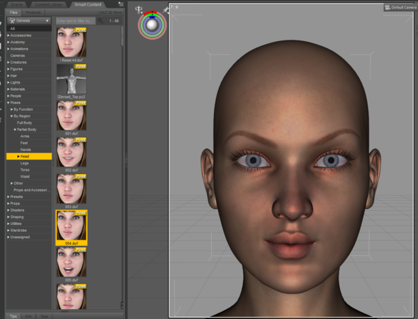

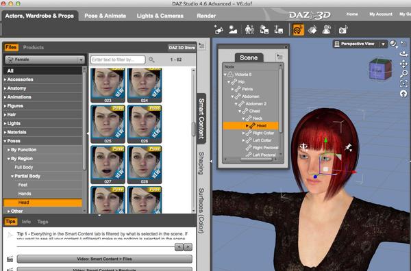

Hi,
I haven't used DS in a while, and in starting it up, I find that I can't pose the characters' faces. I load the characters, select faces, and the only parameters available are translations, rotations, scaling . . . there's no open mouth, frown, etc.
Similarly, I can't load facial expression poses from the poses library-- eg I click on them, to no effect on the character.
Would greatly appreciate a tip or two as to what might be going wrong. All content installed by the Daz Installer system
cheers,
Croc.
  • srieschsriesch Posts: 4,243
    Which figure specifically are you looking at, and in your library, what is the exact name of the content thumbnail you are trying to apply?
    I randomly choose Victoria 5, and I see if you go to the Parameters tab and click on Head (or on Pose Controls), I see morphs including "Mouth Open". There are other morphs found in the Shaping tab if you expand and click on Genesis > Head, for example.

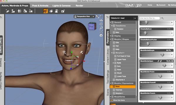

  • crocodiliancrocodilian Posts: 82
    edited January 2014
    Doing what I think is the same thing you're describing, also with V5 figure, I'm not seeing what you're seeing; I just see transforms, no morphs. When I use smartcontent tab to identify head poses which should fit the figure, and click on them, nothing happens.

  • JaderailJaderail Posts: 0
    edited January 2014
    In your TOP image you have the FACE Surface selected from the Surface Tab. That will not ADD the pose to the Figure, you should have either JUST the Figure selected in the Scene Tab and then ADD the Pose or the Head selected to DIAL the pose to use once it is injected if it does not auto pose the figure.

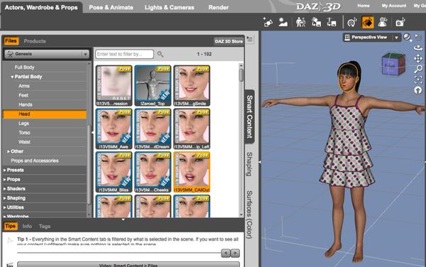

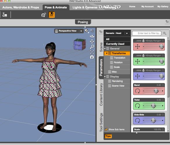

    edited January 2014
    OK, here I have the head selected, from the scene tab . . . I click on a head pose and nothing happens. I get the same result -- eg nothing-- when I select the whole figure.
    Full body poses work fine. Its just the expressions that doesn't work . . . and I don't see any manual controls for them either. Its as if their morphs (if such a concept applies to DS -- I'm more familiar with Poser) didn't get loaded.
    NB: I deleted V5 and reinstalled her, to see if that would make a difference-- it didn't.
    thank you all very much for helping out with this, btw . . . greatly appreciated!
    Croc
    Let me try the Mega Mood pack. It will be a bit as I'm rendering at this moment, I will test them as soon as possible.

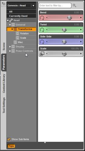

  • jestmartjestmart Posts: 4,449
    You may have a problem with the install of Genesis as there is no Pose Controls morphs visible with the head selected. The Pose Controls morphs are the base facial expression control morphs that are part of the base Genesis figure.

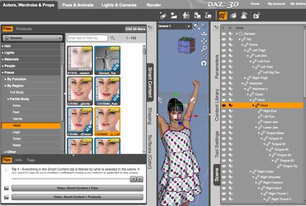

    edited January 2014
    mjc1016 said:
    You need to change your layout so you can have both the Scene pane and the Parameters open at the same time...that means you need one where they are on opposite sides of the screen.

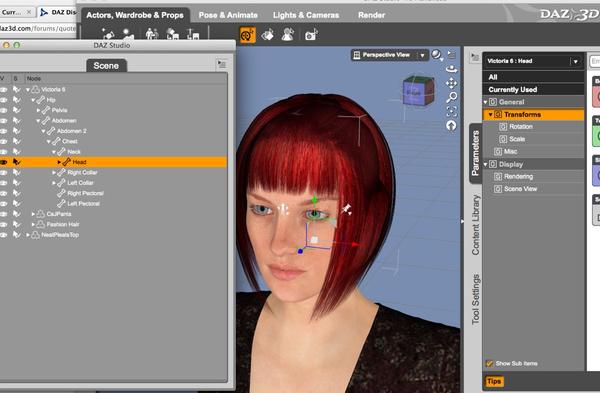

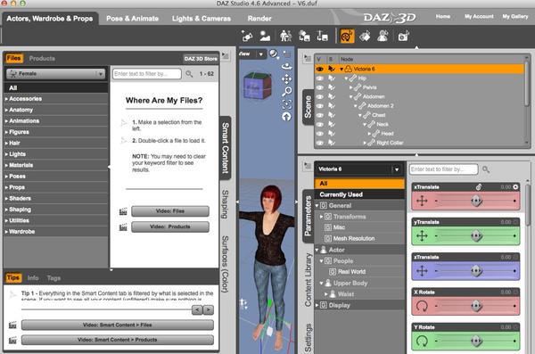

    Look at post #11 above. There I'm showing Vic 4.2. She's got all her facial morphs correctly loaded. I can manipulate the face either directly or through poses, no problem. So its not that I'm having problem selecting the head, or finding where the controls for it are-- there's no problem with this with V 4.2
    Now I've attached a shot where I have V6 loaded. I've got the Scene pane and the Parameters open as you suggest. The head is selected. I can't manipulate the head, nor can I apply facial expression poses.
    1200 x 791 - 152K
    1200 x 786 - 110K
    Post edited by crocodilian on
    Crocodilian's second image does show that the head is selected and it is that image that prompted my response. My screen shot shows the Pose Controls morphs that are part of the base Genesis figure, Genesis needs to be re-installed.

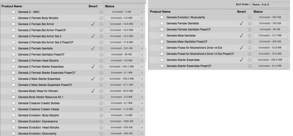

    When installing or re-installing content be aware that DIM is dimwitted, be sure that the location (or locations) it installs content to is a location mapped in Studio's Content Directory Manager.
    459 x 753 - 70K
    551 x 645 - 83K
    edited January 2014
    When installing or re-installing content be aware that DIM is dimwitted, be sure that the location (or locations) it installs content to is a location mapped in Studio’s Content Directory Manager.
    I think you're right . . . I've attached a screengrab from my DIM (filter "Genesis") which files would you reinstall? Very good point about the DIM. Will give this a careful look over . . .

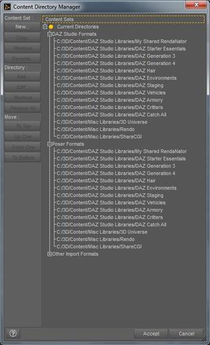

    Crocodilian,
    Based on what you're saying, I'd definitely suggest making sure your install paths are where they should be, and I might even go so far as to suggest reinstalling the entire library. Not an IDEAL solution, but a nuke-and-pave might be the best bet at this point. I had to do it once. It sucked. But it fixed the issue.
    Attached is what I was hoping you'd find. I am not sorry for the psuedo-Miley behavior of Ms. Six, there. Had to do something to show what it could do.
    Thank you -- and everyone else who pitched in here.
    The files are installed -- or DIM says they are anyway-- but stuff that's installed in the wrong place is as good as "not installed", and "nuke and pave" as you suggest makes the most sense.

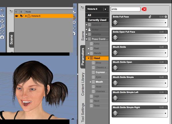

  • AntaraAntara Posts: 444
    I am having the same problem: No expression morphs. (I can see plenty of other morphs)
    I have everything installed.
    (I can even find the morphs dsf files I am looking for in Content\data\DAZ 3D\Genesis\Base\Morphs\DAZ 3D\Base folder. And this Content folder IS listed in Edit->Preferences->Content Library->Content Directory Manager...)
    But DS refuses to see those. How is this problem fixed?
  • TotteTotte Posts: 15,115
    You did select the head and the looked in Parameters Pose Controls->Head->Expressions ?
    Totte, thank you!
    I was searching the sidebar for substrings such as "smile" and not finding anything. Pose controls did have them, though! Thank you!
