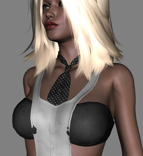

I got this outfit a while back when I got the Stephanie Pro Bundle, and am trying to use it for the first time.
The outfit works fine on V4 and Stephanie 4, as long as their breasts are small, but as soon I as increase the size a bit I get poke through of the "bra", I tried using increasing smoothing iterations, that made it worse!
Is there a fix for this that I am just missing?

If the 'vest' thing is a separate clothing item from the 'bra' add a geometry shell of the figure and set the offset so it is just above the 'bra'. Change the Smooth Modifier on the 'vest' to the shell instead of the figure.

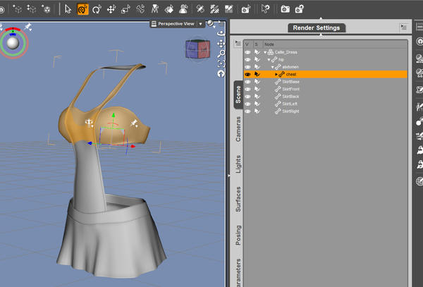

The top is one piece, though you can get rid of the vest or the bra, but they don't seem to be separately adjustable beyond that. Because it is reading as "one" I can't set the collision for the bra, instead of V4, if that makes sense?

This may be one of the few items where smoothing modifiers make things worse...and using the built in morphs is going to be the only way to use it...
Ideally, it would be best if it was two separate pieces, but you can load two copies of it (this so you have full control over all the options...instances and geo-shells are only giving you 'half' the control for each), on the first copy, you set the 'white' parts invisible, leaving the bra. The other is the opposite. Then you fit the one with the invisible everything else to your model...and the other one is fit to that one.

Yes the problem with layered clothing like this and the Smooth Modifier is it is a collision calculation, so the top layer of the clothing gets passed through the lower layer(s) in order to 'colliding' with figure
That's why separate pieces are better..you stack them so the top lay is colliding with the layer beneath it and so on....
