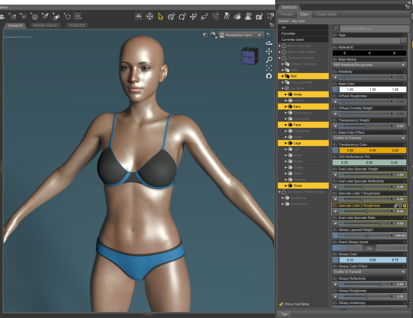

    Like @y3kman said, try the Dual Lobe Specular surface settings.  Works fine.
    If Dual Lobe Specular Weight is 0, increase the value and the other Dual Lobe controls will appear.
    Here's an example, G8F base with Anagenesis 2.  Note that Base Mixing has been changed to PBR Metallicity/Roughness, otherwise you'll get a rather metallic look (yes, sounds odd).

    You must set Base Mixing to PBR Metallicity/Roughness to see the Lobe Roughness controls.  Then set Base Bump to 5 or a little more (I've used 5 here).  But lighting matters a lot too, I'm using some different lights here, IDG Gradient Lights (Lights 416), which was a 2018 Christmas freebie so maybe you have them.
    1416 x 1028 - 743K

    Thanks again @Taooz for the hint to change base mixing to PBR Metallicity/Roughness. Now that I have the options for glossy roughness and glossy reflectivity I can use the tutorial posted by magog.
    I had to reduce glossy roughness from 0.4 to 0.25 because the skin looked too shiny and also got very red. I reduced the redness by reducing the translucency weight from 0.5 to 0.2.
    Attached is the result. I think it's the best until now. Any hints for improvement are appreciated.

    I was only using this as an example.Making a better more water like normal map takes time.
    Thanks. But it seems to be good enough.
