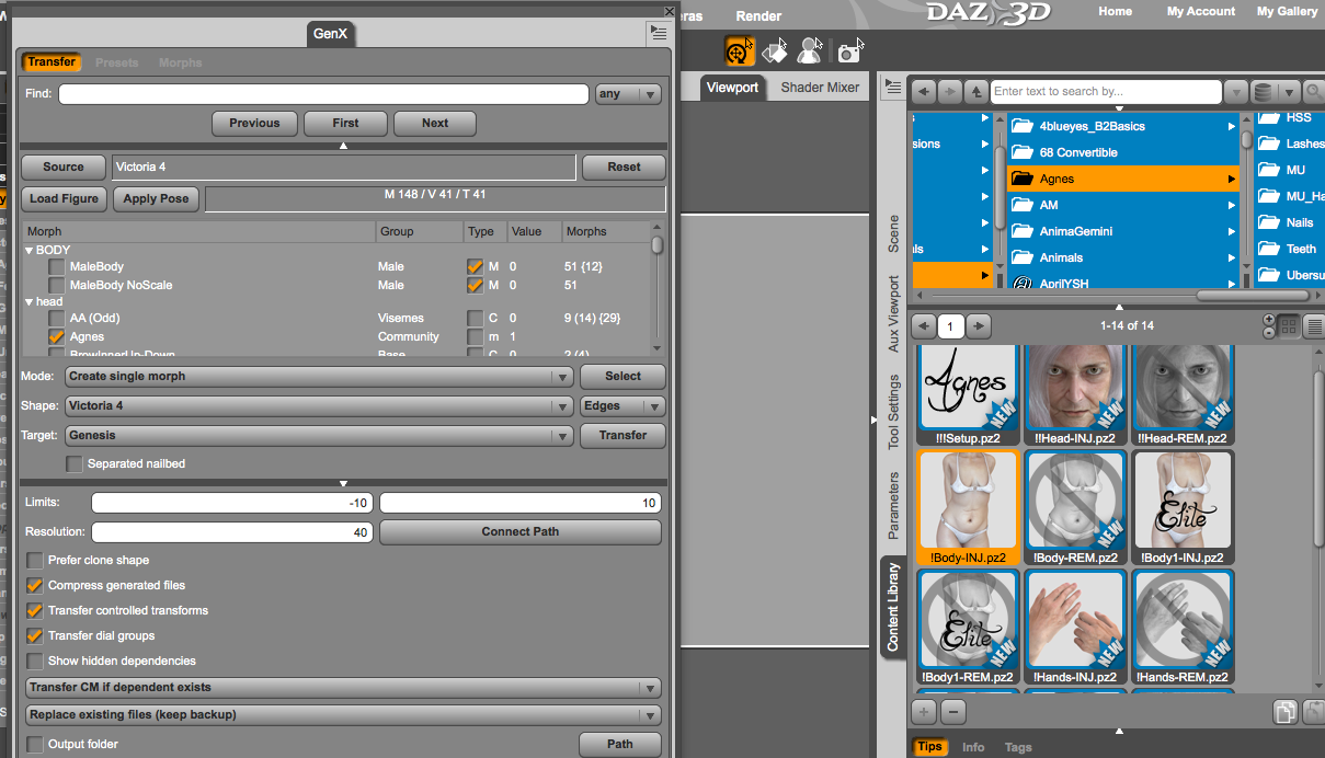

    Need a bit of advice here...I've successfully managed to transfer a number of M4 and V4 characters to Genesis, but a great number of body inject morphs are ignored by GenX. I've tried dropping the inject morphs on the GenX pane, tried using the load button and browsing to the pose folder and selecting the body morph, tried injecting the morphs into V4 base character and using the select from character in scene, and the result is always the same. (See screen shot) The head inject morph works, but the body morph is ignored. Any idea what I am doing wrong?

  • HavosHavos Posts: 5,674
    I am pretty sure I transferred Agnes for V4 once.
    What I do is load v4 and using the power loader inject all the morphs into her. I then export this as a CR2, and use this CR2 file as the source figure for GenX
    I then use Apply Pose button to add the head and/or body morph. Then use select all values with non-zero values, and finally click Transfer.
