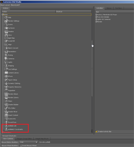

  • Takeo.KenseiTakeo.Kensei Posts: 1,303
    Check in your Action Pane if you have the Animate entry in it. For that, open your DS Customization menu with F3 then Search for Pane, open it and scroll to see if you find it
    911 x 998 - 49K

    Takeo,
    Thanks, but aniMate isn't showing up there either.

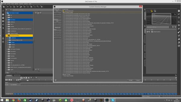

  • KeironKeiron Posts: 419
    edited April 2015
    Simular issue here
    Animate 2 time line is there
    Animate and Animate 2 blocks loaded
    Animate 2 Plug in is green and active
    When looking for installed blocks using the arrow down button None show up in window
    i have downloaded daz Studio 4.7
    uninstalled and reinstalled
    unistalled blocks and reinstalled
    no luck
