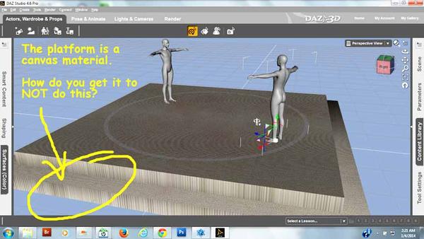

Now another problem I'm having has to do with texturing, maybe I should start a whole new thread or someone can help. Does anyone know any good tutorials on how to get the UV to map right? This is the problem I'm having.
An Ex Hexagon user called Gary Miller did some great tutorials, here are the links to a tree stump project which will help you sort out the texture problem.
Step 1- http://www.youtube.com/watch?v=MTXdEJOFp5c#t=25
Step 2 - http://www.youtube.com/watch?v=QSkrjrN__Lg#t=12
Step 3- http://www.youtube.com/watch?v=EpF2R7l9ewA
Other video tutorials by Gary can be found at GeekAtPlay.com.
To find your way around Hexagon I recommend watching Daniel's Intro set -
http://daniel-ripley.co.uk/hexagon.html
