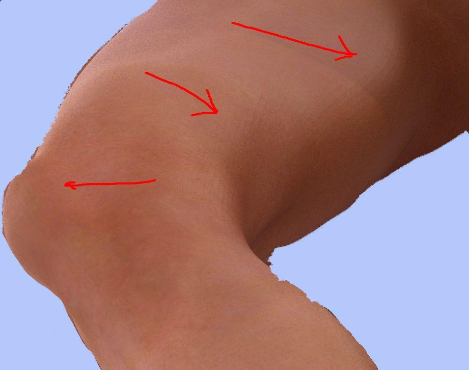

I been using mitchell filter for ages now, as it's usually more crisp and details pop a bit better. Lately, I been getting some artifacting using it, not sure if there is a technical term for it, but I am seeing the polygons on figures. Subd is at 2 like I normally set it. Never used to get that issue before, anyone else seeing this?
921 x 726 - 52K

    I rarely use DOF, just double checked, and sure enough it was off. The focal plane was about there, so I moved it farther back to rerender, see if anything changes. It shouldn't have any effect since DOF off, but who knows lol. The render is looking fine at first, when it's all grainy, I come back to it like 2 hours later, it's no longer grainy, but the polygons are showing.
    OK, no good, polys still showing. Hmmm, I am using a different fancy camera, I will try getting about the same view with a regular old camera, see if that is the issue.

    Oh 3DL, I am using Iray, and gaussian filter still got it too, this is odd. Only other thing I can think of is the candles I am using for lighting, gonna pop in some regular lights and see if it's still there.
  • TheKDTheKD Posts: 2,711
    Ok, totally strange, it actually was the candles with the emissive flames that were causing it. Set up spotlights, colored them warm, approximated them from where the flames were to give off the same feeling lighting, and the polygons are gone.

    Glad to hear you found a workaround:) Still, that shouldn't happen, maybe filing a ticket wouldn't hurt;)
    edited August 2019
    Once this render finishes, I am going to see if I can reproduce it again in a fresh scene with the same candles reloaded. 1070 is kinda slow at rendering indoor stuff :(
    Well damn, I have not been able to replicate the bug in a fresh scene  @.@
