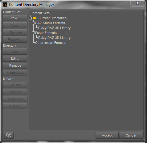

Your Content folder can be any place you like. All you need to do is tell DAZ Studio where it is. Here is mine...
