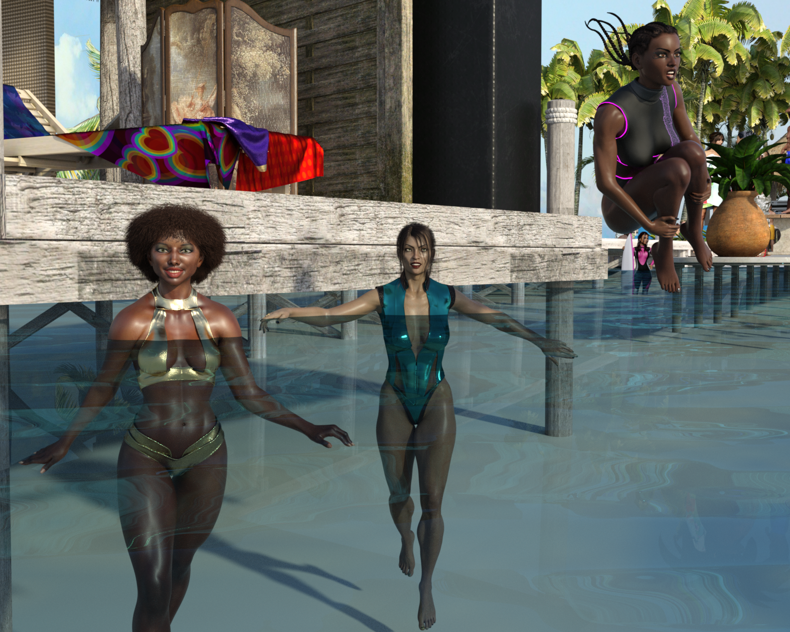

    Thank you.  Yes, I used some tips from that discussion as well as some videos I found on YouTube.  So I managed to do what I wanted to do here:
    All the towels and clothing piled on the lounge chair on the deck.  However, I found it doesn't work with all items and in some cases the clothing item just explodes.

    Can those dForce Laundry items be also worn?   In the case above, I wanted to use recognizable items that the models were wearing and naturally since they change clothing very quickly in a short period of time, there would amass a pile of clothing on the changing room (or area in this case) furniture.  But then I ran into the problem that many items didn't take a liking to being dForce simulated while not on a body.  There were other issues too with the waistband not collapsing as the clothing item came to a rest on the surface.   So more than half of the outfits just didn't work, some I had to modify to work.  In the end I figured just creating simple beach towels would work.  These were fairly easy to do as I just had to create a plane primative, add a texture and set the dForce dynamic modifier to it and presto!  I had a beach blanket that conformed to the shape of the furniture I put it on.
