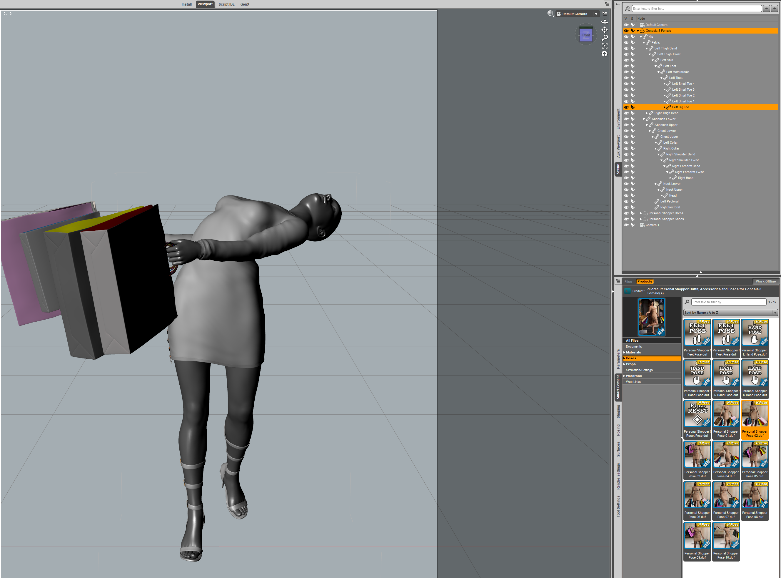

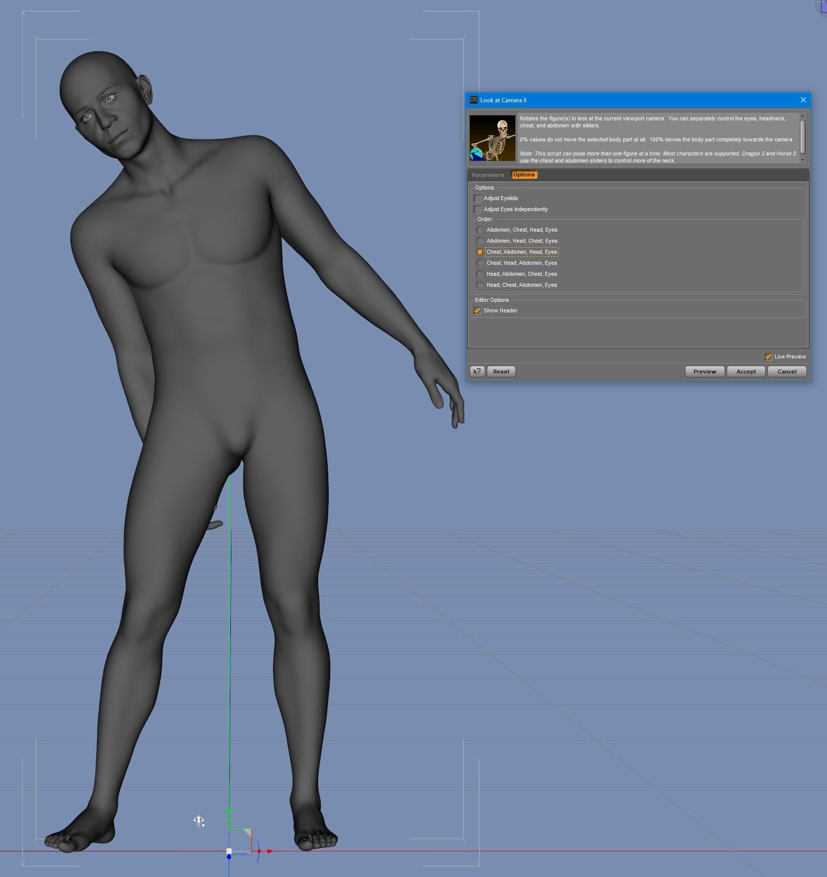

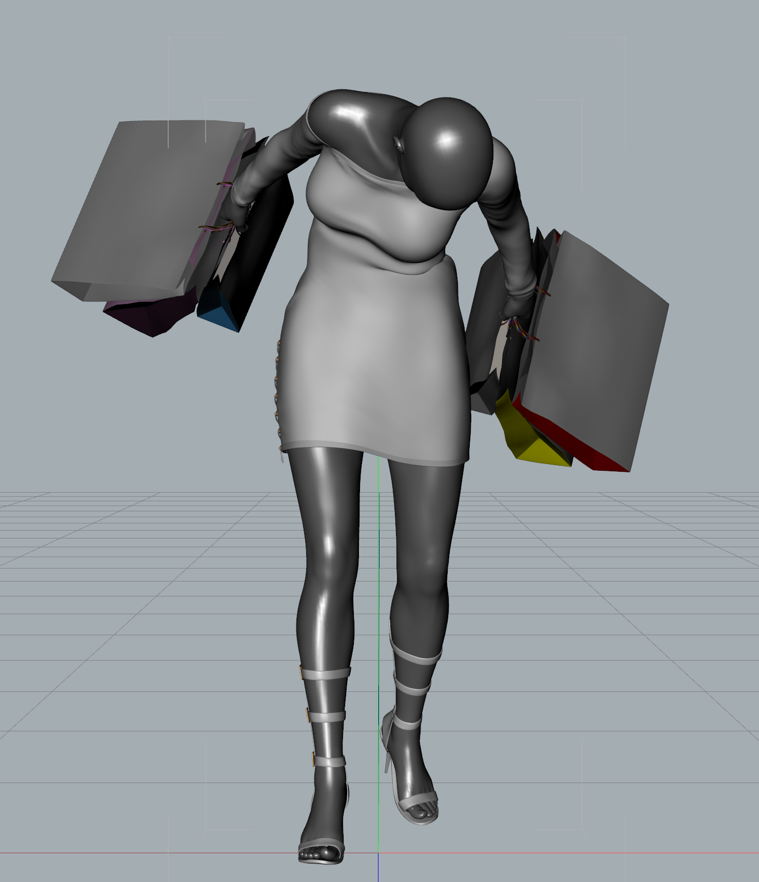

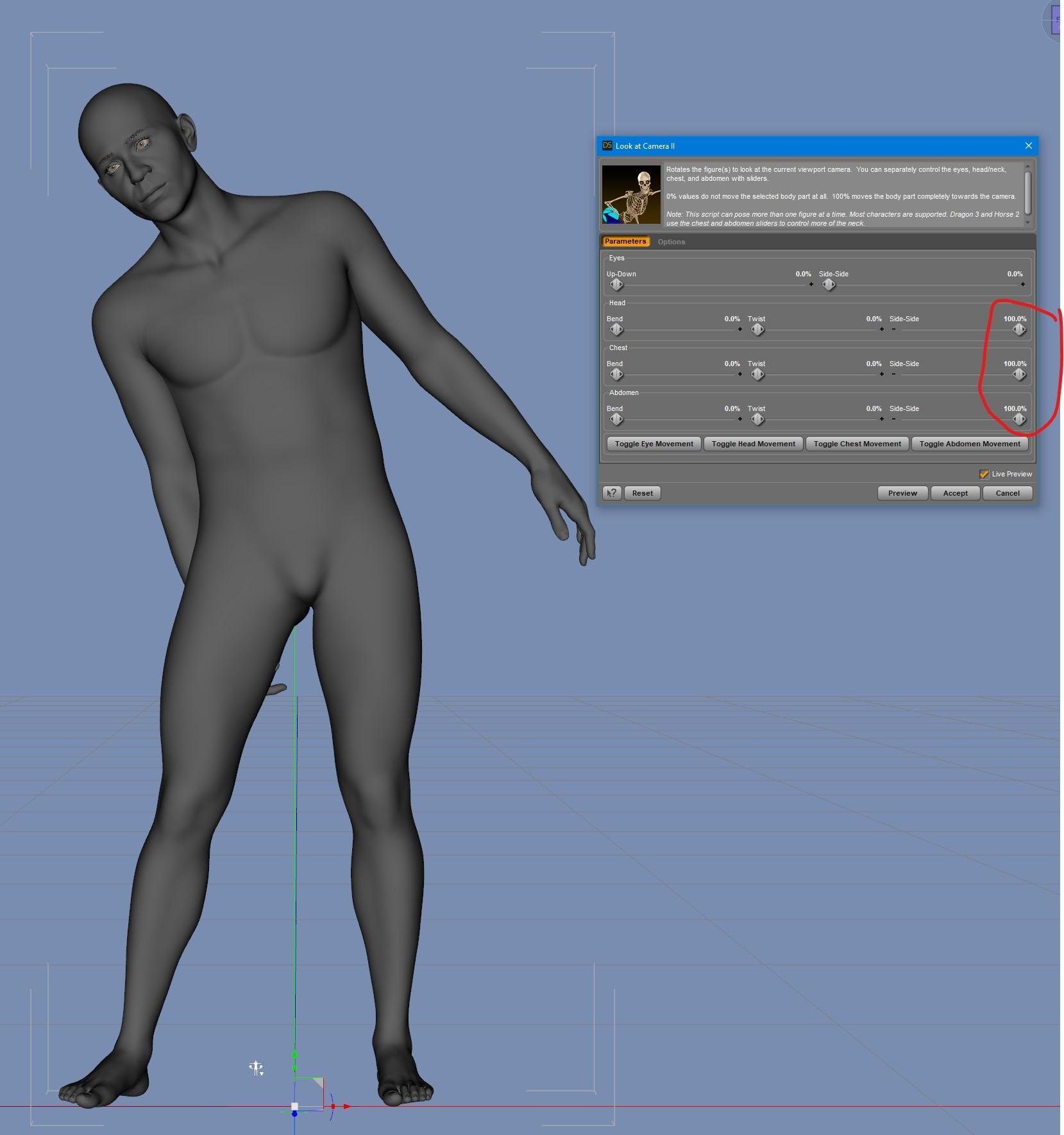

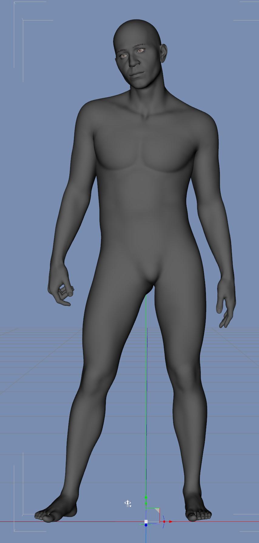

    I have never been able to make any sense out of the way Side-Side works for anything other than the head and eyes. The issue is not new to G9 or the recent update. This issue has been around "forever". Here is an example. Why does G9M chest and abdomen bend move in the opposite direction of the head movement? Depending on the order selected in the Options tab, this unexpected direction of the Side-Side movement can be more or less exaggerated. Can you please explain the logic behind this, or is it a long-standing bug?
    Starting Pose
    Ending Pose after using Look At Camera II
    854 x 1792 - 105K
    1659 x 1770 - 235K
    1648 x 1749 - 213K
    Post edited by barbult on
    Starting Pose
    It is because it uses the same math on the transformations for all the bones it affects and for all figure types.  I did not want to fall into a rabbit hole of coding exceptions for different figure types in different situations (for example, starting from the default pose on my system makes the figure lean towards the camera).
  • barbultbarbult Posts: 27,602
    Maybe I just simply don't understand what it means to "lean toward the camera". If the camera is off to the character's left side, should Side-Side make the character lean to his left or his right? Should the height of the camera have any impact on the direction the character leans for the Side-Side control? Or is it all too complicated to get into here?
    Is it expected that it takes 5 seconds for the script window to appear after activating it now, or is something wrong with my install? It used to come up almost instantly.
    Thanks for all the support you give us in all these form threads. I don't know how you can keep track of the details of all the products you have created!
  • RiverSoft ArtRiverSoft Art Posts: 6,975
    edited November 2022
    Quite honestly, I used the same calculations that worked for the head/neck (which looked really good) for the torso (which also works really well except sometimes for the side-side) smiley
