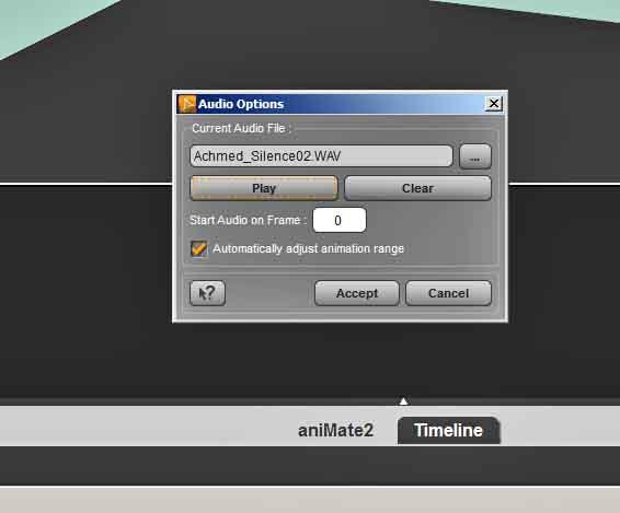

    You load a .wav file in edit->audio.
    Normally this would be a file you want to use for lipsync purpose. Just what I did in the picture.
    If I click play in the pop-up window I hear the sound file, if I click play in the animation timeline, I hear the sound file and see whatever animation. I have added.

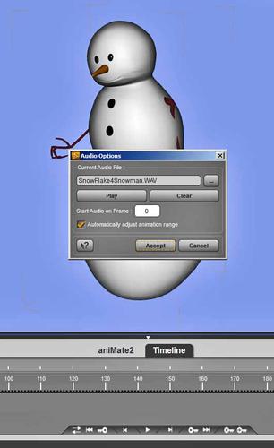

    I tried to reproduce your problem, but I can't.
    When loading a sound file, you can only load .wav files.
    Without having the timeline opened and even without officially 'loading' the sound file you can play it.
    I even tried to load a music file of 127Mb. with no problem.
    I hope you do understand there is no such thing as a lip sinc wav file ?
