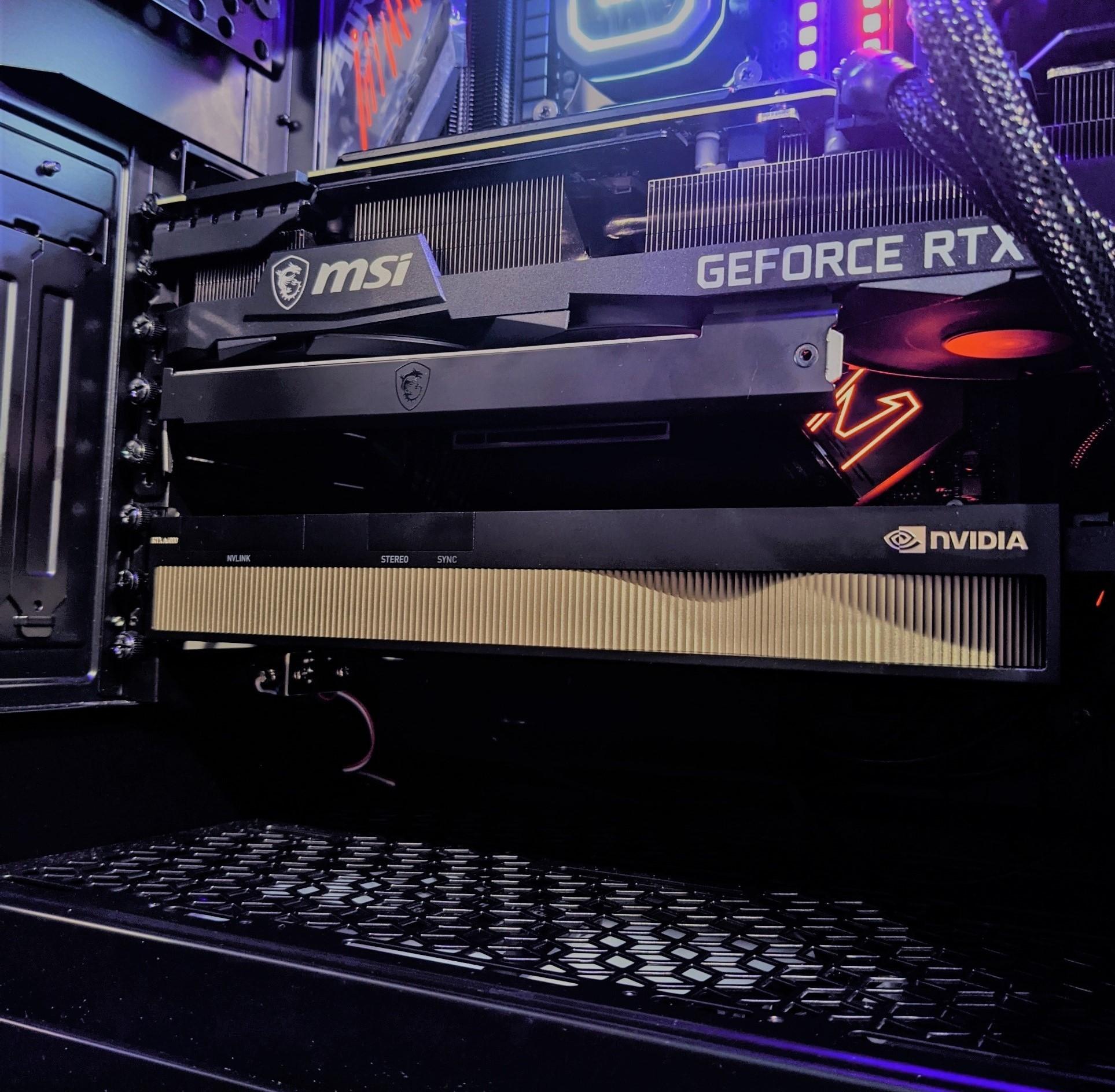

    Quick sanity check - per this guide from Puget I procured a pair of the Quadro NVLink bridges to test dual SLI/NVlink on my render server.. that is, 2 pairs of 2080ti's.
    But it certainly seems like that guide correct, and even with the newest 451.48 drivers, SLI is only being able to activated on one pair of cards.
    Has anyone seen any hacks/info on getting two pairs to work in Windows?  At the moment the options are either older drivers or Linux.
  • RayDAntRayDAnt Posts: 1,171
    Hm... I have a vague remembrance reading somewhere that in order for 2+ Nvidia cards to function properly in a vram sharing mode, PCI-E lane topology from each of x16 slot used needs to be direct to CPU via the same identical chipset path. Are you sure your current motherboard actually lives up to the task? (merely having 4+ physical full bandwidth x16 slots on the board is only half the battle.) This is one of those areas where proper hardware documentation tends to be extremely lacking. Just check out the troubleshooting stage of any LinusTechTips project video series dealing with a 4+ GPU setup project and you should see what I mean.

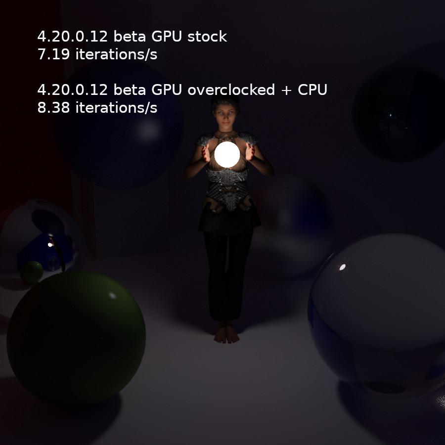

  • So my only question is are we running benchmarks only at stock speeds or can we push the overclocks to squeeze some performance out?
    Stock speed has little meaning when almost every GPU has a different one. That why we ask people to list specs. Some people have mentioned they overclocked. If you want to overclock, go for it, just mention that you do it. Also, overclocking for Iray is not super recommended given the long periods you may be running a render which pushes GPUs 100% nonstop. You do so at your own risk. I would not do an aggressive OC.
  • Stock speed has little meaning when almost every GPU has a different one. That why we ask people to list specs. Some people have mentioned they overclocked. If you want to overclock, go for it, just mention that you do it. Also, overclocking for Iray is not super recommended given the long periods you may be running a render which pushes GPUs 100% nonstop. You do so at your own risk. I would not do an aggressive OC.
    Thats good to know, I was thinking of running a watercooled GPU and CPU to use overclocks but if its not recommended then I will just save the money that watercooling adds and drop it in somewhere else.
    If you water cool then that would be better. But for me personally, I don't think trying to push overclocking for Iray is a good idea. Maybe others would disagree. Iray is quite different from gaming. On one hand, some games are actually more demanding than Iray. Like if I run 3DMark, my temps will exceed what they do for Iray. Also if you run demanding games at high refresh rates, like 120+, this can push things up, too. That is because how games work, they constantly refresh VRAM, and that is something that Iray does not do. Iray loads the scene once, and that is it. That is why the entire scene must fit in VRAM for Iray. But Iray still runs the GPU processor at 100% and depending on your scene, it can run for a long time. Most games will have periods where they ramp up or down, but Iray does not, it runs full throttle the entire duration of the render.
    So cooling is important. I am not saying you must water cool, I don't, and I have two 1080tis which will be warmer than a single card. But I have a good case for airflow and I use MSI Afterburner to control fan speeds to run faster than stock. This keeps temps under control for me. And when I game, I only use one card. Water cooling can be great, but it can be a hassle...you wouldn't want to spring a leak. <.<
    I have overclocked a little, but only a little. The performance gains are minor in the scope of things. A good card that is already factory overclocked and has a good cooler is probably fine.

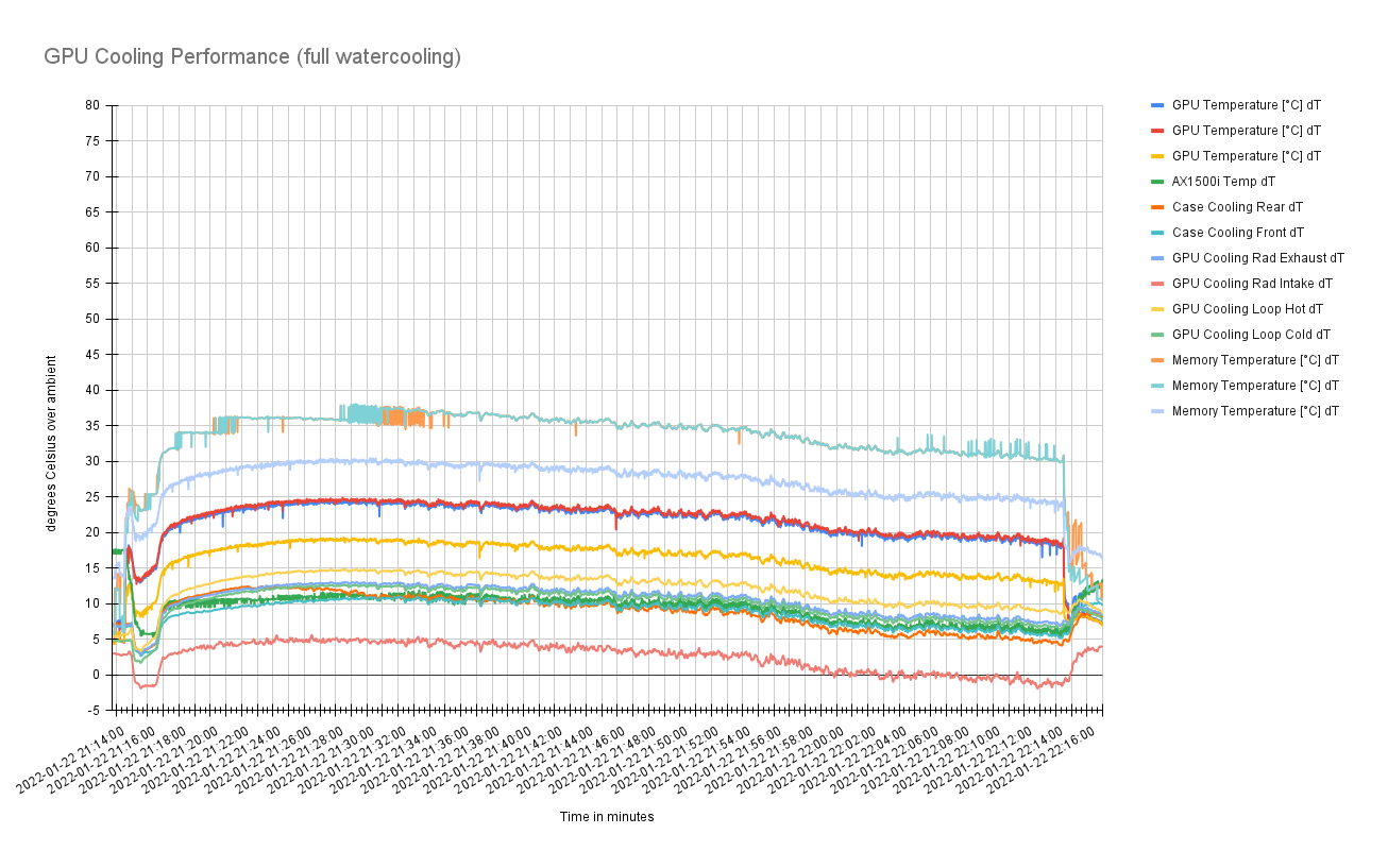

  • TheKDTheKD Posts: 2,711
    One of the biggest reasons not to overvolt GPU without watercooling is they have built in throttles. So once the temp starts going up, the performance will start dropping due to it throttling itself.
  • tj_1ca9500btj_1ca9500b Posts: 2,057
    edited July 2020
    I actually 'undervolt' my GPU for this very reason.  Some graphics card companies build in 'factory overclocks' to push the silicon to it's limits, which pushes the card closer to the throttle limits.  In my case, I run the card at about 70% of the aftermarket card's 'default' voltage, which helps drop my temps while not giving up any appreciable performance.  Incidentally, this drops the voltage to close to the same 'spec' as the reference cards. For shorter renders, yes my renders might be a bit slower, but a lot of my renders can take up to an hour, more than long enough for the thermal throttling to rear it's ugly head.  Plus my case layout and ambient temp situations are a bit less than ideal, so the card will heat up a bit more to begin with...

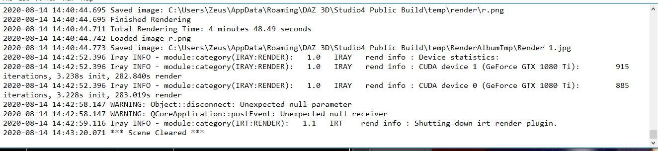

    How do I find the exact model info? !!! I just crawled under the desk and can clearly see for the 1080 machine they differ. I am going to go get a camera and take a pic and post it.
    But I have these screenshot here re rendering. I actually tried rendering in 4.11.0.366 Beta with the 1080's and after 7 minutes slugging away at 2% I bailed.
    Slugging away with old driver
    Frustrated I updated the NVidia Driver driver and got this result on the 4.11.0.366
    After Driver Update
    Been testing the newsest 4.12.2.6 so I'll have to try another test tomorrow on the 1080ti's  but first I'm taking the side off the case or maybe grab a pic through the glass side..
    1488 x 1013 - 144K
    1324 x 304 - 113K
