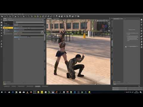

  • Hi guys, I went out of town for the weekend.
    I'll be reviewing everyone's posts here shortly, see if I can speed things up.
    I was heavy into DAZ 10-15 years ago and just recently picked it up again with my daughter. Had a 1060 w/3gb a month ago and we couldn't stand the speed. Picked the dual 2080ti cards up and it was a big enough difference that I guess I didn't realize it could get even faster. Nice to know!
  • OK, read through, watched that guys video. I certainly didn't have the hardware optimization set. In the end... it didn't do much.
    I went back and watched my earlier video and realized what you are seeing is me attempting to finely rotate the scene. Now that I understand what you really want is SPEED, like major movement, I did another video. Let me know if this helps:
    https://streamable.com/r4zye
    FWIW, I dunno that the 2nd card helps much on viewport, but for final render, it's great. I tested single and dual on that. With a single card, I'm high 40s if I remember, with both I am mid 20s. So not quite double speed but a good difference. I went double in hopes of Iray 2019.1.xxx being added hopefully in daz4.12, I'm hoping it really takes NVLINK into account and allows me to share memory across the cards for crazy textures.
    ebergerly, i'll review your post history and see what other tweaks i can make.

  • AelfinMaegikAelfinMaegik Posts: 47
    edited July 2019
    ebergerly said:
    Here they are:
    1. Render Settings/General/Auto Headlamp = Never
    2. Draw Settings/Drawing/Response Threshold (msec) = 5000
    3. Draw Settings/Drawing/Inactive Viewport Delay = Off
    4. Edit/Preferences/Interface/Display Optimization = Best
    5. Use Perspective View when manipulating, since any Camera view is generally much slower, especially if you have a light parented to the camera like a headlamp
    6. Avoid using "Point At" if you want your character's eyes to point at the camera. That will slow the camera view manipulation a lot.
    Aye, found that. Again, not doing much. Then again, not a seriously complicated scene. I'll try throwing out some crazy environmental geometry, see if it makes a difference.
    Thanks for the info, certainly not hurting anything so I'll keep them as my scenes get more and more complicated.
    Post edited by AelfinMaegik on

    I went ahead and took it back down to 150, I think that was default?
    I think I made a more complicated scene, not sure, still pretty new to Iray in general and getting used to changes in Daz from 15 years ago. I do wish I could sometimes get it to stop highlighting things in yellow when I am manipulating the scene but not sure how. Hope this helps, I'd certainly be willing to try other suggestions, I'm (re)learning as I play around, too.
    https://streamable.com/cukhf

  • Takeo, I hope this is what you asked for. If not, I apologize; as I've mentioned, a bit new to this still.
    I've made this video with two genesis 8 figures and an HDRI light. Both figures have hair and clothes. I believe I set the settings you asked for, you can watch the video and see the render and draw settings. I'm still not really sure what Response Threshold affects, you can see me change it from 5000 down to 500 in the video. I went ahead and also swapped between dual 2080ti to single to see how it would affect things (not much).
    https://streamable.com/nmfuo
    Side note: don't mean to badmouth artists, but this might be the last time I ever use Vinnuth Kriegor Battle Mega Armor. I can't believe the author didn't include some presets to apply mats. That was insanely more work than I expected.
