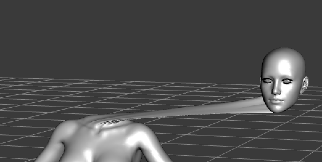

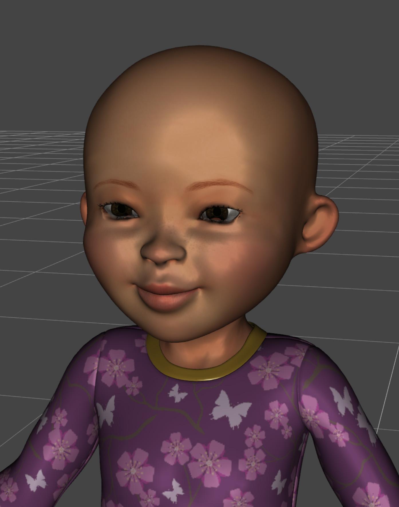

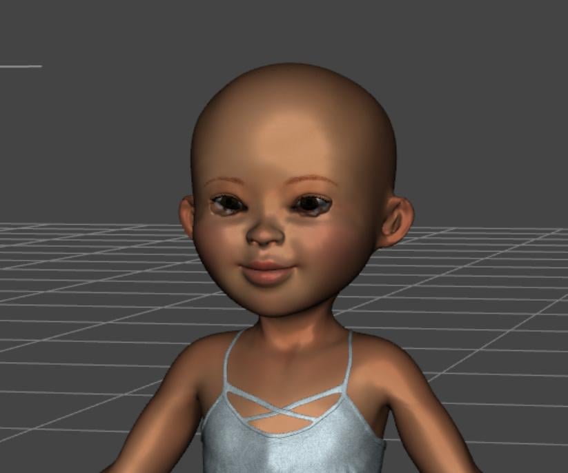

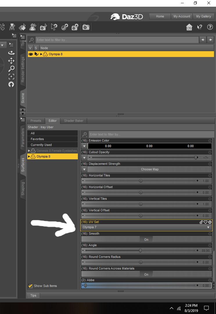

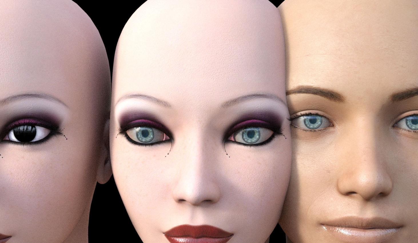

    I tried upping the tolerance to help fix my wonky eye issue and it still doesn't seem to help. Is that the direction I should be going or is there something else I'm doing wrong? I wouldn't really have considered her an "extreme" character.
    2257 x 1258 - 218K
    Post edited by MelissaGT on

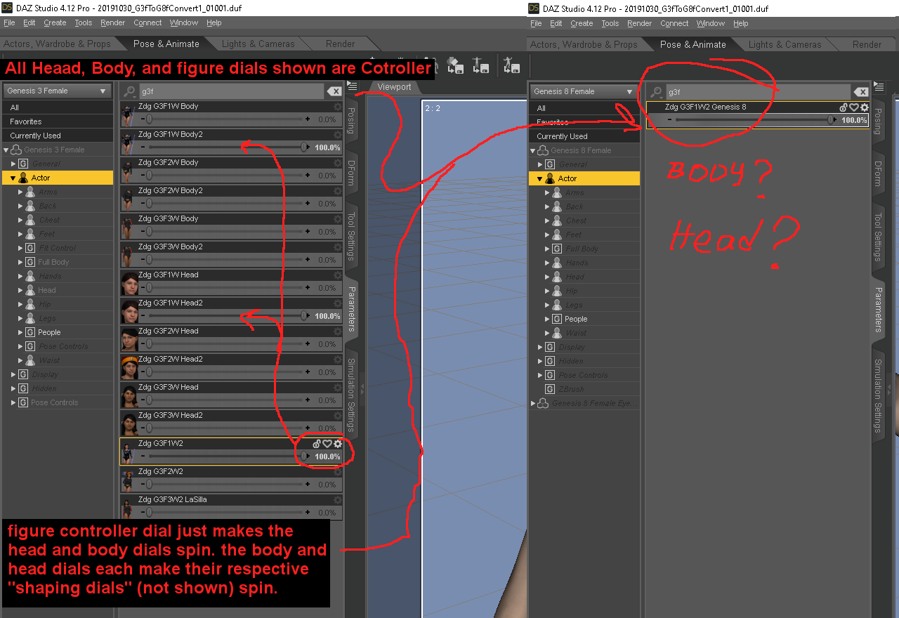

    I converted a character in scene, ie a character dial spun using lots of different dials, characters and morphs, not everything seems to have transferrred, the head of one character transfered but not the body.
    Also and this is a problem for me, I can not autofit clothing  from genesis 2 or 3 (didn't try the original) when trying the box pops up but the ''What Type of Item It Is'' box is greyed out - is this expected behaviour?

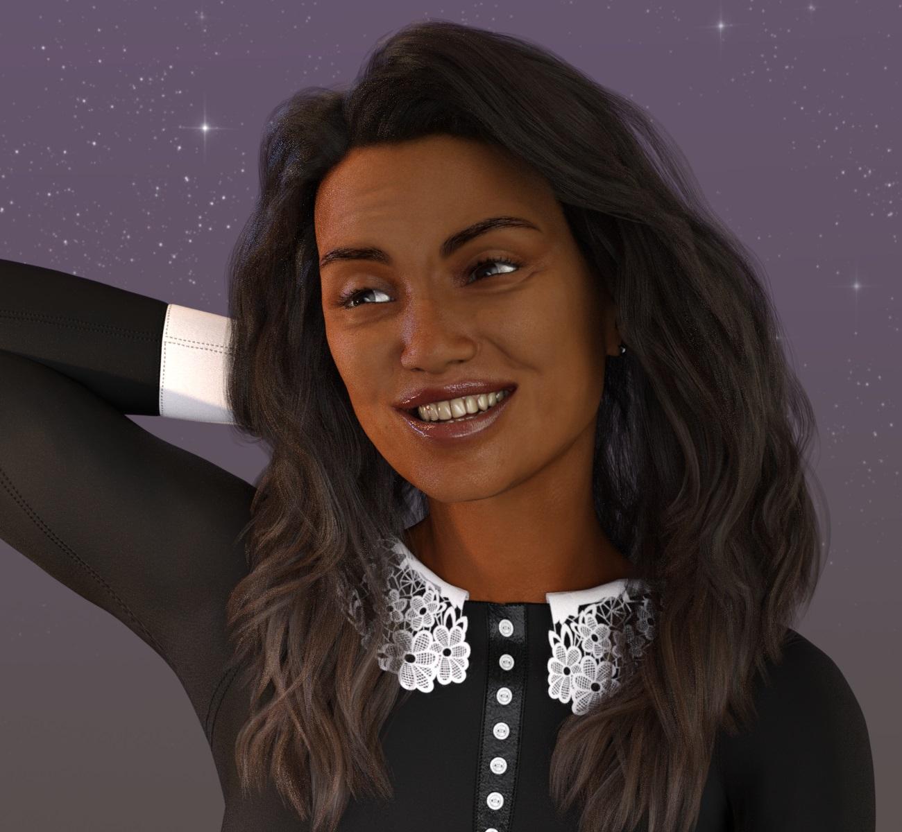

  • ArtiniArtini Posts: 10,904
    edited July 2019
    1300 x 1000 - 217K
    Post edited by Artini on

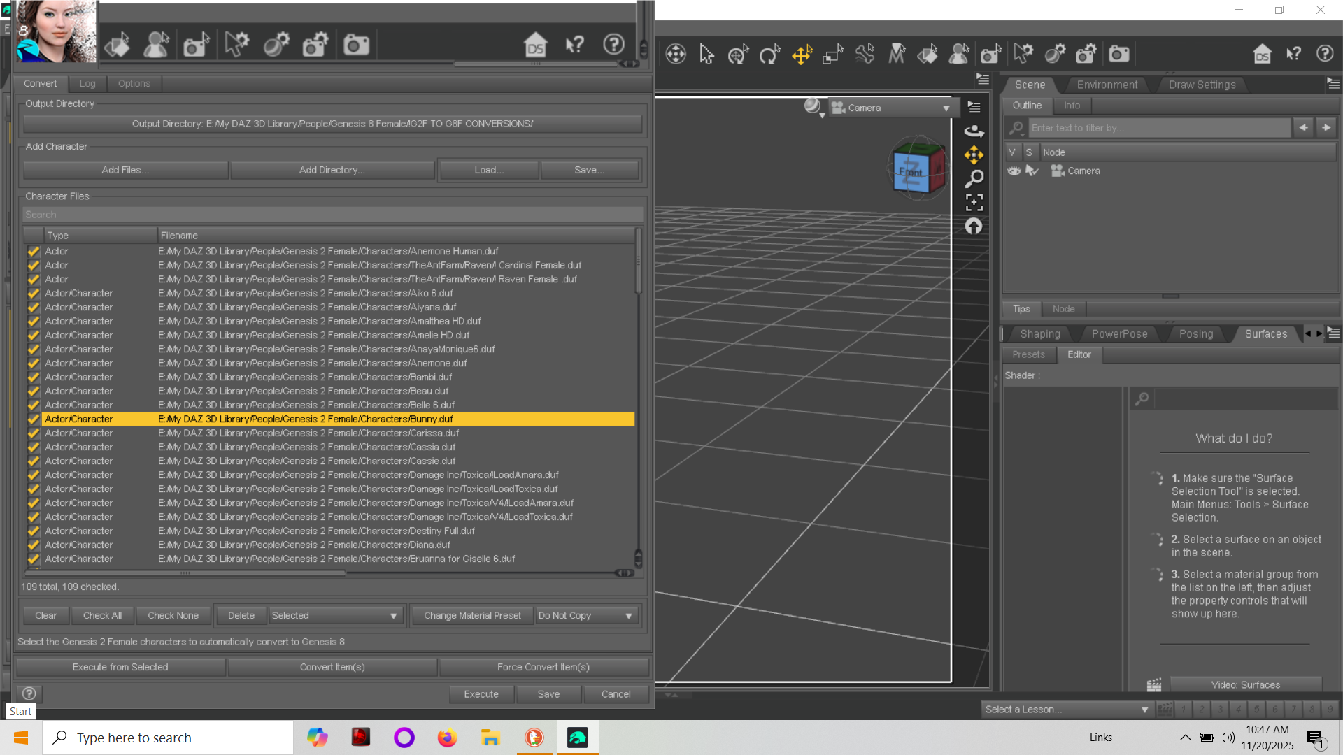

  • I can get this converter to work with the G3 to G8 scene method but the batch convert option does not work for me at all.  It says no character files selected even though there are. Any ideas or hints would be appreciated ???
    Getting the same error.. Trying now the scene method
    I am having the same thing

    I keep getting the error "failed to save morph asset" - is there anything specific I should -not- include in the character preset as far as morphs go? She's based off Victoria 7 and doesn't have any geografts or anything. The only oddity is that I do have a couple custom-created x-tools morphs that I use for her (isolated Ophelia 7's legs and Georgia's mouth).
    *edit* Even forcing the conversion fails. :(
    Strange.  Can you post the full Daz log (not the abbreviated one in the script dialog)?  Have you tried using the other convert custom scene character script?
    Not sure if this helps? -
    2019-07-30 18:13:29.493 WARNING: ..\..\..\..\..\src\sdksource\fileoutput\dzassetoutfile.cpp(611): Failed to create file path.
    2019-07-30 18:13:29.493 WARNING: ..\..\..\..\..\src\pluginsource\DzAssetIOFilters\dzmorphsupportassetfilter.cpp(935): Failed to write Morph Asset(s).
    2019-07-30 18:13:47.346 Failed to save Morph Asset(s). See the log for more details.
    2019-07-30 18:13:47.353 DEBUG: Error: Operation failed
    2019-07-30 18:13:47.354 DEBUG: Error saving morphs
    I haven't tried the scene character script yet. I did try removing the x-tools morphs and those don't appear to be the problem (which is good because most of my characters use stuff tweaked from x-tools).
    *edit* The scene character script does appear to work, though I'm not entirely sure how to save that off as a character preset. Or do I just save that as a new shaping preset and then I'm good to go?
    *edit #2* The converter finished and the base shape seems pretty close, albeit with some tweaks needed (pretty much the lips need the most tweaking). However the eyes seem off. The area around them is fine...but the eyeballs are weird. Like distorted? I guess? Like the pupils don't sit right in the eyeball or something. And trying base G8 eye set after eye set doesn't seem to help fix the oddness about them. There are wierd reflections, etc that I've never seen when using the same G8 eye textures on out-of-the-box G8 characters. I've attached a couple screenshots. Left is my dial-spun G3 character and right is the conversion before tweaking. I knew the G3 eye textures would need to be replaced, so the conversion is using a G8 texture from Muosso. The smooth shaded screenshot really shows the distorted eyeballs.
    It is saying "Failed to create file path".  I need to see some of the log from BEFORE that message.

    The eyes are probably a tolerance issue.  Try again with tolerance around 0.02.  (to be faster, it is better that you delete the morphs from My Library (or whatever is your first content directory)/data/DAZ 3D/Genesis 8/Female/Morphs/VENDOR NAME/PRODUCT NAME.
    You should be moving the tolerance TOWARDS zero, i.e., from 0.06 to 0.02.  It looks like she has HD morphs so you are not going to get a perfect copy.

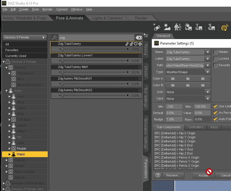

    If you clicked the "Currently Used" in the Parameters Pane, are there body morphs that are not equal to 0?

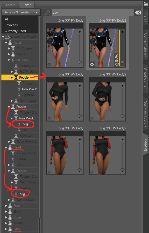

    This is NOT a limitation of the product.  That is very strange that it is not working for you.  What is the Scene Identification of the character when you load it?  It should look like this
    719 x 307 - 67K
