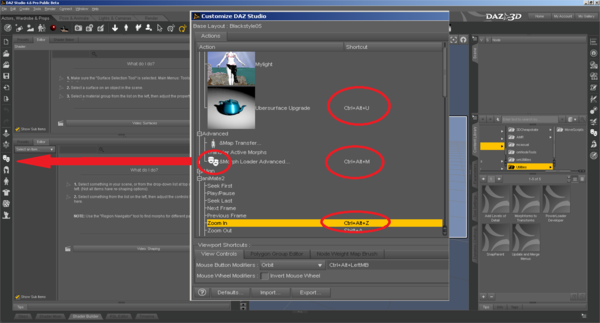

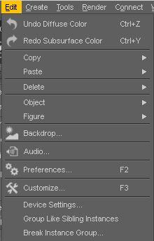

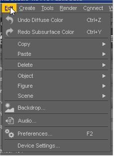

    I downloaded the latest beta and looking in the zip file I saw there were some interesting scripts, especially the "Update and merge Menus"
    But it seems it doesn't do the job completely well : after executing it, as some items are missing in the Edit menu. Screenshots before and after script below
    [Edit] : found the missing items. In fact everything was moved elsewhere

  • Richard HaseltineRichard Haseltine Posts: 111,893
    The Update and merge script doesn't keep entries that already occur elsewhere in the menu tree, which is a pain. The good news is that - if I understood Rob correctly - commands are now logged so that DS can tell whether they are part of a layout and can be updated or user-additions which should be left in place, so you shouldn't need to run the script again to accommodate future updates.

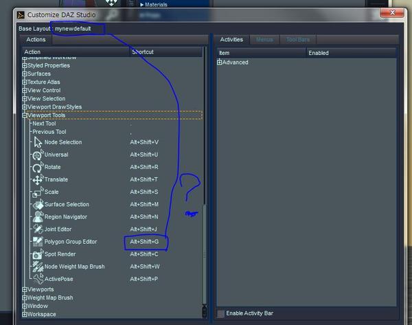

  • kitakoredazkitakoredaz Posts: 3,526
    edited December 2013
    Hi,,Takeo,
    you can really change short cut of some action?
    I can change layout. but I say I can not save the customized short cut.
    yes I apply and accept everytime, then save it as layout too.
    and I understand, ds try to save the files that you mentioned location.
    then next open ds again, short cut turn to default.
    not customized one.

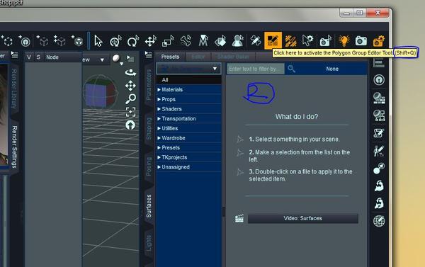

    see my pic, (of course, I use customized layout, as usuall. but when I change short cut about each action,
    these action seems not saved, then if I export action.dsx as you mentioned, the user directory,
    actually the file are edited. but when I save the layout,(F4) and select the layout,
    the customized layout have gone
    957 x 704 - 106K
    Post edited by kitakoredaz on

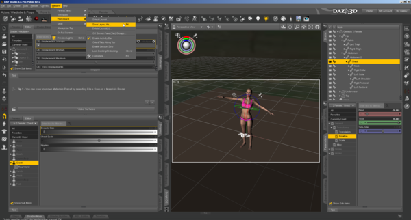

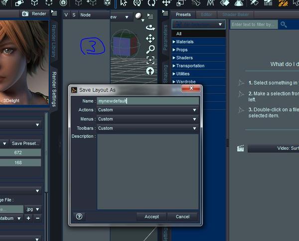

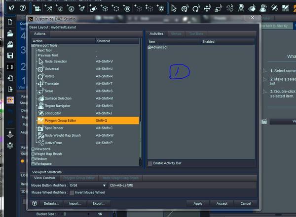

    after edit my Action short cut, I appy and accept. then now poligon group editor short cut have changed. pic2
    to confirm, I save it as new layout as mynewdefault. pic3
    but next open ds, poligon group editor short cut change to default. actually my edited short cut can not work.
    and if I check customize menu again, the short cut turn default too. pic4
    (And I lalready tred to launch DS as Admin by right click many times too,, ^^;)

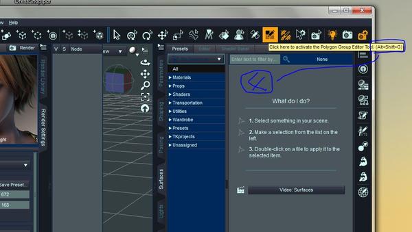

    Then I try to load my saved layout again, but it can not work.. pic5
    I think, Action.dsx ( if you check action.dsx, you can edit short cut manually about the Action)
    which saved in user directory seems not load or apply correctly, when I select the layout.
    then I try export or import action too, but it only work at that time.
    next open ds, it never work, everytime I may need to load action.dsx in customized menu.
    and it cause another trouble too.
    (eg my short cut seems mix up with editted and default , it have double short cut,,some times)
    795 x 627 - 60K
    971 x 549 - 85K
    746 x 602 - 70K
    879 x 552 - 75K
    WAAAAAAAAAAAAAAAAAAAAAAAAAAA
    it seems DS can not save, just about I have tried to change short cut so many times ^^;;
    because I can change or edit short cut, about file menu or Animate 2 short cut,,
    but it can not save about view port tool,
    poligon group editor, or weight map brush etc WHY???????????????
    (Takeo pleaaaase test about view port tools short cut ^^;;; if you have time,,)
  • Takeo.KenseiTakeo.Kensei Posts: 1,303
    It seems it doesn't work for all actions : I can change the Polygon Group Editor Icon but NOT the shortcut.
    You should fill a bug report

  • rbtwhizrbtwhiz Posts: 2,485
    The Update and Merge Menus script first records any menu customizations*. Then it clears the menus and loads the new defaults. Then, it iterates over the recorded customizations and weaves those entries back into the new defaults. While weaving those entries back in, if a menu item that was recorded as being "custom" already exists in a given menu as a result of loading the new defaults, the customization of that item is discarded - if it wasn't done this way you would end up with duplicate items. This basically means that while the ordering of customizations should be preserved, the default ordering of items in a given menu override that of customizations.
    *The script can only do this if it can discern which menu items are "custom" an which are not. Prior to build 4.6.0.83, the application simply did not keep track. A menu item either existed, or it didn't. In 4.6.0.83, I added support for keeping track - so that I could write a script that would "Update and Merge Menus" for users that have customizations they want to keep, but also want the improvements to the defaults. This support consisted of a few changes. One of the changes was to record whether a menu item is "custom" in the menu configuration file for the session - which saves each time you accept the Customize dialog, apply a layout and/or successfully close the application. This file is one that causes the interface to load in the same state you last used it.
    Because the session menu file already existed for anyone who had run the application and because there was no concept of whether a menu item was "default" or not when it was constructed, an initial state had to be assumed. Either everything was "custom", or everything was "default." Assuming everything was initially custom defeats the point of the script... so it had to be assumed that any entry that wasn't explicitly marked as being non-default was in fact "default", and could therefore be ignored in the recording phase of the script. Unfortunately, this meant that any customizations that are not "Custom Actions" (which are always "custom" - by definition) are lost when the script is run on customizations created in builds prior to 4.6.0.83.
    There are a couple of ways to "fix" this...
    1) Re-apply your saved layout to restore your old menus... (you did remember to save your layout, correct?). Then, manually edit the session menus.dsx in "%appdata%/DAZ 3D/Studio4" (or "%appdata%/DAZ 3D/Studio4 Public Build") to add the Default="false" attribute to each element that you want to keep where they are currently. Don't bother editing the "Action" child elements of the "CurrentActionList" element, it will not have the effect you want. Keep your editing to the MainMenu, PaneMenus, PersistentMenus and ViewToolMenus children.
    OR
    2) After running the script once (which will replace the menus with the defaults), use the Customize dialog (F3) to edit the menus to the configuration you want.
    The shortcut bug was fixed in the Dev channel this past Friday. The general public will not see that fix until build 4.6.2.75 (or later) makes its way to either the Public Build channel, or the Production channel. Before that happens, the fix still needs to be verified in the Private Build channel, which is currently testing 4.6.2.72. The Public Build channel is slated to get the 4.6.2.72 build next, so you won't likely see the fix until the update after next.
    -Rob

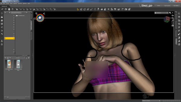

  • BobvanBobvan Posts: 2,653
    More V4 woes besides the expression morphs getting lost when reloading some saved scenes, the shoulder fix gizmo I purchased from rendo will now also fail to load needing to be re applied.
    1920 x 1080 - 202K
  • JaderailJaderail Posts: 0
    You do realize that if you are using a SAVED figure that figure does not have the NEW morphs injected. Only a Fresh figure will have NEW morphs injected at load. I ran into this several times in the past. Saved Character files only have the morphs injected at the time of save and will not list new morphs. Only a fresh load of the Figure loads the NEW morphs into the figure.
    They used to save with them previous to this version
    I think you misunderstood me. What I'm saying is...
    If you loaded a saved figure for this image you needed to start with a fresh figure so all the morphs including the NEW ones were loaded. Saved figures only have channels for the morphs they were saved with injected in them. A fresh figure would have all the morphs injected you added and Should save all those at save including any new ones you injected as it should have open channels to hold those new morphs.
  • KeryaKerya Posts: 10,943
    I think Bobvan HAD the morphs injected before saving the scene - and now on loading this scene the morphs are lost.
    edited January 2014
    What she said and there is no reason all expression morphs should be lost breaking my saved scene...I'm sorry but this irritates me to no end...
    If I start a new v4 from DAZ> people inject character inject the fix shoulders add hair blah blah blah save character when I then reload saved character the shoulder morphs are missing...I tried refreshing the BAT files ect ect..
    Post edited by Bobvan on
    Ah, Then it can come down to how some morphs are made I believe. I have read of some 3rd party morphs not saving before. I'm sorry but I have no idea how that is fixed.
    We all know updated DS sometimes break older things it's nothing new
