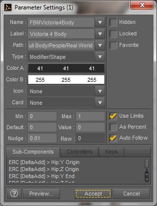

  • Problem solved and easy.........simply click on your Morph in the parameter setting tab under the morph loader to access the properties panel and un-check auto follow....Done  Credit goes to Leana in the below post.  I think this needs to be posted somewhere!

    If you mean to remove the autofollow, you would be modifying the morph you used on the figure. "Autofollow" checked means that shoes or other conforming items will morph automatically to follow the figure's morph.

    Autofollow is not on the shoe. It is on the morph.
    It means that this morph will not be projected onto other objects fitted to the character.
    And you find it by clicking the gear icon on the morph.

    If you just parent the shoe and do not fit it to the character, you do not need to change 'autofollow'. That is only if an object is fitted to the character.
    If you have made a dedicated morph for the feet, you can apply that to the foot. And if it has autofollow off objects fitted to the character will not inherit the morph (as a projected morph).
