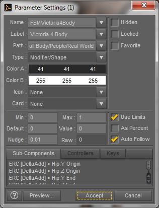

    If you open the parameters of a morph (click on the little gear on the morph slider and select "parameter settings" in the menu) you should see all parameters for the morph, including a checkbox for "auto follow". If turned off then conformers won't auto-adjust to match the morph when it's used.
    If you change it it will be only for the current figure and scene, you'd need to resave the morph itself if you want it permanently turned off.
