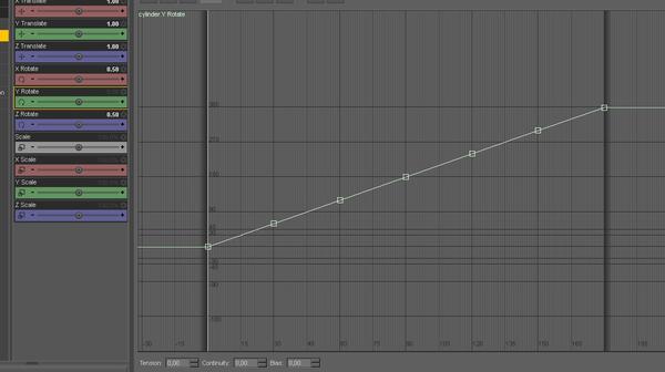

first is graphmate with correct keyframes
second is aniblock Editor from created aniblock
aniblocks are useless if they cant save the correct movement
