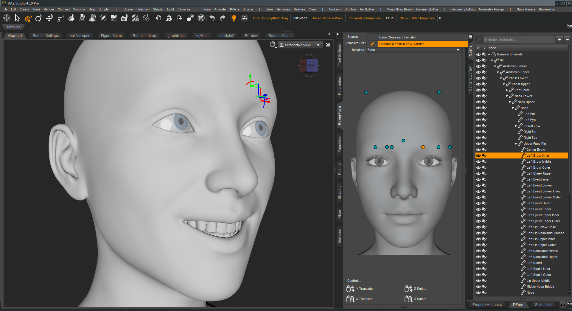

    After creating the folders, copy-pasting and editing the dsx files now I can select an alternative PowerPose Template Set in the dropdown menu on top of the pane. I did the same for Genesis 8 Female so I also get editable templates generated for her.
    See the screenshots of my first tests posted in this thread: Why is there still no official Genesis 3 Powerpose template? (solution)

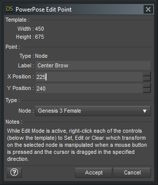

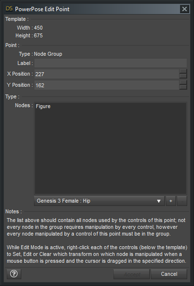

    As saied before my script can only give you a starting point with placing the points, you then have to manualy edit them in the PowerPose pane by the righ-click menu Edit Mode then Edit Point for propper placement.
    I hope my script can still be usfull to create PowerPose templates even for custom figures that are not supported yet. Therfore I tried to make it as universal as possible by ignoring upper/lower case but the bone label has to start with left/right. If the figure rig dosn't follow that naming convention you can use the search() method instead but in theory you can run in this script and the generateTemplate() function with any figure, any bone label and as often as you like to get your templates.
    Once the Node Attributes: Hide in Scene View (see screenshot of Joint Editor Tool Settings) are set off for every face rig bone you can edit those points in the PowerPose pane Edit Mode that offers dialogs to manualy create, manipulate and save templates.

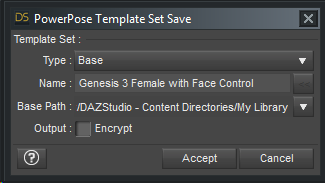

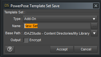

    SaveTemplateFile() function
    In the meanwhile I was writing on the SaveTemplateFile() function its looking like this right now:
    I was able to extract the AssetUri from the figure node like this var sAssetUri = oAssetMgr.getAssetUriForNode( oFigure ); and construct the save path filename string for the template files. I thought normalizePath() would replace the %20 in the AssetUri with spaces but I had to manualy write something that replaces all %20 with spaces.
    Otherwise I already have the path and filenames constructed and I have to check if the path already exists or if I have to create DzContentFolders and all that. Regarding the Error it seems like I don't understand the writeLine() method yet but I will have a look at the API Reference: http://docs.daz3d.com/doku.php/public/software/dazstudio/4/referenceguide/scripting/api_reference/object_index/file_dz
