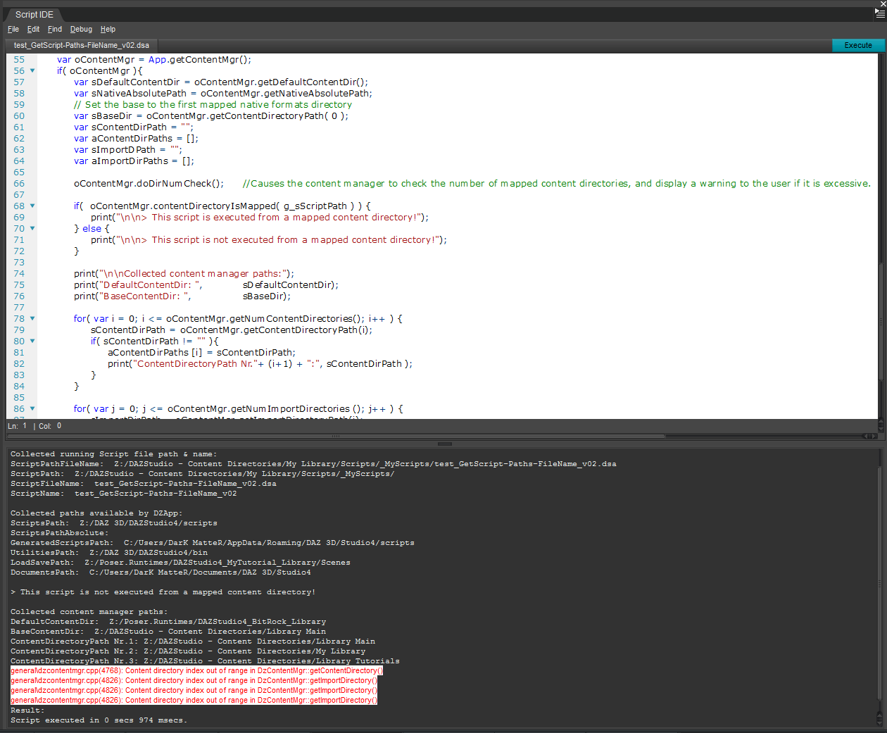

    // Path to this executing Script's .dsa file:var g_sScriptPath = getScriptFileName().left( 1 + getScriptFileName().searchRev( '/' ) );
     Here is my modification / script example. I also found a way to use the DZApp methods to get some other useful paths for possible files save locations by scripts.
    I possibly found another bug somehow App.getAbsoluteScriptPath( g_sScriptName ) dosn't return anything for me.

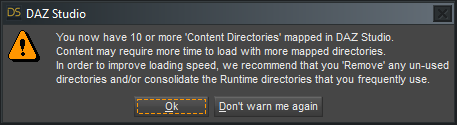

    • Added a check if(  oContentMgr.contentDirectoryIsMapped( g_sScriptPath ) ) I wasn't expecting this result > This script is not executed from a mapped content directory!
    • Added a check oContentMgr.doDirNumCheck(); this is giving me a warning that I have to many (>10) Content Directories mapped that can slow down content loading
    Errors:
    • general\dzcontentmgr.cpp(4768): Content directory index out of range in DzContentMgr::getContentDirectory()
    • general\dzcontentmgr.cpp(4826): Content directory index out of range in DzContentMgr::getImportDirectory()
    • Script IDE print > This script is not executed from a mapped content directory!
    I don't understand why my for loop runs further than it should even while the end condition getNumContentDirectories() seems to return the right number.
    see line 90: for( var i = 0; i <= oContentMgr.getNumContentDirectories(); i++ )
