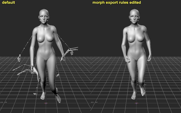

I export what the first image shows/the shaded image. I import leeda leeda leeda lee (The 2nd Image).
Again I use the same settings that give me the proper results sometimes. This one though wishes to lean forward keep the arms in the default pose and sorta jogs. Being very Jerry Seinfield. I have imported this in many other 3D applications and the same result persist. I tried selecting all bones, I checked if any were locked, changed it from 3030 to 2012, and other versions of FBX etc. I cannot figure out what the issue could be. Does anyone have a clue?

    You need to edit the morph export rules .
    Set to it ignore the entries such as "LShldrBend.XRotate2" ,  YRotate2, ZRotate2 , etc...
    There is a list of movements that should not be exported as morphs , since they already  are reflected in the bone rotations
    You can use wild cards; it will look something like this
    lThigh Ignore
    rThigh Ignore
    lShldr Ignore
    rShldr Ignore
    LForearm Ignore
    rForearm Ignore

    So you say it morphs faults in this Pedro? I could disable them entirely in this case. If it is that it would be interesting. I swore in my test run I kept them on and it was fine. Weird. Will poke this in a bit. I must say Blenders results were terrifying unexpected as well.
    I'm saying it's those specific morphs' fault . I suspect there are supposed to be JCM's, but they don't export correctly from DS (You don't get JCM's in FBX from DS, nor do you get HD or correct subd in other programs when using FBX ) . But it works to correct the issues you describe and in your screenshot for other programs. If you search, it's been discussed before in other threads
    You don't need to disable exporting morphs completely. You can keep the other ones like character morphs etc... if you need any parameters animated (otherwise they can be baked).  It's usually only those specific ones with bones in their name. In other programs, the movements get doubled or tripled up because of the morph. It's expressed in the joint/bone rotation, then again as a morph - hence the distortions. In your earlier screenshot with C4D, you could also disable those specific ones in the pose morph tag, and you'd see it works too. But it's "smarter" to not even export them (since they don't work like they are supposed to anyways), to keep the filesize down
    In the other tests, if those specific movements were not used in the movements - they would not be activated as "animating" the in the FBX export options automatically, thus you would not be affected in those other tests

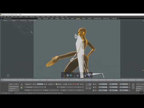

    I don't use UE4, but that's 99.99% the direct cause in C4D, Autodesk programs .  I saw your taken down screenshot and you mentioned C4D , and your video shows C4D and motionbuilder . (Blender is hopeless for DS exported FBX, so cross that off the list; use the DS import plugin instead) . Looking at the end of your video, I'm 99.99% sure it's the cause . Twirl down the FBX export settings and double check the list

    Make that 99.999% certain it's the cause for C4D , Autodesk  .
    Compare this to the ~6min mark in your video . Look familiar ?
