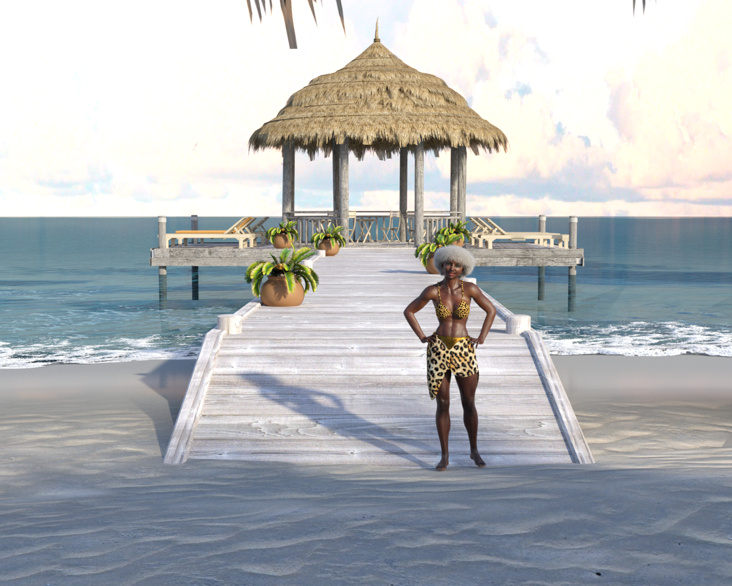

Hello all
I recently purchased item #22811, which is the Summer Island.  Overall this is a great pack and I am very happy with it, however the sky doesn't look anywhere near like the photos for the product do.  It looks very white like and washed out.  Please see attached:
It looks awful, like it is overexposed.  Is there any way to fix this?
I am on Iray, BTW
Thank you,
Geo

  • Richard HaseltineRichard Haseltine Posts: 111,875
    I think it probably has only 3Delight materials, and the sky background may well be set with ambient strength non-zero so that the conversion to Iray makes it glow. You probably want to remove the sky for Iray.

    According to the product page for Polish's Summer Island, it is Iray enabled / optimized. I think we'd need to see your Render Settings -> Environment tab to see what's going on. I suspect one of the values for the environment map is turned up too high.
    Edit to add, the product page also says this:
     For this scene, To get better render result, it's recommended to use Sun and Sky environment mode in render setting.

    Although its optimised for Iray it doesn't have Iray shaders used for most surfaces.
    The sky is a background prop not a HDRI

    I thought it was a prop :) Click on the image for the diffuse, go to edit image and change the gamma to either zero or 2.2 and see if that helps.

    Actually this is a newer pack and it is for Iray,  and it recommends to use the Sun and Sky setting only, which I am using.   The sky isn't a dome but a curved panorama that is in four sections, I guess they did this so you can remove a section to place a camera for a long shot.  The top part is totally open and allows the default enviroment controls skydome to be used.

    I used the default settings and yes, I had it set to Sun and Sky.  Pretty much when I do any outdoor setting I set it to this anyway.

    That is interesting.  Why would they claim it is for Iray if it isn't using Iray shaders?   Yes, the sky is a panoramic backdrop that encircles the ocean area.  Even though the sky in the sample shots for the product isn't really the greatest looking sky, it still looks better in the sample shots than what I have.  The tone mapping is set to 13.  I tried to go higher to decrease the exposure, but then I start to loose that nice brightness you have from a sand enviroment.   As it is (at the default of 13), the set is perfect.  Even the water looks great on this one with the waves breaking and rolling into the beach.  This has quickly become my favorite beach setting because of the shoreline alone.  But that sky...it looks white and not blue and the clouds are washed out at best.   I have not tried the dusk settings yet as you can do a sunset, but I am sure that is going to make everything dimmer, which is not good for the scene I am trying to create.

    Is this set is for 3delight. & if so you will need to make it iray compatible & properly best to remove the 3dl skydome and add a iray HDRi skydome instead  or convert  the 3dl one to iray (Instructions in another thread https://www.daz3d.com/forums/discussion/325991/poser-skydomes-would-these-work-in-daz-4-10#latest)  other wise you will get bupkis for light using 3dl sets in iray .  older 3dl sets need to be convert to iray and reworked . If its a iray set you may need to make some adjustments to your lumen & light source settings

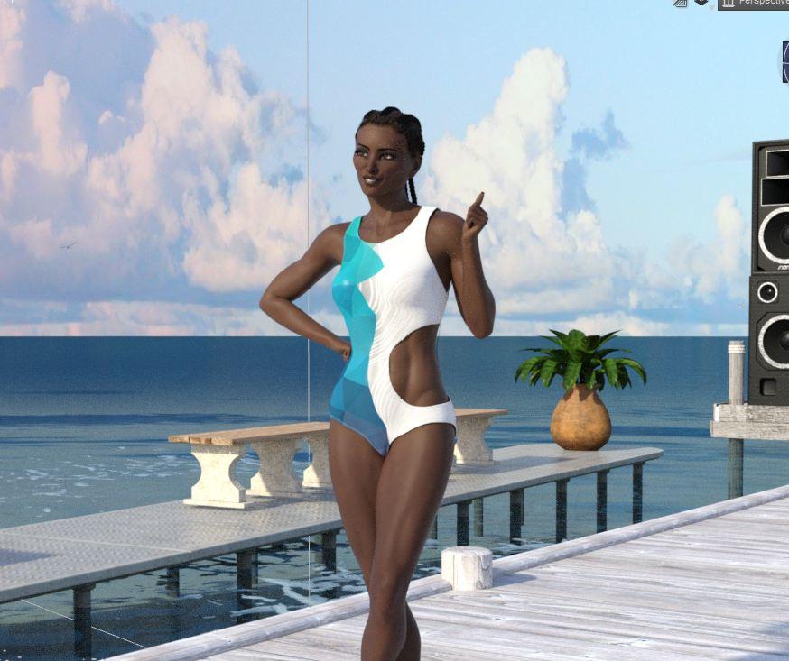

    I played around with the Gamma setting in Tone Mapping, however, it affects the whole scene.  What I needed is something to affect just that piece of sky.  As I mentioned above, the sky was the only thing I am having an issue with, the rest of the render looks fine.
    So I decided to play around with a few things myself since if I messed something up, I had four sky panes to work with and I could go easily back to the other settings.  When I went into the surface settings, the thing that stuck out the most to me was the base color.  It was set to white and looking at the image...well, it was white.  So I played around with the settings to give it more of a sky blue look.  I eventually settled on  0.0006, 0.45, and 0.65 for the three color settings.   Bam!  This did it!  Not only did it give me a better looking sky color, but also the clouds were not over exposed anymore and they look...well, like clouds now!
    I mean I just was arbitrarily playing around with the settings and ended up fixing it that way.  LOL!
