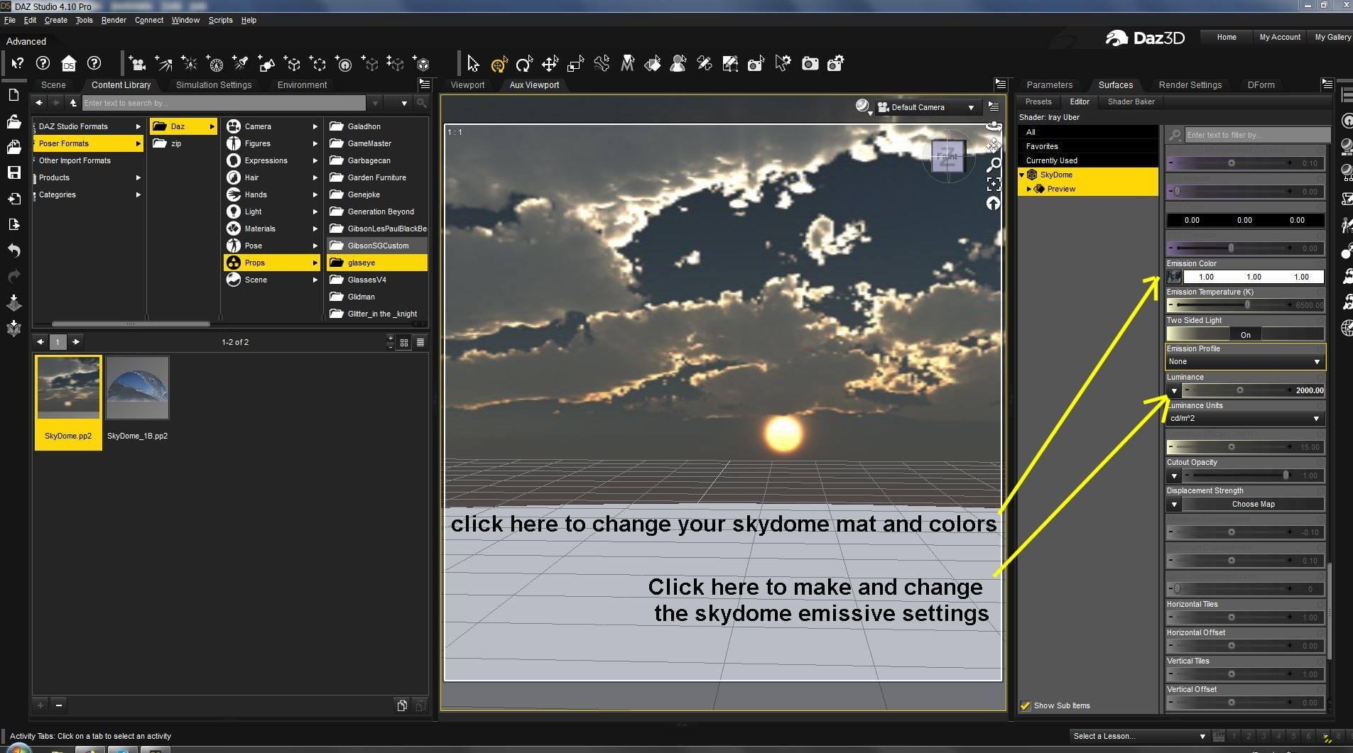

    its easier to make the sky dome emissive (see capture) and keep the emissive low and add distant and spots lights as needed.  I only use points of lights for stuff like candles and light bulbs in a lamp other wise emissive light panes work much better
    Step 1 load your sky done and  under the display settings found under perimeters tab click cast shadows off
    Step2 convert dome to to SubD by going to edit>Object.geometry> convert to SubD. This will get rid of any geometry's mesh lines that may show up during iray rendering
    Step3 convert to Uber-default iray shader to make it iray compatible. . this will turn the skydome black. (don''t worry we will get to show again in the next step)
    Step 4 click your skydome and then open the surface settings and scroll down to "emissive color" setting (see capture ) and click it to add your skydome mat and then change the default color from black to white . you will see the skydome  appear again.
    Step 5 scroll down a few more setting bars until you see "luminance" settings &  under the surface tab  Adjust the luminance settings. Make sure to use as low as possible lumens as you can as to not wash out the skydome texture I would start around 2500 lumens or less  and go up from there. . this will give off a warm low light to the dome but it will not be enough to light the scene your building , then you can add spotlights and emissive light panes and panels as need for light source. if you have good indoor HDRi light presets you may try some of those as well
    pretty easy actually .. good luck :)

    Thank you for the info.   Sorry I am late, but sadly there were a few messages I just simply forgot about.  Now with "this stay at home" Covid thing, I have been looking at my older messages that I left here.   I did try this out and it worked out well, although in addition to the skydome, I needed a ground, and also a light source to simulate the sun.   It just proves to be too much extra work, whereas using an HDRI sky is much simpler.   Still this is a great idea to put some life into a specific sky.
