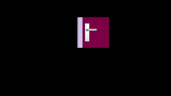

dholmdholm Posts: 115
I would like the door knob to be nice and shinny. the color is set to 192,192,192 Diffuse strength 100%, reflection strength 100% and lighting model is metallic. Can someone tell me what else I need to change or unchange? I'm not sure I like the color of the door. Love the wall color any colors I should try?

  • dholmdholm Posts: 115
    So I need to turn that down. I only want it to look new and steel like. No time right now I just got a big to do list.

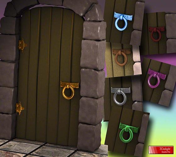

  • TjebTjeb Posts: 507
    edited November 2013
    Have you played with Glossiness?
    Maybe it's time to start using shaders.
    In this render every change was just a click.of the mouse.
    door: facuhead
    Glossiness set at 0%, 50% and 100% no change. reflection set back to 0 no change. Never tried or know anything about shaders. I do love your door knockers. Are shaders hard to learn? Can I do the door knockers in the above render with just DAZ Studio. Never tried or learned post work.

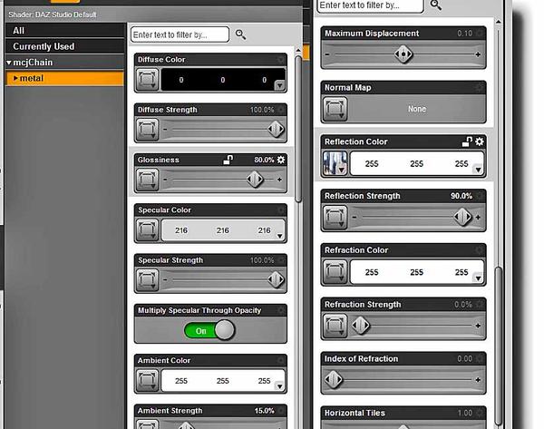

    The left chain is with your settings. The right chain is with a chrome shader.
    You could try the settings yourself:
    You see that, surprisingly the diffuse is 0,0,0
    Don't forget a simple image in the Reflection Color channel.
    For a shader, you could try this (free) one:
    http://www.sharecg.com/v/27568/browse/7/Material-and-Shader/Ultimate-Shader-Pack-for-DAZ-Studio-UPDATED_2011
    Works great for me.

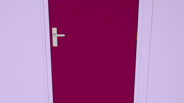

    Thank you one and all. The door knob comes in many parts but with the shader I was able to make my door knob and faceplate nice and shinny. Also all of my work will now look nicer.
