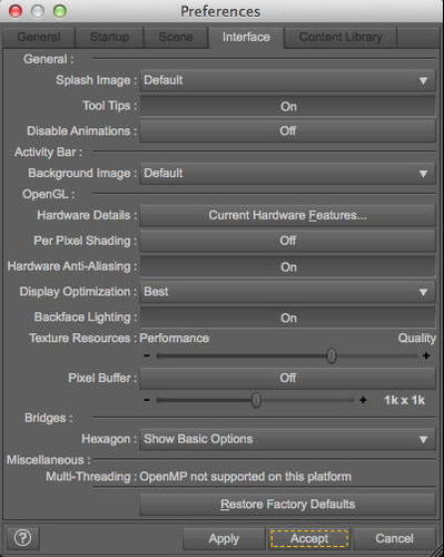

    Have you set the display optimizations under preferences?

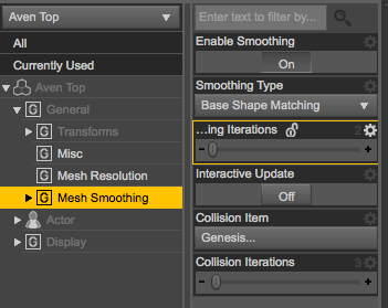

    A second thing to look at is that some content (clothes) have the Interactive Updates "on" in Smoothing settings which will cause DS to be extremely sluggish. See pictures for both settings.

  • deeahr2169deeahr2169 Posts: 497
    The first thing to say is that prior to the info regarding display optimisation i had performed a clean install of Mountain Lion, and am now running DS4.6 on that platform. The sluggish behaviour remained. I was going to try DS4.5 when i returned but i found your message and I checked the display Opt. and found that it was not set to best. So i changed it to best and there was a distinct improvement. The big question i suppose is do i know install Mavericks, i suppose i will have to eventually so best bite the bullet before too long, But first i have loads to do having spent almost my entire life this past day or so playing around and generally messing things up with Daz.
