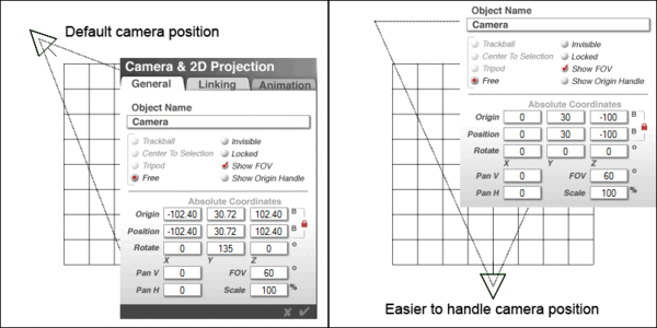

  • HoroHoro Posts: 11,740
    @goofygrmom3 - X/Y/Z coordinates are sometimes rather difficult to get right. This is because of how the camera is rotated. If you put it "south" looking "north" with all rotation angles at 0, X goes left/right, Y up/down and Z near/far. It is much easier to position anything in the scene if you have the camera this way. Though this is a question of personal preference.
